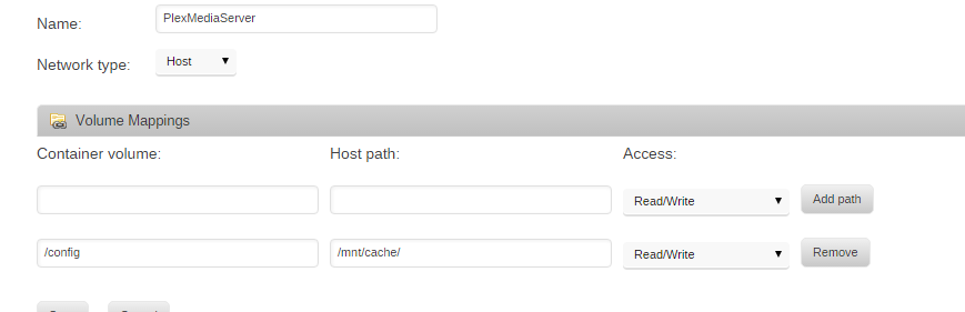

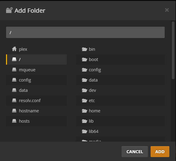

Hello I am having an issue with the official Limetech plex media server, It installed perfect and runs ok and i am logged into the server and online the problem is when i try to add content i can see what appears to be my shared folders but when i click on the MNT folder none of my drives or shares show.
I am running the latest 6.1.6 , with Plex server 9.14.6 , I have attached a screen shot showing the issue!
any ideas on what i am doing wrong?  - it appears that the server browse is only pointing inside the CACHE drive?
thanks AJ
@ajgoyt, what drives mappings do you have for the Docker?
Hi I believe this is where my issue is see the screen shot...
