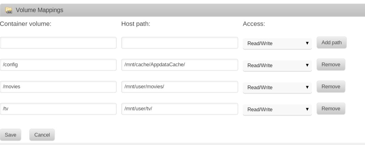

hi all,
i have limetech's plex docker version 0.9.15.2 installed (a recent update to plex docker).  all of my media libraries were missing when i restarted plex.  had to re-add them.  also, had to re-add same libraries to all friends with whom i share Plex media.  anyone seeing this same problem?  a google search for "plex 0.9.15.2"  turned up a few recent posts on plex msg board where others report same problem.  (i have re-added all libraries so i am good.)  thanks.
hi all,
Post your volume mappings for this docker.
see JPG (first time posting attachment, i think it worked).  thanks.

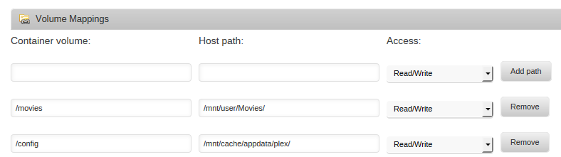

Total Plex newbie here, I've never used it in any capacity what-so-ever. I installed the Limetech Plex Media Server docker on unRaid 6.1.6.
I think the install went OK, the directory structure for all of the config files was automatically made. Using the official Plex app for Android my 'tower' shows up as a media server, but it tells me there is no media available.
Do I need to install some other plugin besides the Plex Media Server on unRaid? Does the attached screenshot show the correct configuration and is there anything else to configure?
Have you added your movies or tv shows from within plex ui
There is nothing more you need to install on unRAID but you need to configure Plex so it finds your media files.
Since you have the Host Path: set to /mnt/user/Movies/ I guess that this is where your movies are.
That folder is mapped to /movies and that is what the Plex app inside the container can see so you need to setup Plex and Add Library, select Movies and Add folders and browse for media folder and select Movies.
You can find the Plex Web page on same IP as your serve on port 32400 (like this http://192.168.1.101:32400)

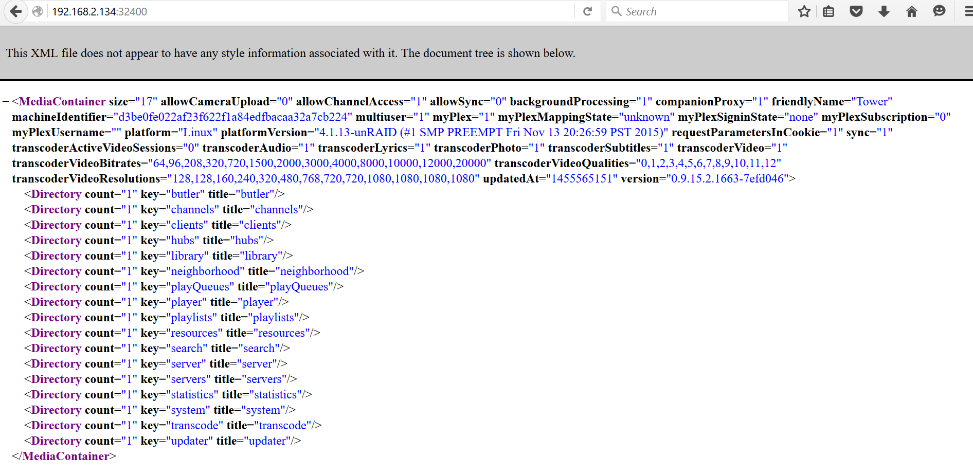

I went to the address you suggested, but clearly the page didn't load. Please see attached screenshot... any ideas?
EDIT: I figured it out, the address is actually https://192.168.1.101:32400/web
