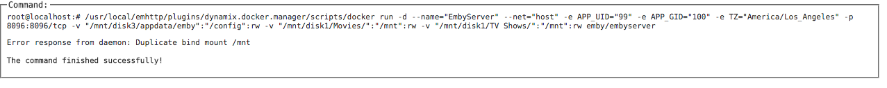

Here's the screen shot after installing Emby
The reason why Emby isn't working is because you've passed Movies and TV Shows both mapped to /mnt  (6.1.9 has a nasty habit of sometimes saying the command finished successfully when it didn't according to the line above it)

Not if it's worked.  Wouldn't advise it as sometimes different container versions map the appdata slightly differently, so it's good to see the "lie of the land" before you copy across so you can confirm the folder structure is the same.
Yea, not what I would normally do, but I was rushing through it and made a mistake copying in the same config path.  Good thing it didn't come back to bite me.  Thanks.
