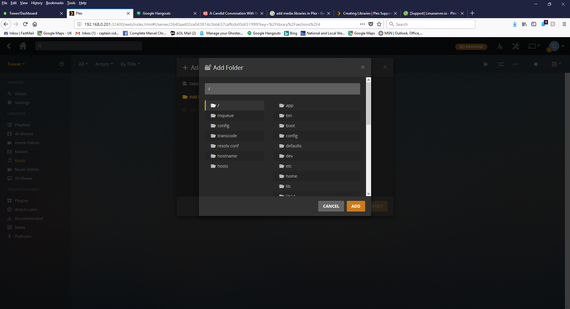

I had the linuxserver Plex running fine on my unRAID server and then I decided to swap out my cache drive for a larger one.  I lost Plex in the process because the appdata folder was on the old cache drive.  It tried reinstalling Plex, but I mistakenly installed the limetech PlexMediaServer version.  I tried adding libraries using the web GUI with no luck.  When I browsed for folders it displayed what you see in the attached image.  I can't see any of the media files on my server.  How do I get to the shares on my server?
You should have used Community Applications Previous Apps feature to reinstall your docker as it was originally. You will have to figure out what you did before. Most likely you don't have any volumes mapped to your media.
I checked the Previously Installed Apps and it says No Matching Content Found.  How would I map volumes to my media?  I haven't changed anything in my setup that I'm aware of since I first installed Plex.  I don't recall having any problems setting Plex up before.
I installed the latest linuxserver Plex and disabled the limetech PlexMediaServer so they're both installed, but only the linuxserver Plex is running.  I have the same issues with both versions of Plex.

2 minutes ago, trurl said:
If you don't know that you don't know how to use dockers.
Here is the FAQ:
https://lime-technology.com/forums/topic/57181-real-docker-faq/
It's been quite some time since I set it up so I've forgotten a lot of things since then.  After looking at the FAQ it jogged my memory about some of the things I did before to get it working.  Thanks for pushing me in the right direction.
Unless you also set up a new flash drive at the same time as the cache drive, this is unlikely.  Unless your flash drive is removed or dropped offline.  Maybe at your convenience go back to Previous Apps, and then post your diagnostics.
I reinstalled the linuxserver Plex docker and finally got the volumes mapped correctly.  The Plex webGUI couldn't find the shares in unRAID because I was entering the wrong paths in the entry fields.  It's currently in the process of rebuilding the libraries.  The flash drive is the same one that's been plugged into my server going on about ten years now.  I don't know why it didn't show up under the previously installed apps, but there was nothing there.  Plex is the only docker I have installed.
