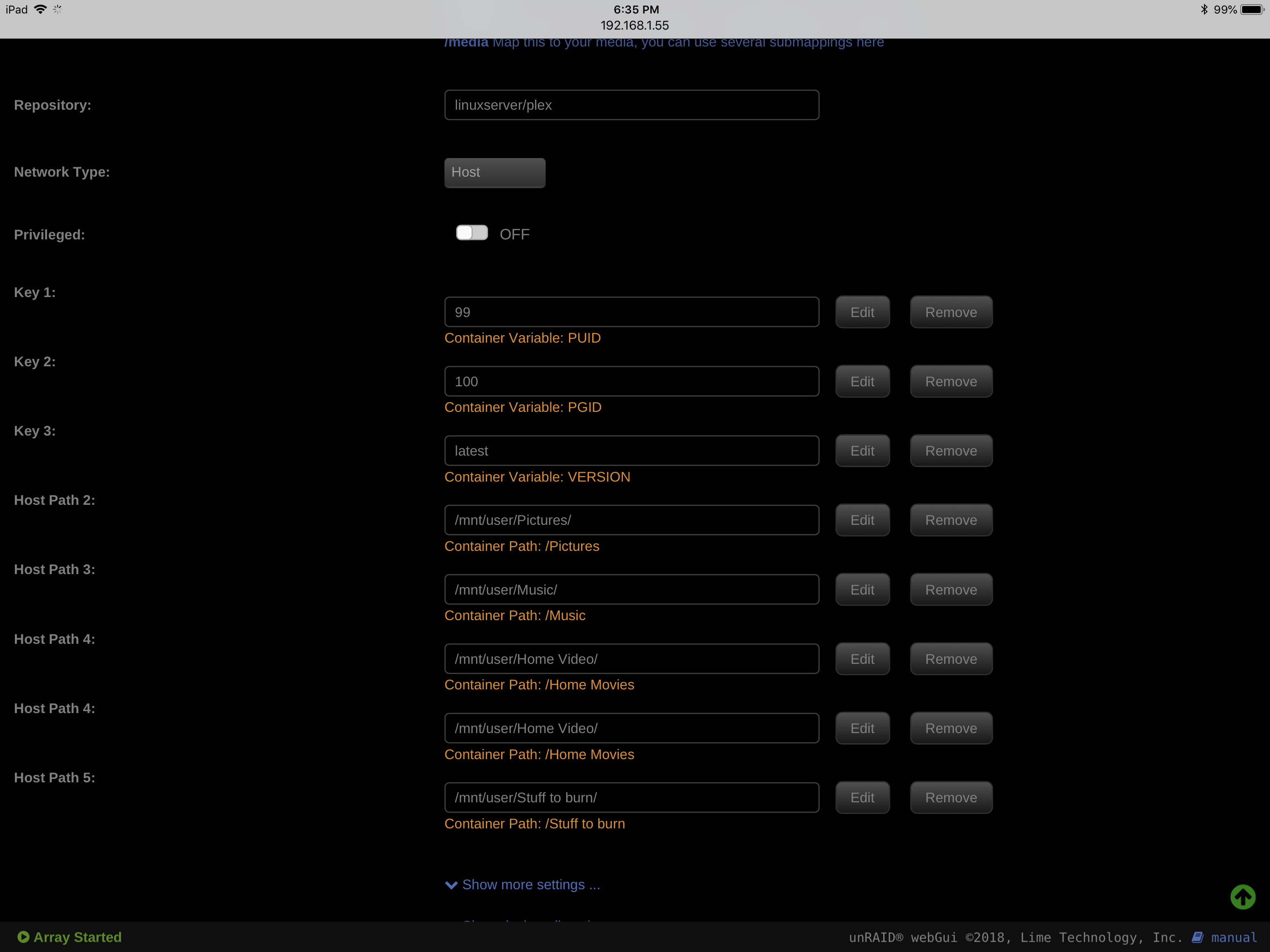

hi all, I have been using Plex docker linuxserverio for a few months, working well.  previously, was on needo but moved over
in last month or so, I have been having a problem where the servers (i have two) are not found.  Plex apps on iphone/ipad/appletv/web for example are constantly saying 'offline'
weirdest thing is i have tried reinstalling, rebooting, stopping starting, but nothing seems to help.  I do update regularly (linuxserver seems to have a weekly update each saturday morning).  Bizarrely, it seems to work around 5% of the time.  Last night for example i opened the plex app on my phone, and everything was there, and successfully played a file from each server!  but woke up this am, and everthing has been down all day
one other odd thing- this problem started a few weeks ago.  last week, i moved to a new home and am using a different ISP provided router (netgear ac1750).  I was kind of wondering if this problem might be related to my previous linksys router, but the problem is persisting even with the new router!
any pointers to set me in the right direction?  have moved into new home with a great home theater, but can't access any media (first world problems, i know lol)

need to post your config
hi sorry, can you direct to what I should post?

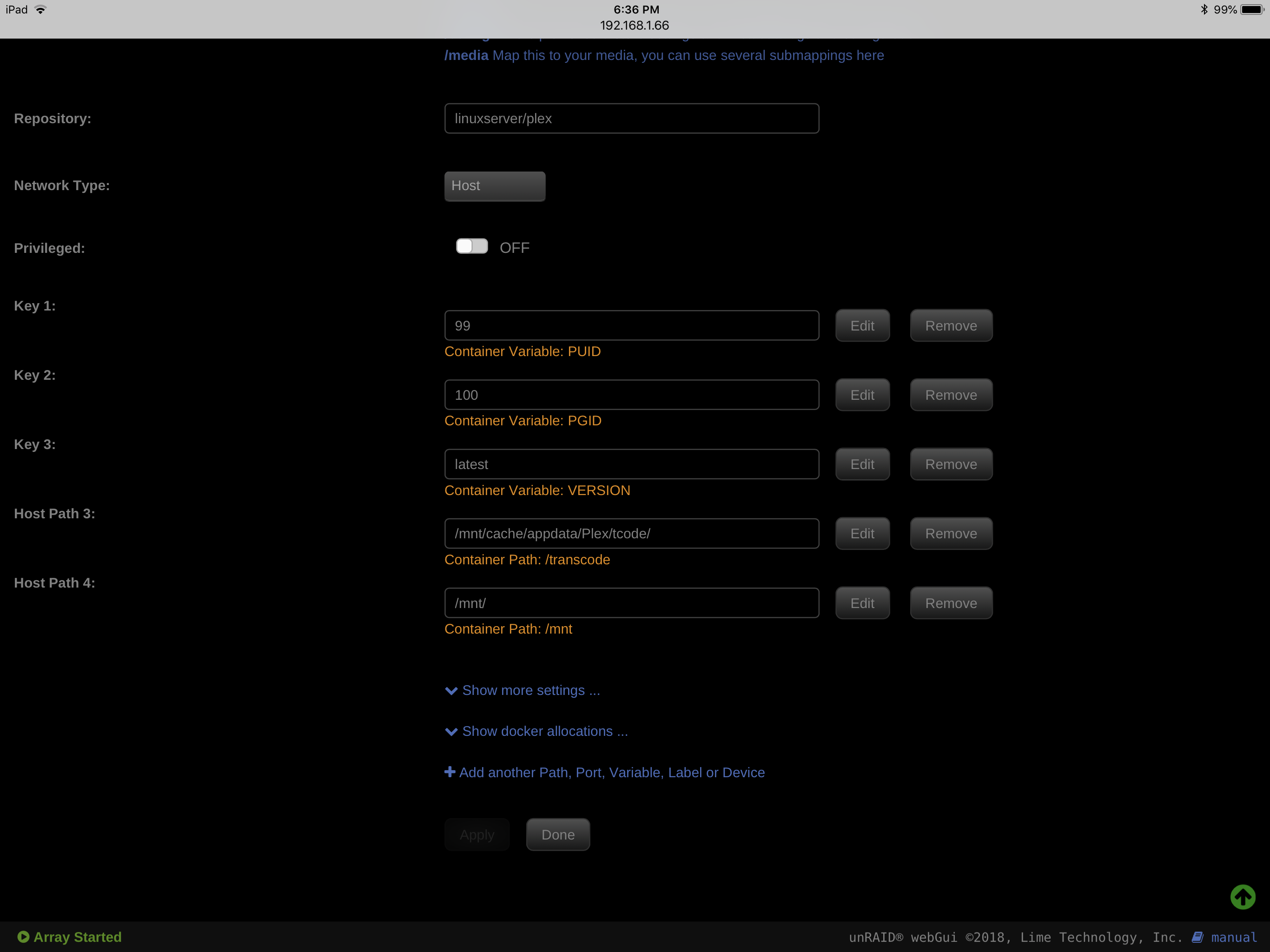

Your template settings for both Plex containers
Sent from my BND-L34 using Tapatalk
They are both running on host mode so essentially they are fighting each other on port 32400, unless you changed them.
Interesting. I have had it this way for three years with no issues. I believe tower is running on 32400 and chimera is running on 32401. Any way i can confirm or try a change?
 I guess one thing to note is even with one server or the other off, i have the same issue
