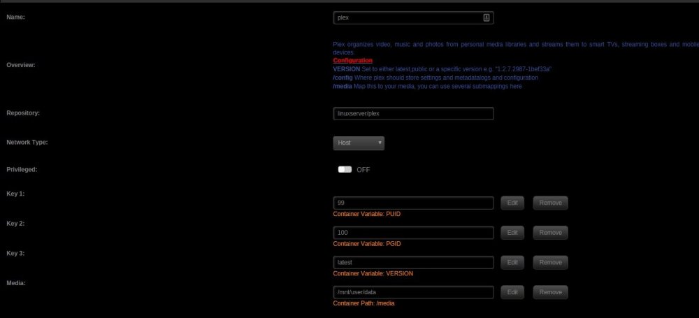

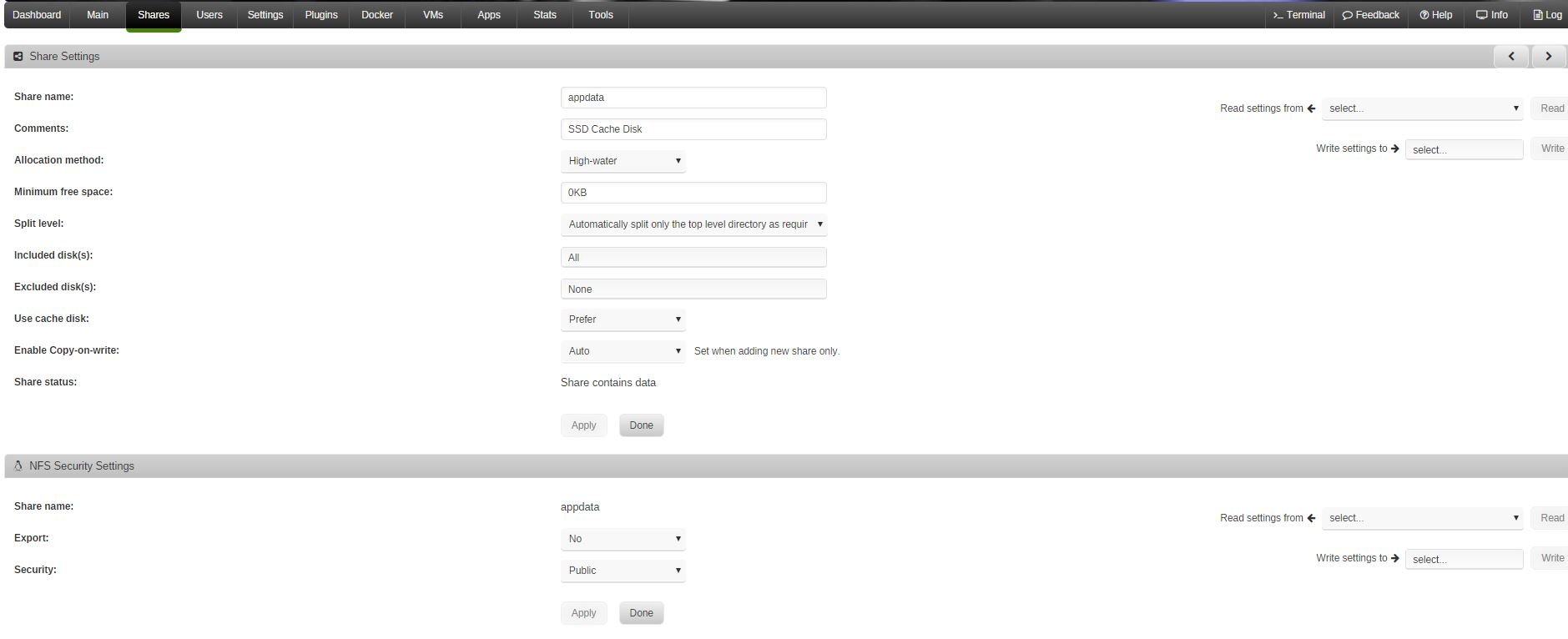

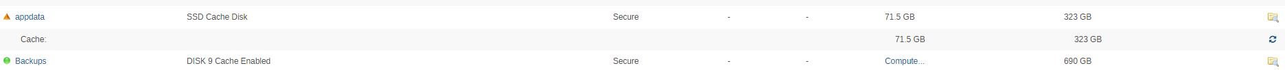

June 23, 20188 yr 14 minutes ago, CHBMB said: That makes no sense as they should be the same location. Have you checked that you've got no appdata files on any of the array drives Hi CHBMB I could't agree more! this is driving me nuts! as you can see from my screenshots everything is as it should be?

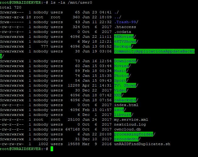

June 23, 20188 yr 2 minutes ago, CHBMB said: Try running ls -la /mnt/user0 Shouldn't see any appdata folder at all. Hi CHBMB, thanks for your time on this! Indeed, you are correct...
June 23, 20188 yr I am terrified of losing my libaries watched status etc but do you think if I renamed the mnt/cache/appdata/plex folder to mnt/cache/appdata/plexold and then deleted the docker, reinstalled fresh with the mnt/cache/appdata/plex setting plex should work? then I could stop the docker and move my plexold appdata into the newley created folders it could work?
June 23, 20188 yr Thinking about it, it wouldn't make any difference as Plex does not store any information anywhere other than the appdata folder so it would make no difference.. there must be something somewhere though! very frustrating as I can get my 10gbE network running perfectly but all dockers except this plex won't work with the 10gbE card!
June 23, 20188 yr Symbolic links that are created on /mnt/user/... do not carry over when referencing the share as /mnt/cache/... Interestingly enough, symlinks created on /mnt/cache/... will carry over to /mnt/user/... Plex makes very extensive use of symbolic links, so you're in a catch-22. Personally, I can't stand Plex, but I believe you can export your watched status to something like Trakt and then rebuild your appdata on /mnt/cache and get your watched status back.cd
June 24, 20188 yr Hi Squid, Thanks so much for all your help, to update you and help others I changed my Plex Docker to Binhex and now I have Plex AND my 10gbE card working without errors (all watched status libraries, users intact!). I am sure that this Pllex docker would be fine if on a fresh install with the 10gbE card but could not find a way to make it work on an existing installation Thanks Again

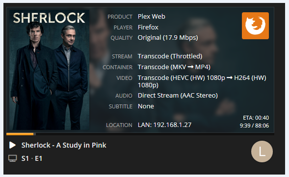

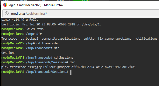

July 21, 20188 yr 2 hours ago, anylettuce said: is there a way to confirm plex docker is using RAM for trancoding? The entire unRAID OS loads into and runs from RAM on boot. If transcoding is set to any unRAID OS system location such as /tmp, which is typical, it will be taking place in RAM. As long as it is not set to a physical disk location such as a user share (including cache) or an unassigned disk location, Plex is transcoding to RAM As seen below, Plex is transcoding as I am playing an episode of Sherlock and transcode is set in the Plex docker to take place in /tmp If I look in /tmp I see the transcode session in real time taking place in /tmp/Transcode/Sessions The Plex transcode is indeed taking place in RAM
July 21, 20188 yr 5 hours ago, Hoopster said: The entire unRAID OS loads into and runs from RAM on boot. If transcoding is set to any unRAID OS system location such as /tmp, which is typical, it will be taking place in RAM. As long as it is not set to a physical disk location such as a user share (including cache) or an unassigned disk location, Plex is transcoding to RAM As seen below, Plex is transcoding as I am playing an episode of Sherlock and transcode is set in the Plex docker to take place in /tmp If I look in /tmp I see the transcode session in real time taking place in /tmp/Transcode/Sessions The Plex transcode is indeed taking place in RAM At first I thought I had an issue, then it came to me that it was a direct stream so no trans coding. As soon as had the file trans code it showed up.
