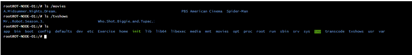

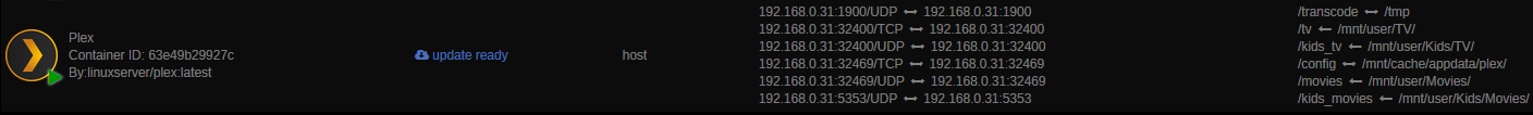

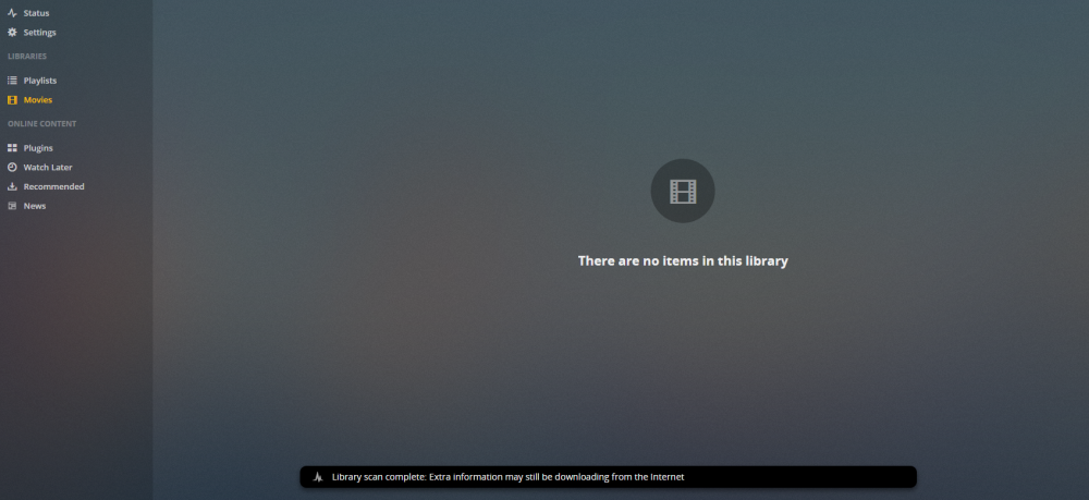

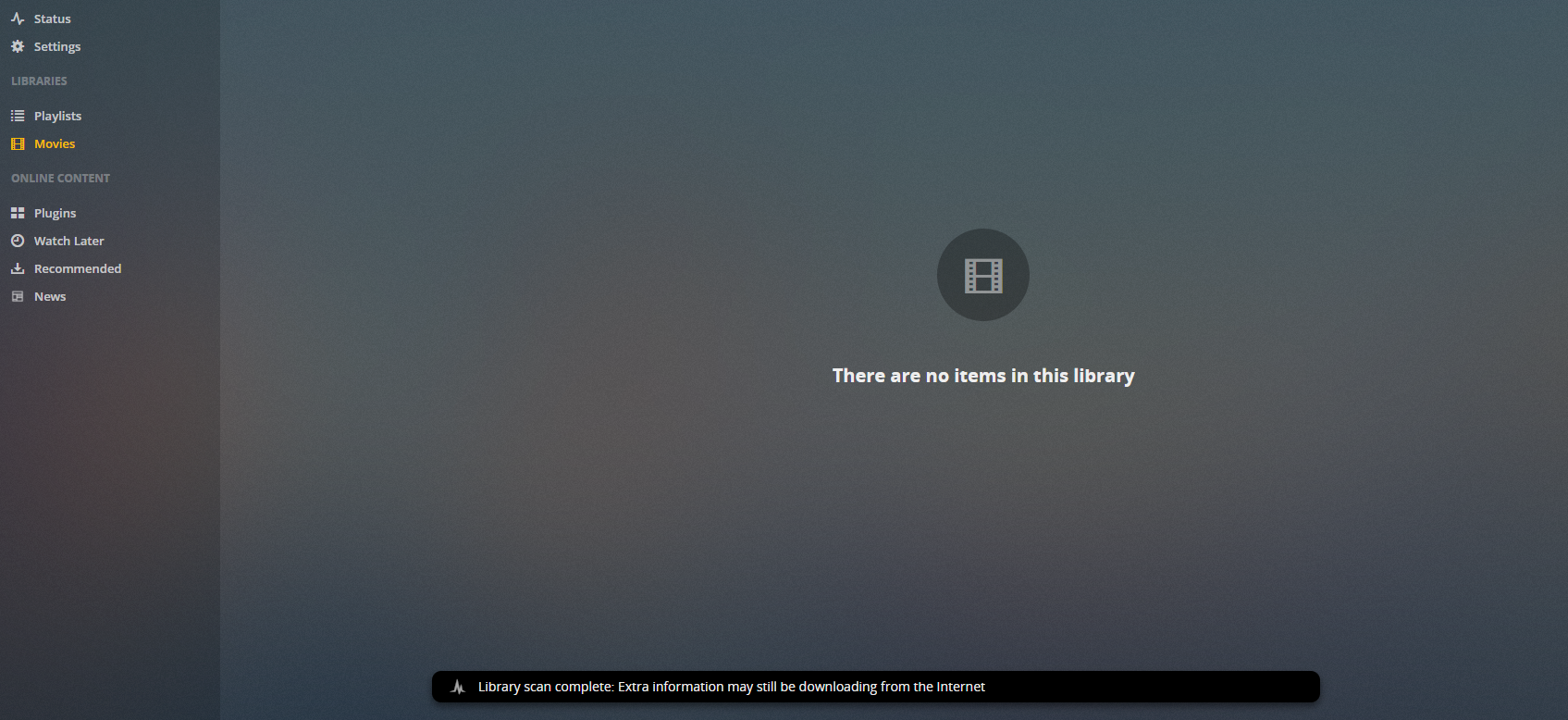

I am having an issue with Plex saying my library is empty,
The container is running with a host map to /Media.
/Media is an smb share created inside /etc/fstab
I am able to see files inside of the share on the container, but when I add the directory to a library in Plex, Plex shows the directory as empty
Attached a few screenshots as well as my docker-compose.ymllways

Screenshot with the exec terminals showing that the share is available.
User has full R/W on the share.
I eradicated some of the movie titles for a cleaner lookSMB.thumb.PNG.f84c1de12ab5105fcf840aeb2bbd105c.PNG
If you're not using Unraid, then Discord or Github for support.
