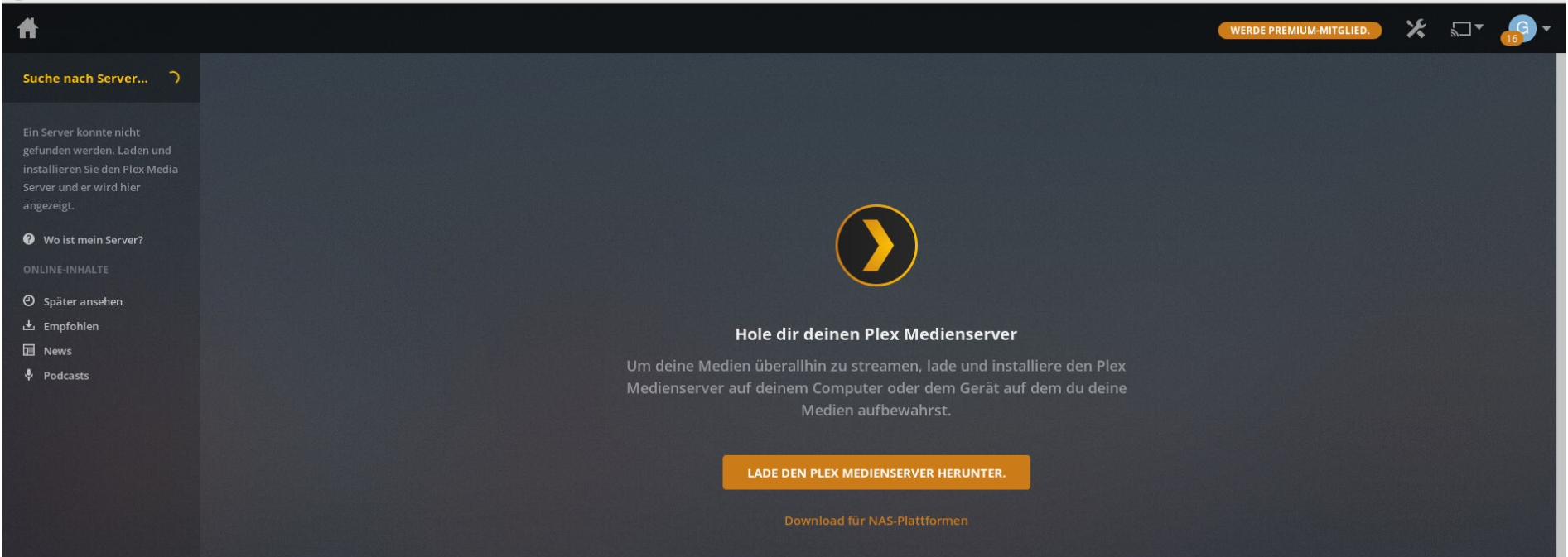

Hi, may a stupid question but im stuck here, im trying to setup unraid with plex for an friend on his server.
created a new plex account, installed the docker, now when i try 192.....:32400 im stuck at the start screen about plex pass (he just wants the free verseion) and
its looping in "searching for server", also no server settings in plex settings ... all i see is an advice to download the server ?
may an idea what im doing wrong here ? or isnt it possible to start with a new account in unraid ?
when i setted up mine i never had this issues ...
for any tipps, thanks ahead ;)
Edited by alturismo
Did the IP address of your plex server change? And now port forwarding on your router points to the wrong IP address?
all good, my fault ... claim code was it ... sorry

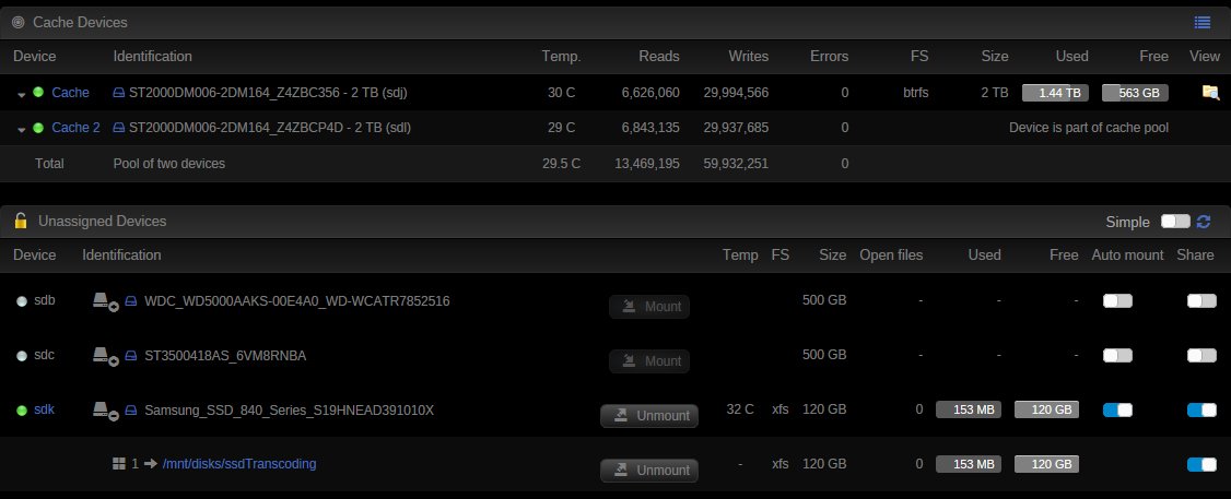

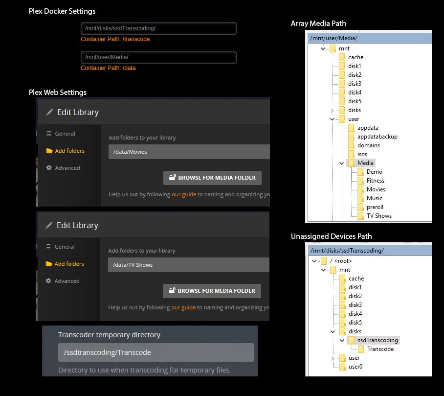

Good morning,
I hope this thread is the right place to ask this type of Plex setup question; but if not, any direction where to post it would be great.
I have a question about the pathing for my transcoding directory. If you take a look at the attached images, you can see parts of my setup. I have a mirrored pair of 2TB drives for my cache pool, which handles Dockers, Temporary Torrents, Docker App Data, and until recently, Transcoding. I decided that I wanted to take some of the load off of these drives, so I threw in an old samsung SSD to setup for transcoding only. To make sure it was only used for transcoding, I used the Unassigned Devices plugin to mount it outside of the array and cache pool.
If you look at my Paths.jpg attachment, you can see my PlexMediaServer docker settings, Server Settings, and the paths that WinSCP shows. I believe I have them all set correctly, but I have doubts because I have never seen a file written to the SSD drive. This SSD drive has remained at the same 153mb used since I first set it up, and I have never seen a file written to it, even when trying to run 6 or 7 streams at once and forcing them to transcode. It feels like the transcode is being written to some default location on my array or cache drives.
So if you have made it this far, I appreciate you taking the time to read this post and if you have any suggestions or advice, or see something that doesn't look setup correctly, that would be great. Also, is there a way or a log somewhere that shows exactly where it is writing temporary transcode files?
edit: I also noticed when making this post that my paths on the PlexServer site might be wrong.  If the container path for media is /data, and my movies are mapped to /data/movies, then it would make sense that the container path for /transcode should point to /transcode/transcode, instead of /ssdTranscoding/transcode. So I made that change and tested it this morning but still no luck. I can get up to 9 streams before hitting the buffer, but I am still not seeing any writing to the ssd.
Edited by e30andrew

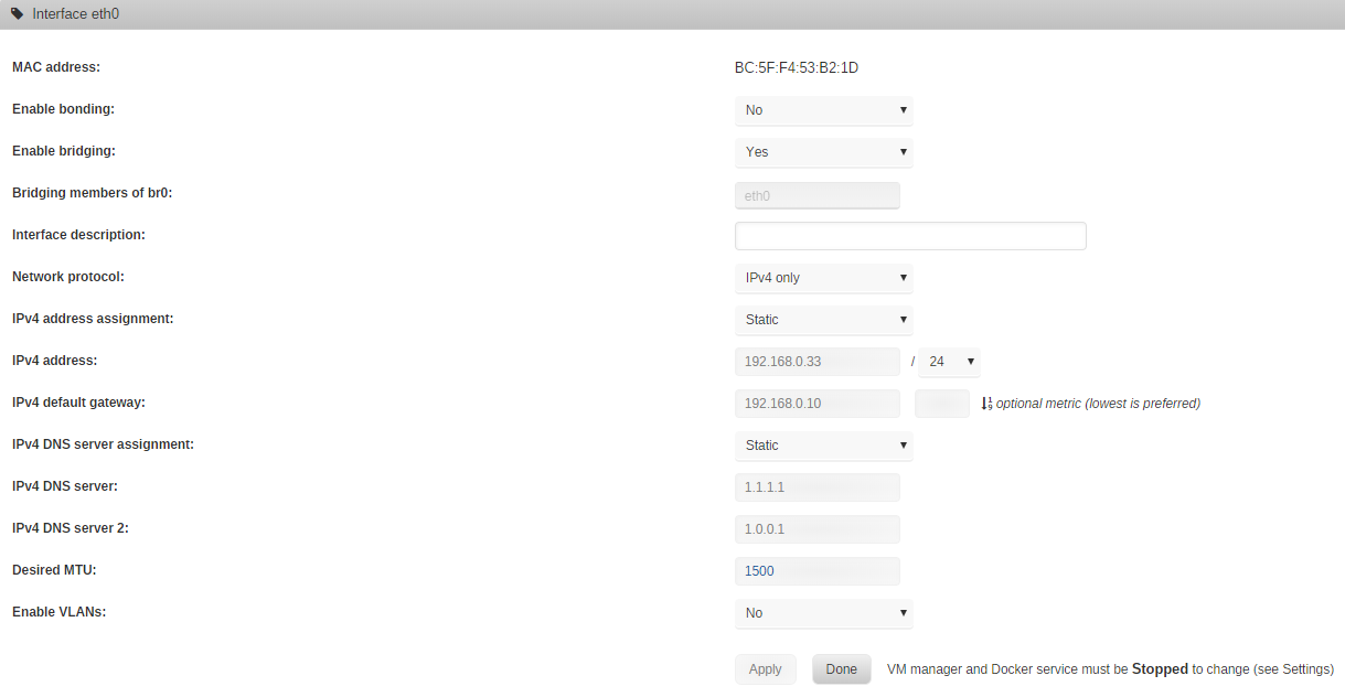

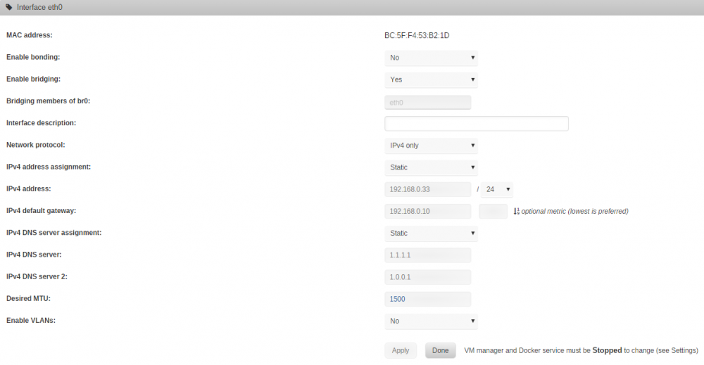

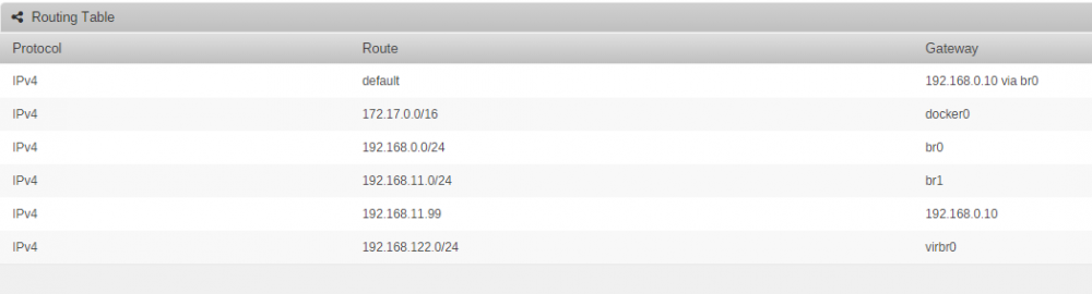

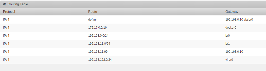

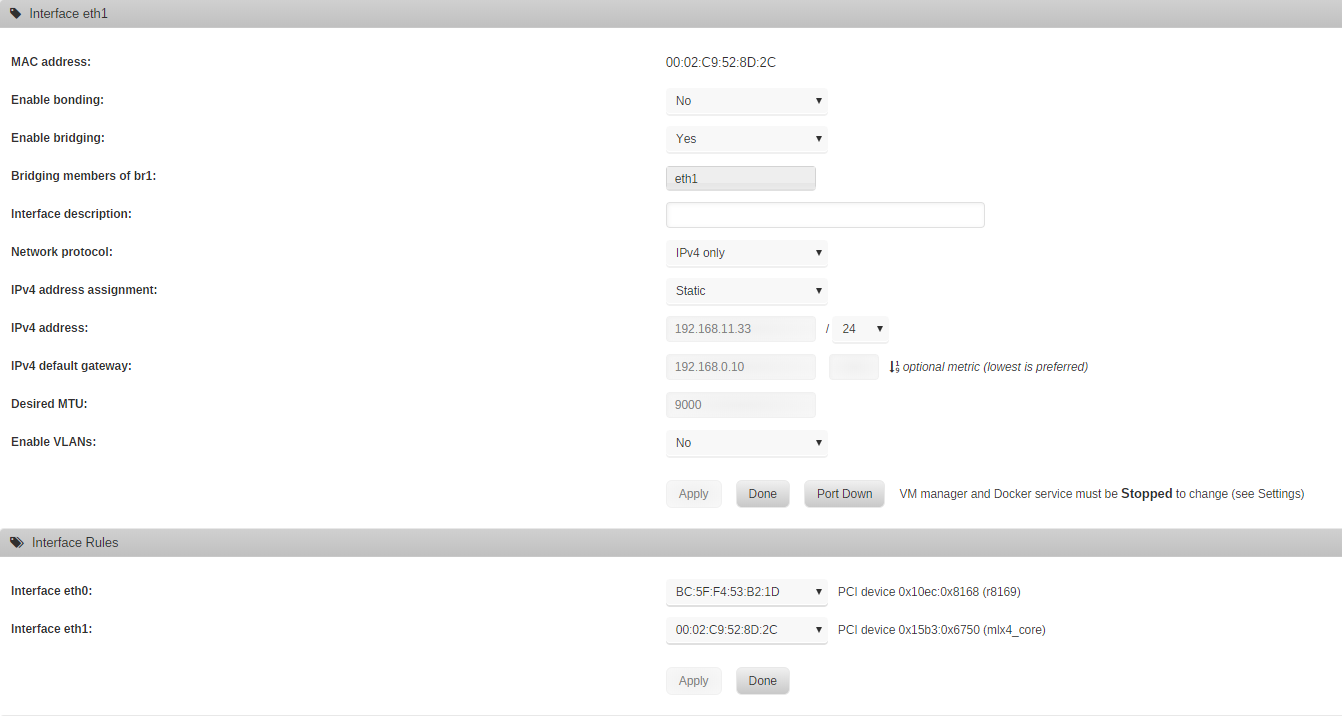

I am hoping someone in here can help me please as I am having a nightmare getting Plex back up and running.
Firstly although I am using linuxserver docker I have tried going to binhex and official with the same result so not specific to this docker but it's what I have been using since the beginning and trying to get back running!
The issue I have is that the docker is taking anything up to an hour to be accessable.. from starting the docker after about 20-30 minutes the library starts populating but I will not be able to access the server settings for about an hour with connection timeouts
Processing triggers for systemd (229-4ubuntu21.4) ...
[cont-init.d] 50-plex-update: exited 0.
[cont-init.d] done.
[services.d] done.
Starting Plex Media Server.
connect: Connection timed out
If I do a fresh installation with no library the server starts up immediately.
Now, I found half a fix by changing the docker from host mode to br1 and with that the docker starts immediately and is instantly accessable (as it always used to be) but the problem is that br1 has no internet access (it is a 10gbe card I have installed between my desktop & unRAIDserver)  I tried adding my pfsense router as the gateway for br1 but still no internet.
if I try br0 I still have the same slow issues as mentioned before
if I try bridge the problems are resolved as well but I cannot work out how to add a port mapping to Plex
so, in short there is something wrong with my network but after 3 days I really could do with some help!
Any guidance would be gratefully received! I have also attached my Plex Media Server log as well.
Many Thanks
Plex Media Server.log
