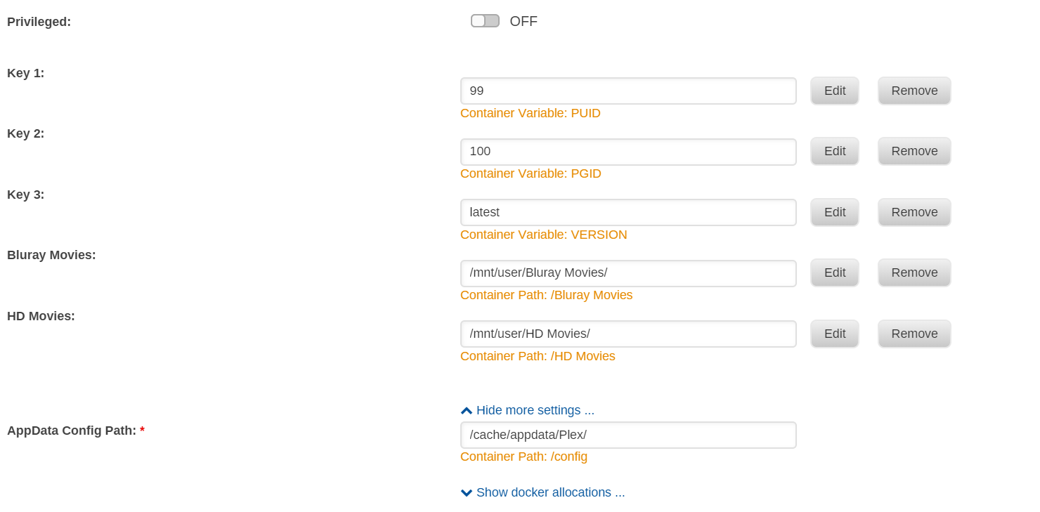

thanks guys.. i have Key1:  Key2: and Key3:  and no worries hoopster!

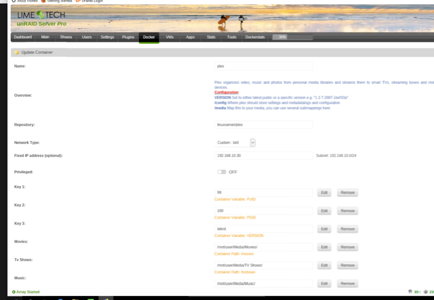

You need to add and create the media volume mapping keys with the Add another Path, Port, Variable... option at the bottom of the docker edit screen.

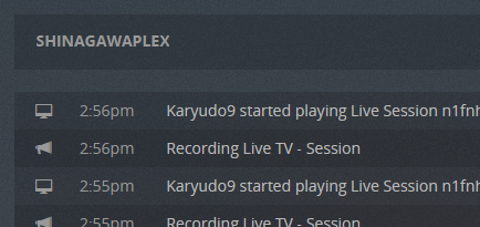

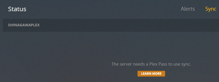

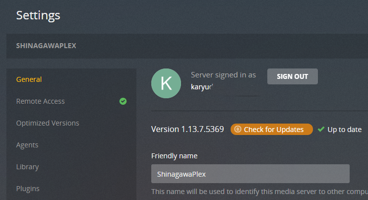

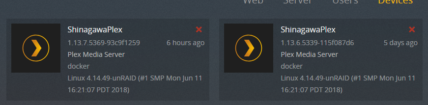

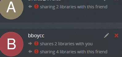

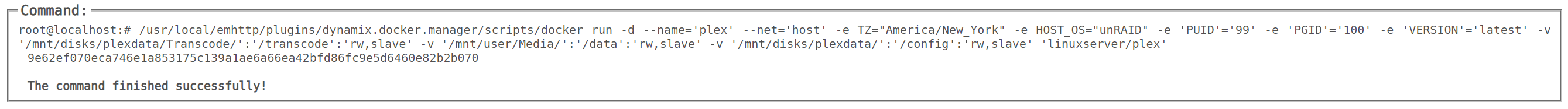

tl;dr After disabling and re-enabling Docker, Plex installation (server name, TV/DVR page) has changed. Want to restore from backup (I think).
I've been running Plex for at least a year with no problems. I don't think I've ever had a problem (especially recently) with the Docker not being available. I did recently have a problem with my unRAID system, however, and disabled Docker for a few days while I got that under control.
When I re-enabled Docker, the Plex page that came up was the configuration page as if I had a new server: Plex server name was defaulted to the unRAID server name. I didn't proceed, but instead cut the URL back to <local IP>:32400. Libraries and users are all there. Even On Deck and Continue Watching items are fine. But Plex can't find the original server, only the "new" one.

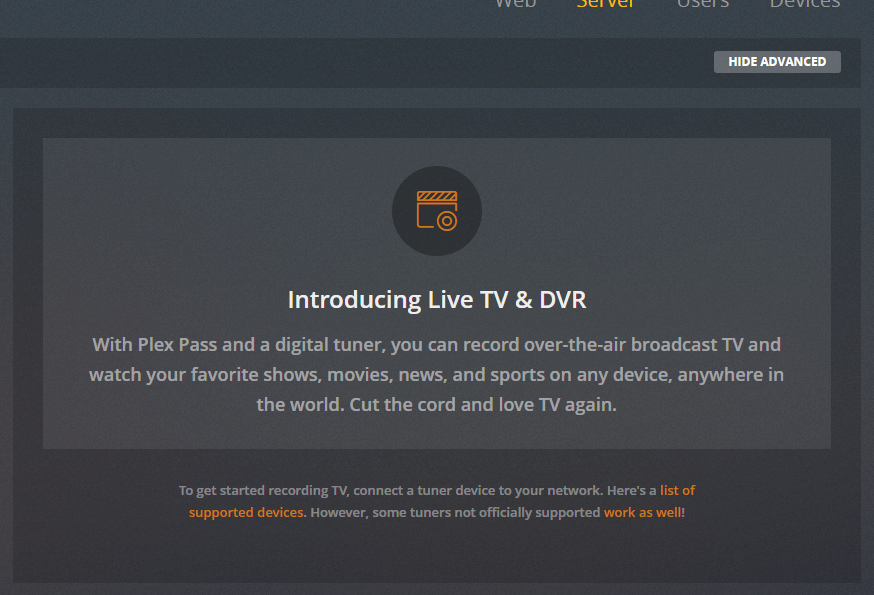

I also can't change anything under TV/DVR, which works, but doesn't look like it's even enabled. I'm sure Plex showed me the HDHomeRun details as recently as earlier today (i.e. after re-enabling Docker). But now that's gone. Also, Sync (which I never use, but still...) says I need a PlexPass, which I have.
I don't get what the hell happened. All I did was disable Docker, and then re-enable a few days later. It didn't fail catastrophically, yet it's obviously not working right. How can I fix this so that everything works again (preferably without having to individually re-share specific libraries with several dozen users)??
Buncha screen caps attached (including Plex Docker run command). And sorry for the novel-length post.

** One thing that comes to mind that changed while Docker was off: I had to upgrade my unRAID license from Plus to Pro, because I ended up adding a thirteenth drive. Fix Common Problems is complaining that I've now got two license keys on the system. (That's not *my* fault—Limetech did that!)
Is that a possible reason for the Plex weirdness (especially why it doesn't recognize the server as being the same as it was before)? Is there a way to fix this (even if it requires screwing around with backup config files or something)?

hey guys, got Plex working but everytime I reboot, i lose my library, thumbnails, etc and basically have to start from scratch.  here is my config page..  Any ideas?
Edited by xman111

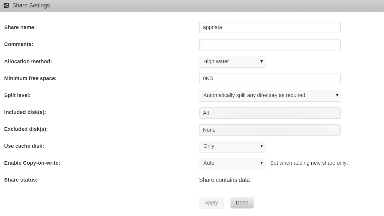

Config folder path should be "/mnt/cache/blah"
so /mnt/cache/appdata/Plex?
ps. thanks for the quick response..
Yes. What you had was creating a folder in RAM named /cache, which of course would not survive a reboot. All of unRAID is in RAM except the mounts.
thanks guys, that worked great.  What a great forum this is, appreciate it.

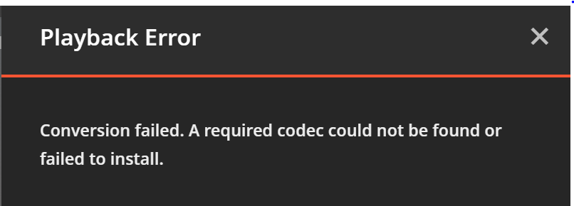

I just finished building my first server, and transfering all my movies and TV Shows from my old QNAP.  I primarily will be using my UNRAID as a PLEX Media server.  After getting everything transferred I tried playing some movies and things worked just like before. However when trying to play any of the TV  Shows I get a playback error.  After doing a few searches, it might have something to do with EAC3 codec.  I think.  I tried deleting the codec folder and restarting both the docker and the server.  I've also removed the docker completely and installed both the linuxserver and the official Plex docker, and both give me the same issue.  I'm stumped, any help would be greatly appreciated.

Yes everything worked fine before, and the files play with no issue with any other media player.
By "worked fine before" do you mean Plex Server was able to play the files from another installation? What is the file type (extension/codec)?
Correct plex was able to play/transcode any of the files without any issues. All files are MKV, after going through more movies I've found that the ones with audio codec TRUEHD and EAC3 will give me a playback error.
I believe that's a known plex issue. There are a few threads on their forum about it
I didn't have this issue when I had my PMS running on Windows. Is this because of the the Docker?
