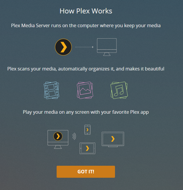

Since the new update, I keep getting this every time I try to open plex web.  Even though I had already set it up over again one time.  Also, I can't access the server tab in devices. Says "unavailable"
EDIT: Looks like going "back" on my browser takes me back to my server.  Still annoying, why's this happening?
Edited by pro9c3
