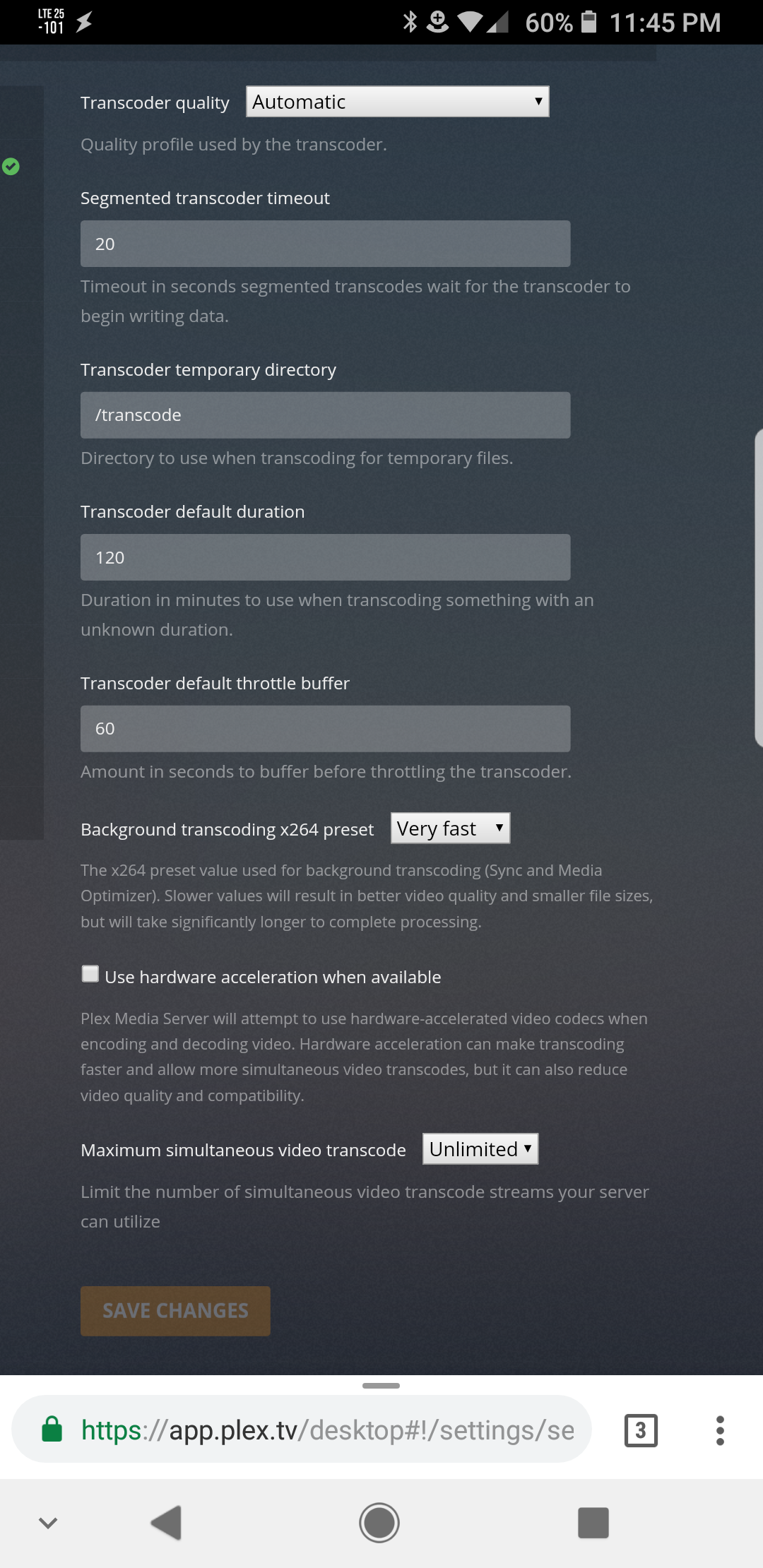

looks like hardware transcoding is now part of the main release (plexpass), no need to use old beta PMS to enable the feature.
anyone got it working on unraid (docker)?

I have just gotten this to work. Here is what I did.
SSH into server perform these commands, no quotes
"modprobe i915"
"chmod -R 777 /dev/dri"
modify the docker container for plex and show advanced
Extra Parameters (No Quotes) "--device=/dev/dri:/dev/dri"
I did enable "Privileged" however some folks stated earlier that wasn't required. Who cares it's working now!

If you dont add those to your go file, you will have to ssh in every reboot and manually do it.

Is plexpass still required for hw transcoding?

Hey guys,
Just clicked on the enable Hardware Acceleration button tried a few streams but none are using the (hw) option.
I saw about about changing some files, but could anyone give me a proper guide how to do this for a n00b?
3 hours ago, zin105 said:
Is priviliged mode a security issue? Could we get a solution for HW transcoding without using priviliged mode?
It works without priviliged mode if you change permission on /dev/dri to nobody:users.
