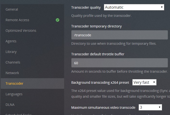

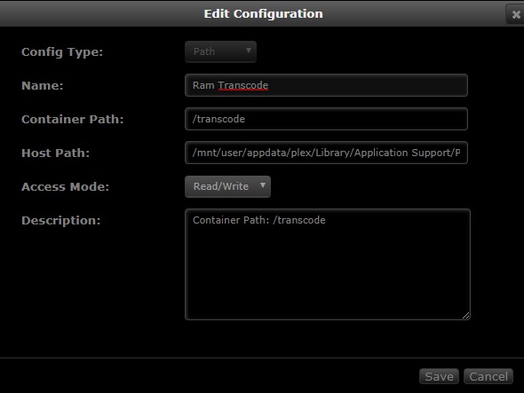

Yes I did.
My docker looks like this.
Inside the plex setting.
1 hour ago, Harro said:
Yes I did.
Well if you want to enable the ram transcoding, you need to use /tmp as a host path in your floder mapping.
Then, with an ssh connection, you can check that plex uses the /tmp folder with ls /tmp/transcode (you should see a session folder and in that session folder one folder per active stream).

Yes I did see the /tmp/transcode folder and inside the sessions folder for each stream. with my cpu pegged at 100%. To me it makes no difference since I stream everything from my Unraid server on lan to Kodi, but for the few family members that have outside access to my plex server those transcode  setting made their viewing horrible. So I converted back to the cache directory(SSD) for transcoding for them. Their feed back said that the viewing now is flawless.
This was basically an experiment within the last 2 weeks if I could make plex better for them and RAM transcoding was a fail, as far as I am concerned.

The docker shouldn't even know the flash exists. Are you sure you weren't mapping to /boot/tmp ?
I probably jumped to a misunderstood conclusion on that.  Yes it was running in RAM (even though memory usage never went up, only CPU usage).I would post a screen shot again but at the moment rebuilding a drive.
I understand that Unraid once booted runs in RAM. Once I had the setting for plex and the container set.  Host path /tmp  and container path :/transcode . I restarted docker. Later that night got a phone call from sister asking why plex on her roku kept crashing back to the home screen once she started a stream. Thought that was odd and since plex was running for her with out a problem before, I could only come to the conclusion that it was the settings I had done in the morning to the container.I open the web gui for plex and see her stream as paused and my nephews stream as direct with no converting. My cpu is pegged at 100% and memory usage is stable at 20%.  I then go into editing the container for plex to check those settings i put in. While all the streams are still active and I am in the edit for the host path which is just /tmp, clicking on that box will bring a drop down showing what seemed to be the contents of my flash drive. But looking back now probably was just the tmp ram directory.I could see the transcode folder and streams inside that. So I just assumed at that point it was holding that /tmp on flash drive, which at the time made sense to me with the cpu usage and what plex was doing on the clients end. With over 5 gig in sessions from the transcode folder and if the flash drive was dishing that out I could understand the problems clients were having.(This was all my thinking at this time).
 Mapping the host path inside the cache folder solved all these problems with my family's plex outside my lan.
This is how i came to the conclusion that the /tmp doesn't work for me unless I map that tmp to a folder.
