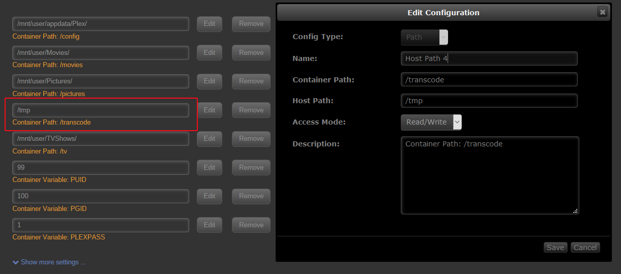

deuxcolors Posted January 28, 2018 Share Posted January 28, 2018 I went back to the old method of adding /transcode path to /tmp And added /tmp to /tmp Issue resolved it seems Quote Link to comment

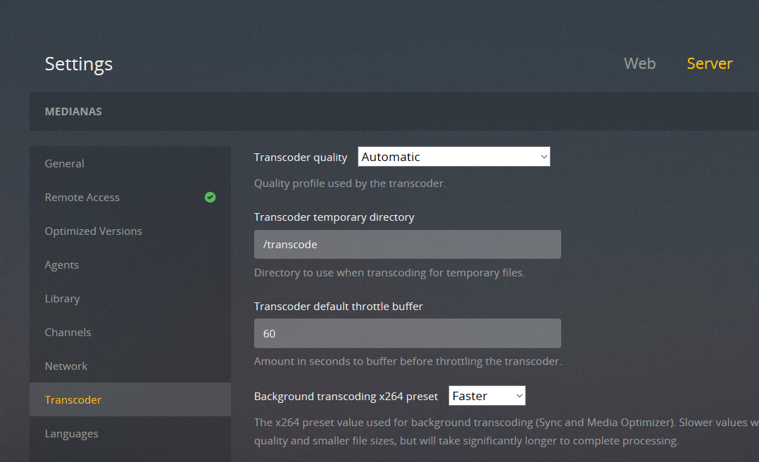

Hoopster Posted January 29, 2018 Share Posted January 29, 2018 (edited) On 1/28/2018 at 9:06 PM, carlos28355 said:  On 1/28/2018 at 4:21 AM, deuxcolors said: I went back to the old method of adding /transcode path to /tmp And added /tmp to /tmp Issue resolved it seems this is over my head. can you provide more detail please? thank you!  deuxcolors is referring to mapping a container path to a host path for transcoding purposes and then specifying the container path in the Plex server transcoder settings.  /tmp is RAM on the unRAID server.  He mapped /tmp to /tmp. In my case I have /transcode mapped to /tmp but the concept is the same.  Edit Plex docker settings and do the following:  1 - Edit the appropriate host path variable (or add a new one) for your transcode mapping.  2 - Enter the desired container path name (I used /transcode, deuxcolors used /tmp) and enter a host path of /tmp if you want to transcode to RAM.   3 - Click Save button in Edit Configuration.  4 - Click Apply button in Docker Edit screen.  5. Open Plex docker WebUI  6. Click on Settings  7. Select Server Settings  8. Select Transcoder   9. Enter the name of the container path you specified in step two as the Transcoder temporary directory. deuxcolors mapped /tmp to /tmp so his entry here is /tmp  This tells Plex to transcode videos to the /tmp directory on the host which is in RAM. This could also be done to a directory on your cache drive by specifying the Host Path as something like /mnt/user/cache/plex/transcode in step two. The important thing is that in Plex transcode settings you specify the name of the Container path variable as the Transcoder location.  10. Click Save Changes button Edited February 3, 2018 by Hoopster 1 Quote Link to comment
deuxcolors Posted January 29, 2018 Share Posted January 29, 2018 Sorry for the late reply. Quick correction. I did both: -I already had /transcode set to the cache drive, and I remapped it to unRAID's /tmp -Then I added a /tmp path and mapped it to unRAID's /tmp since I read that the encoder was using /tmp within plex so I gave it access to RAM. So far no issues. Quote Link to comment
