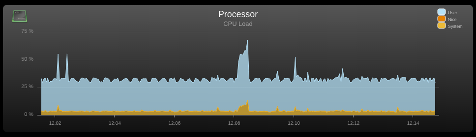

Over the weekend, I changed from a Xeon Windows machine running Plex and an N54L running unraid with the data, to moving everything to unraid on the Xeon.
All generally went smoothly, but Plex seems to be using quite a bit of CPU.
I've taken screenshots of what I can find and hoping someone can offer a bit of guidance on what is causing this?
I see the scanner run periodically to increase CPU usage, but then drops when done. Also, when Plex isn't using that much CPU, the CPU generally sits about 2%.
Any ideas?

As an additional screenshot, I restarted the Plex docker at 12:34 and this is the outcome.
Any ideas?
Is anyone able to help with this, as it still appears to be happening?
