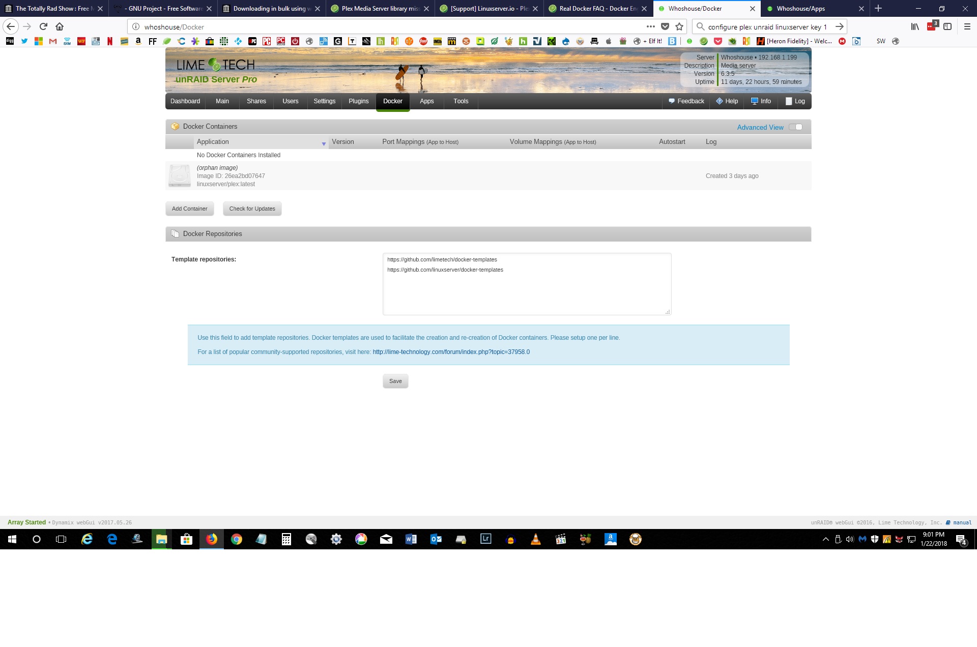

im new to dockers and im just not that smart. Is there a way to search this thread? i have no idea what key 1 and key 2 and key 3 are and im not sure how to get plex to scan my library of one of my shares...the answer probably lies within these pages but ive been reading for a while and searching all over the internet with different wording and cant find my answers. thanks
Link to post
Instead of reading here try the Docker FAQ
Link to post
I wasnt sure the FAQ for dockers in general would help me trying to figure out a specific docker ie plex but it actually got me on the right path and i think ill be able to solve my issue i think/hope...thanks!
Link to post
