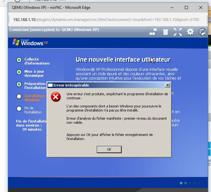

July 20, 20179 yr Hello, I'd like to install a windows xp VM, but it doesn't work. could you please help me to make the hard drive recognized ? (dl link does not work anymore) Thanks <domain type='kvm'> <name>Windows XP</name> <uuid>86e4b42c-8836-294b-45d8-19030481fec1</uuid> <metadata> <vmtemplate xmlns="unraid" name="Windows XP" icon="windowsxp.png" os="windowsxp"/> </metadata> <memory unit='KiB'>4194304</memory> <currentMemory unit='KiB'>4194304</currentMemory> <memoryBacking> <nosharepages/> </memoryBacking> <vcpu placement='static'>2</vcpu> <cputune> <vcpupin vcpu='0' cpuset='0'/> <vcpupin vcpu='1' cpuset='4'/> </cputune> <os> <type arch='x86_64' machine='pc-i440fx-2.7'>hvm</type> </os> <features> <acpi/> <apic/> <hyperv> <relaxed state='on'/> <vapic state='on'/> <spinlocks state='on' retries='8191'/> <vendor_id state='on' value='none'/> </hyperv> </features> <cpu mode='host-passthrough'> <topology sockets='1' cores='1' threads='2'/> </cpu> <clock offset='localtime'> <timer name='hypervclock' present='yes'/> <timer name='hpet' present='no'/> </clock> <on_poweroff>destroy</on_poweroff> <on_reboot>restart</on_reboot> <on_crash>restart</on_crash> <devices> <emulator>/usr/local/sbin/qemu</emulator> <disk type='file' device='disk'> <driver name='qemu' type='raw' cache='writeback'/> <source file='/mnt/disks/Samsung_SSD_840_PRO_Series_S1ATNSAD774980B/Windows XP/vdisk1.img'/> <target dev='hdc' bus='virtio'/> <boot order='1'/> <address type='pci' domain='0x0000' bus='0x00' slot='0x05' function='0x0'/> </disk> <disk type='file' device='cdrom'> <driver name='qemu' type='raw'/> <source file='/mnt/user/system/libvirt/isos/fr_windows_7_ultimate_with_sp1_x64_dvd_u_677299.iso'/> <target dev='hda' bus='ide'/> <readonly/> <boot order='2'/> <address type='drive' controller='0' bus='0' target='0' unit='0'/> </disk> <disk type='file' device='cdrom'> <driver name='qemu' type='raw'/> <source file='/mnt/user/system/libvirt/isos/virtio-win-0.1.126-2.iso'/> <target dev='hdb' bus='ide'/> <readonly/> <address type='drive' controller='0' bus='0' target='0' unit='1'/> </disk> <controller type='usb' index='0' model='ich9-ehci1'> <address type='pci' domain='0x0000' bus='0x00' slot='0x07' function='0x7'/> </controller> <controller type='usb' index='0' model='ich9-uhci1'> <master startport='0'/> <address type='pci' domain='0x0000' bus='0x00' slot='0x07' function='0x0' multifunction='on'/> </controller> <controller type='usb' index='0' model='ich9-uhci2'> <master startport='2'/> <address type='pci' domain='0x0000' bus='0x00' slot='0x07' function='0x1'/> </controller> <controller type='usb' index='0' model='ich9-uhci3'> <master startport='4'/> <address type='pci' domain='0x0000' bus='0x00' slot='0x07' function='0x2'/> </controller> <controller type='pci' index='0' model='pci-root'/> <controller type='ide' index='0'> <address type='pci' domain='0x0000' bus='0x00' slot='0x01' function='0x1'/> </controller> <controller type='virtio-serial' index='0'> <address type='pci' domain='0x0000' bus='0x00' slot='0x04' function='0x0'/> </controller> <interface type='bridge'> <mac address='52:54:00:f3:15:da'/> <source bridge='virbr0'/> <model type='virtio'/> <address type='pci' domain='0x0000' bus='0x00' slot='0x03' function='0x0'/> </interface> <serial type='pty'> <target port='0'/> </serial> <console type='pty'> <target type='serial' port='0'/> </console> <channel type='unix'> <target type='virtio' name='org.qemu.guest_agent.0'/> <address type='virtio-serial' controller='0' bus='0' port='1'/> </channel> <input type='tablet' bus='usb'> <address type='usb' bus='0' port='1'/> </input> <input type='mouse' bus='ps2'/> <input type='keyboard' bus='ps2'/> <graphics type='vnc' port='-1' autoport='yes' websocket='-1' listen='0.0.0.0' keymap='en-us'> <listen type='address' address='0.0.0.0'/> </graphics> <video> <model type='qxl' ram='65536' vram='65536' vgamem='16384' heads='1' primary='yes'/> <address type='pci' domain='0x0000' bus='0x00' slot='0x02' function='0x0'/> </video> <memballoon model='virtio'> <address type='pci' domain='0x0000' bus='0x00' slot='0x06' function='0x0'/> </memballoon> </devices> </domain>
July 20, 20179 yr Haven't tried, but wouldn't you simply during install press whatever key it wants you to to install another driver and then select the appropriate virtio driver Sent from my LG-D852 using Tapatalk

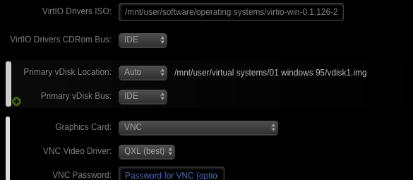

July 20, 20179 yr @neuk34change the bus type of the primary disk to ide or sata then you will not need virtio drivers Edited July 20, 20179 yr by gridrunner
July 20, 20179 yr @squid : it ask for a floppy drive that contains drivers.. @gridrunner : works ! it copy files from iso, but installation stop at the beginning..
July 20, 20179 yr 9 minutes ago, neuk34 said: @squid : it ask for a floppy drive that contains drivers.. @gridrunner : works ! it copy files from iso, but installation stop at the beginning.. There have been a lot of reports that you need to run with just 1 cpu while doing the installation or any major updates. Additional CPU’s can be added later when setup completes successfully.
July 20, 20179 yr @neuk34 Ok, a few things to do here. Probably the graphics type is causing the install to fail. Change the VNC graphics type to Cirrus. Change HyperV to no. Primary vdisk to IDE One vCPU for install Use no more than 2 gigs for memory Also for network to function, you will need to change the network adapter to rtl8139 as xp won't have drivers for virtio You can't do this through the VM manager so edit the XML to be this <interface type='bridge'> <mac address='52:54:00:f3:15:da'/> <source bridge='virbr0'/> <model type='rtl8139'/> </interface> Edited July 20, 20179 yr by gridrunner
July 21, 20179 yr um thats strange. I have installed xp with probs myself. maybe your install iso is corrupt? Can you get another and try? Post your xml here again to look at. The first you posted had win7 as the iso so i think you may have posted wromh xml by mistake.
