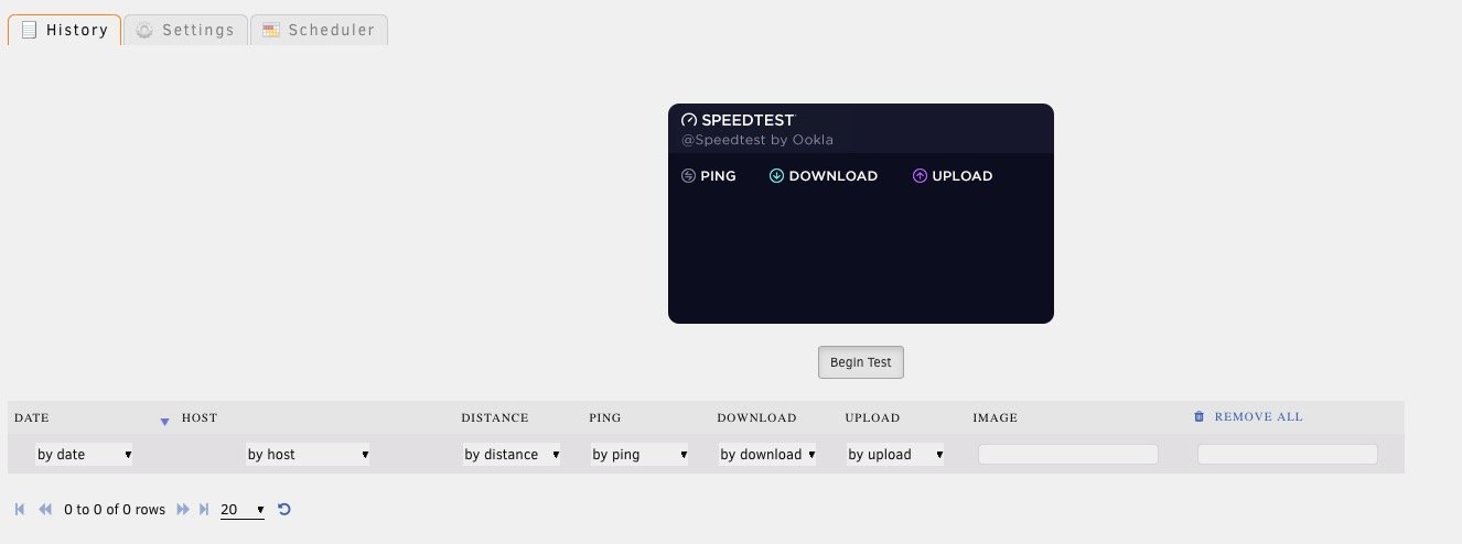

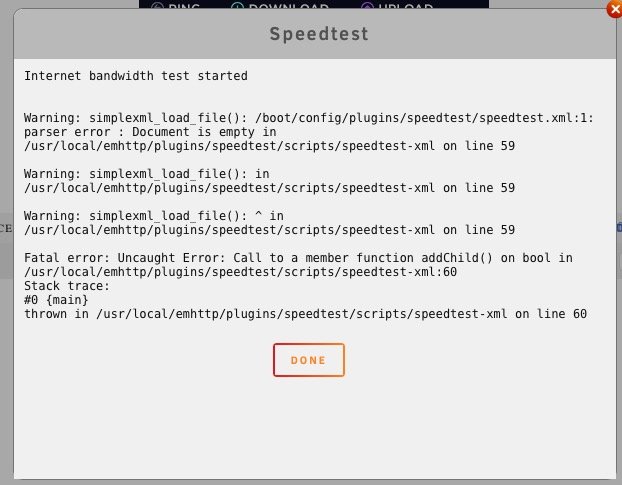

Hi all. This plug has been working great for years, but I see today the results have all vanished and when I try to run a test I get an error. Screen-shots attached.
I have tried removing and re-installing the plugin.
Anyone know what this might be?

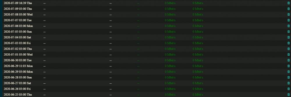

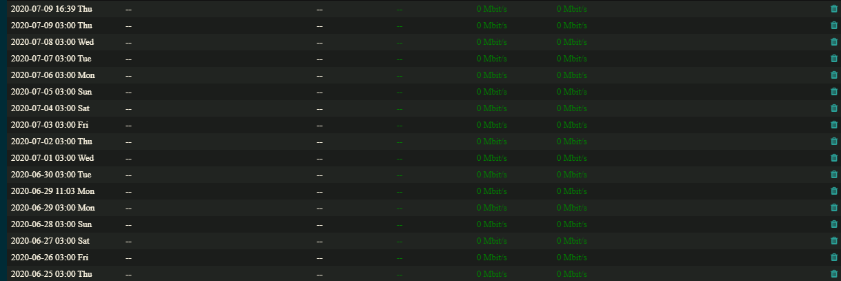

Graph disappeared for me on Wednesday and the button/schedule also doesn't work.
However, running speedtest-cli through the terminal is still fine.

Looks like your file /boot/config/plugins/speedtest/speedtest.xml is corrupted.
You can just remove it, it is the history of speedtest. It will create new one.
