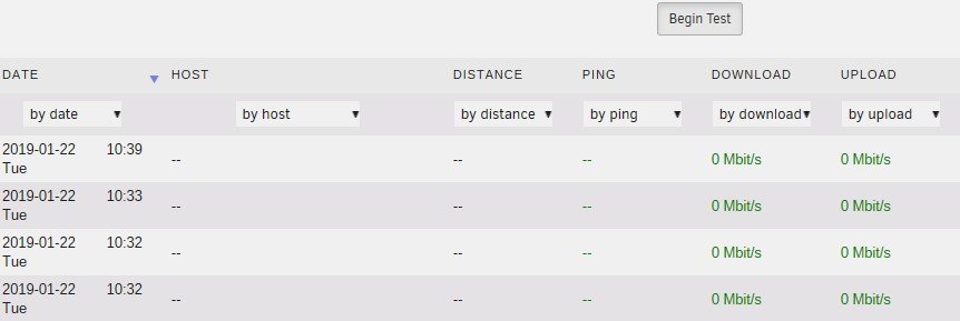

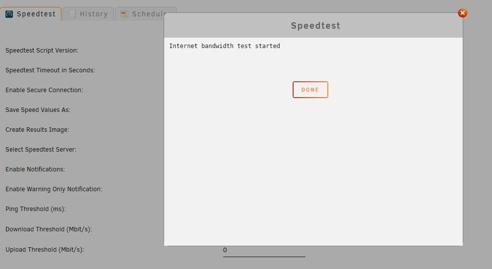

Speedtest appears to be broken in 6.7.0 RC1. When starting a test, I get the popup with text saying test has started but nothing happens. History entries are blank. Tried uninstall/reinstall no help.
Edited by interwebtech
Try running speedtest-xml from the command line
3 hours ago, dmacias said:
Not sure I know how to do that specifically. What is the syntax?
Just running speedtest-xml from the comment line should work. So the scheduled one should work too. But manual must be broken.
Found this in logs so I ran it from unRaid built-in web console:
/usr/local/emhttp/plugins/speedtest/scripts/speedtest-xml --verbose

Internet bandwidth test started
result:
root@Tower:~# /usr/local/emhttp/plugins/speedtest/scripts/speedtest-xml --verboseERROR:root:code for hash md5 was not found.Traceback (most recent call last): File "/usr/lib64/python2.7/hashlib.py", line 147, in    globals()[__func_name] = __get_hash(__func_name) File "/usr/lib64/python2.7/hashlib.py", line 97, in __get_builtin_constructor   raise ValueError('unsupported hash type ' + name)ValueError: unsupported hash type md5ERROR:root:code for hash sha1 was not found.Traceback (most recent call last): File "/usr/lib64/python2.7/hashlib.py", line 147, in    globals()[__func_name] = __get_hash(__func_name) File "/usr/lib64/python2.7/hashlib.py", line 97, in __get_builtin_constructor   raise ValueError('unsupported hash type ' + name)ValueError: unsupported hash type sha1ERROR:root:code for hash sha224 was not found.Traceback (most recent call last): File "/usr/lib64/python2.7/hashlib.py", line 147, in    globals()[__func_name] = __get_hash(__func_name) File "/usr/lib64/python2.7/hashlib.py", line 97, in __get_builtin_constructor   raise ValueError('unsupported hash type ' + name)ValueError: unsupported hash type sha224ERROR:root:code for hash sha256 was not found.Traceback (most recent call last): File "/usr/lib64/python2.7/hashlib.py", line 147, in    globals()[__func_name] = __get_hash(__func_name) File "/usr/lib64/python2.7/hashlib.py", line 97, in __get_builtin_constructor   raise ValueError('unsupported hash type ' + name)ValueError: unsupported hash type sha256ERROR:root:code for hash sha384 was not found.Traceback (most recent call last): File "/usr/lib64/python2.7/hashlib.py", line 147, in    globals()[__func_name] = __get_hash(__func_name) File "/usr/lib64/python2.7/hashlib.py", line 97, in __get_builtin_constructor   raise ValueError('unsupported hash type ' + name)ValueError: unsupported hash type sha384ERROR:root:code for hash sha512 was not found.Traceback (most recent call last): File "/usr/lib64/python2.7/hashlib.py", line 147, in    globals()[__func_name] = __get_hash(__func_name) File "/usr/lib64/python2.7/hashlib.py", line 97, in __get_builtin_constructor   raise ValueError('unsupported hash type ' + name)ValueError: unsupported hash type sha512Traceback (most recent call last): File "/usr/local/emhttp/plugins/speedtest/scripts/speedtest-latest.py", line 120, in    from md5 import md5 File "/usr/lib64/python2.7/md5.py", line 10, in    from hashlib import md5ImportError: cannot import name md5Internet bandwidth test started
Thanks. I updated python in Nerdpack.
I also updated python and pip for 6.7 and added setuptools as a separate package

Thanks for the fix. All good now.
