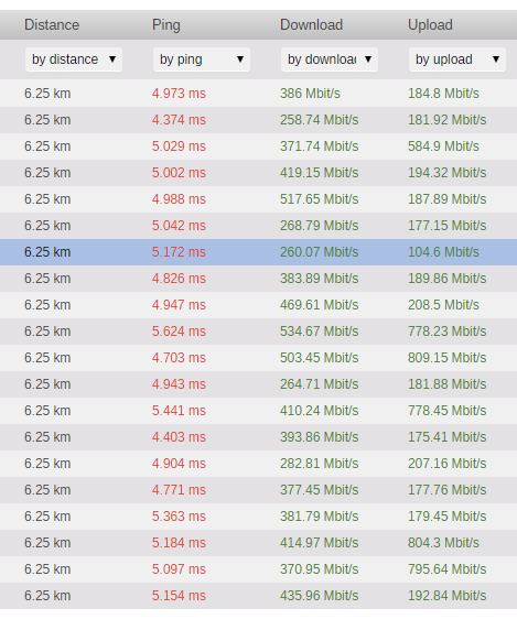

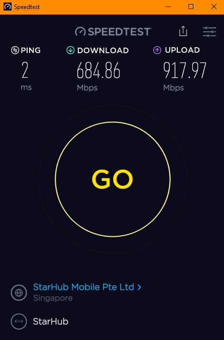

Here is a test i did just now:
Plugin: 285 down, 146 up
And here's a view of the daily tests that occur at 03:30am
Edited by dalben
5 minutes ago, dalben said:
My connection is 1Gb /1Gb
No, this is plugin related.
PC Client
Did you ever try the speedtest docker? This isn't a problem with the plugin itself. It's a problem with the speedtest-cli script running on unRAID natively. I cannot get consistent results anymore with the script. I can with the docker running the same script, same python. My point was there may be a problem with 1000 upload speeds and the speedtest-cli which would have to be taken up with author of the script on his github.
