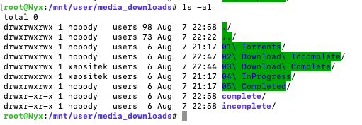

I have noticed that Transmission makes a "complete" and "incomplete" folder in the specified "/downloads" folder on startup (new or restarted).
I have "Host Path 2" set as "/mnt/user/media_downloads/" and in settings.json I have the following set:
    "download-dir": "/downloads/03 Download Complete/",
    "incomplete-dir": "/downloads/02 Download Incomplete/",
I have confirmed the configuration is correct and this should override the need for "complete" and "incomplete" to be created.
Ask: Can this be investigated? For now I just made a cronjob that deletes these folders as they are redundant and unnecessary.
Same here.
idk why this 2 folders are recreated every time that the dorcker starts.

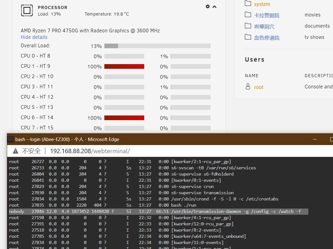

Has anyone else noticed resource issues with large torrents in 3.00?
Loading up a big torrent (latest MAME CHD in this instance) causes transmission to use 100% CPU which lags web/remote interface and also causes download speeds to drop (getting 40mbit).
Roll back to 2.94 (linuxserver/transmission:2.94-r3-ls53) load up the same torrent and CPU sits around 40%, UI stays responsive and speeds use my full 250mbit.

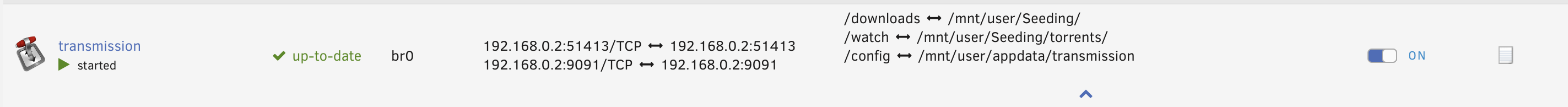

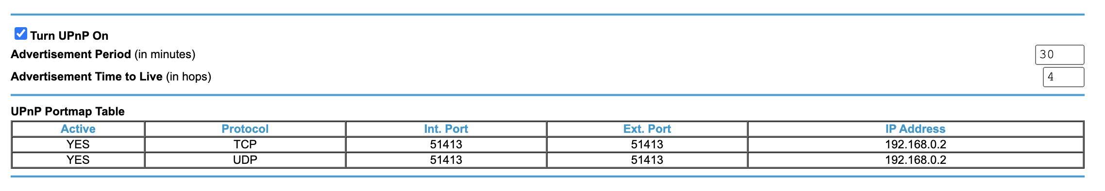

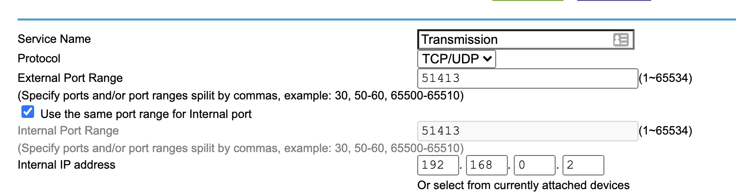

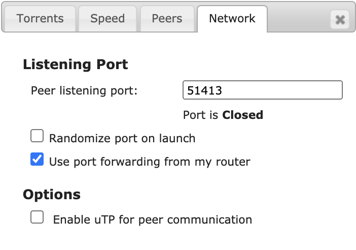

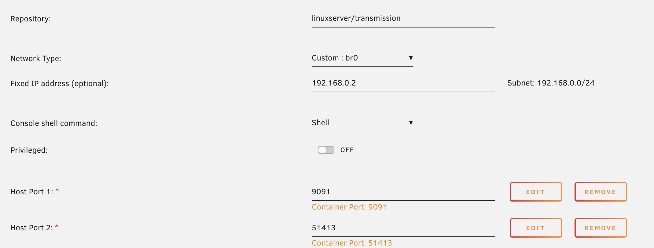

Hello! My transmission is showing port 51413 as closed, and I'm unable to seed any torrents...
Been reading through this thread and have not yet found something that worked. :/
I've tried running in host mode, bridge mode, and now br0 mode with a set static IP. Port forwarding for port 51413 has been configured on my router. I did initially have UPnP on and saw it as active for my docker's static IP, but I believe I read in this thread that this container does not actually support UPnP, so it's since been disabled. Still no luck... The port forwarding is currently configured as TCP/UDP, but I've also tried just using TCP and still no dice. I've also tried forwarding different ports to 51413 on the container. Afaik, nothing else is using port 51413 on my network. https://www.canyouseeme.org/ shows port 51413 as open...
Here's some of the container's startup logs when I last restarted it:

I've attached some screenshots of my docker/routes configs and some other hopefully helpful tidbits.
I'm stumped. Any ideas on what else I need to try?

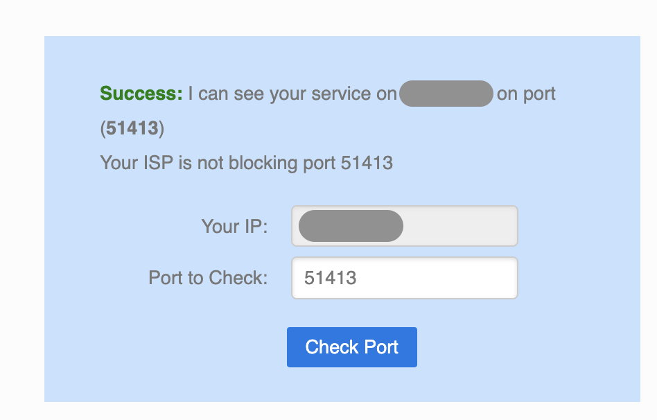

Okay... I have been banging my head against the wall with the same issue on the same day you posted this. Ports forwarded on the firewall/router and canyouseeme reports yes. There could be a few avenues that could be causing this. I got a new pfSense firewall/router the same time I noticed this but now I'm thinking that's a coincidence.
Checking the git issues page there looks to be a couple of threads on this over the years and it looks like an ipv6 dns entry on their end could be causing this.
https://github.com/transmission/transmission/issues/381
https://github.com/transmission/transmission/issues/407
https://github.com/transmission/transmission/issues/1190
https://forum.transmissionbt.com/viewtopic.php?t=14274
However... both of those threads point to performing a curl against portcheck.transmissionbt.com... well... I am getting an http timeout messages when I do that, so maybe the portcheck site the transmission team has is down right now and that's all it is? isitdownrightnow is also reporting it as down? Maybe it only responds to http post requests? but the git issues threads above are just hitting it with GET requests without issue... https://www.isitdownrightnow.com/portcheck.transmissionbt.com.html
I have my container setup in bridge mode but that shouldn't cause any issues as it wasn't before.
One of the git issues threads mentioned that the dev team said it was cosmetic only?
I can't figure out if the site is truly down or there's something more at play, I have dns host overrides configured on pfSense to set that portcheck hostname to ipv4 so there's no way it could be the ipv6 vs ipv4 issue in this instance.
I hope this helps and at the very least we can figure out why this is happening.

Hmm, I'll need to read over these in more detail after work.
I did just take a quick look at the web GUI, and it does look like the POST call comes back with status 200 eventually (once it resolved from "Unknown" to "Closed").
It's making a POST request to http://your_transmission_ip_and_port/transmission/rpc with a payload of :
{method: "port-test"}
After about 30 seconds, it came back as status 200, response:
{"arguments":{},"result":"portTested: http error 0: No Response"}
I don't know if that response means there was no response on the remote host hitting my network, or if their service was not getting a response from their own port checking service. 🤷‍♂️ I doubt they'd pass a 200 back if the latter were the case...

I dug into transmission's source code, and it does look like it's still using https://portcheck.transmissionbt.com/:your_port to test if the port is open.
I'm consistently getting timeouts CURLing http://portcheck.transmissionbt.com/51432, both with POST and GET, and forcing IPV4 since those git issues suggest the DNS can't resolve IPV6.
nslookup is working as well, so the DNS _is_ resolving just fine, it's just not responding to web requests. I couldn't ping the IP behind it either... Maybe it is down? 😕
I'm kinda stuck, same exact scenario/results as you. Not sure if this makes you feel better, but on one of those threads I posted earlier, someone mentioned how the transmission team mentioned that it was "just cosmetic", so as long as you have the correct ports forwarded the program SHOULD function and allow you to seed. I'm going to keep an eye on it though.
Admittedly, I HAVE been able to seed since noticing this; however, I wanna say that you can still technically seed without having any ports forwarded, but it complicates the process of establishing a connection with peers.
So it's hard for me to tell if I'm able to seed as much as I should be. Based on everything else I've tested, I'm honestly just operating under the assumption that my network configuration is correct and that I should be able to seed just fine unless I see something that suggests otherwise. Some of my Linux ISOs were able to get 1+ ratios within a day or so. 😬
I just updated to the latest version and am still getting the same errors and you are here. I'm still able to seed, however when checking from other sites, I'm not shown as connectable.
You mean other sites are not seeing your service on the port? Were these sites seeing your service on the port prior to the update?
From my experience, I think so long as you're hosting the service on port xxxxx and have your router configured to forward port xxxxx (I used TCP/UDP) on your server's internal IP address (or the address of your docker if you configured it to have its own), it should work.
One thing I'd make sure of is setting a static IP for your server on your router, else that could eventually cause some issues. For example, you configure your router to forward port 51413 for IP 192.168.0.10, the IP address your server was using at the time, but then at some point in the future you restart your server and your router issues your server a new IP of 192.168.0.25, so now the router is forwarding that port on the wrong IP address.

looks like transmission 3.0 would increase cpu usage? how to fix it?
I had this same problem too. I reverted to the latest previous release by setting the repository to the following:
Not sure what the deal is, but it has something to do with the 3.0 release.
Thanks for responding. I figured out the issue and I think it was a failed/corrupted file when I updated from 2.x to 3.x. I ended up uninstalling the image and installing fresh/clean and everything connected. Thanks again!
