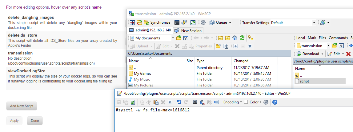

On 10/26/2017 at 7:18 AM, ken-ji said:
You are running out of file descriptors.... this is usually solved by running some commands before the docker is started
# sysctl -w fs.file-max=1616812
You can place this in the go file. I don't know if the Tips and Tweaks Plugin can set that for you.
Caveat: The number is the default max on my system and I never had to override it and I run Transmission with a bunch of seeds.
Tou can get the current value with
# sysctl fs.file-max
Got it! I used ssh for this, I can't find the Tips and Tweaks Plugin while...
On 10/26/2017 at 11:47 PM, trurl said:
The go file is in config folder of your flash drive. It is sometimes used to run code at boot since most things won't survive a reboot.
You could also do this with the User Scripts plugin.
I managed to get the User Scripts, but I'm not sure if I set it up correctly.
@sevenz no need to include the hash mark '#' as that's illustrative of the root shell prompt
otherwise the script will contain only a comment.
Also you need to start the script with this
#!/bin/bash
hash mark included, otherwise the script will fail to run (I think)
@ken-ji ah right, that will comment out the command. Alright I added it! Will report back if anything doesn't work properly.
