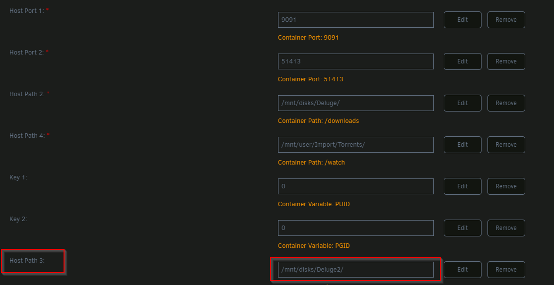

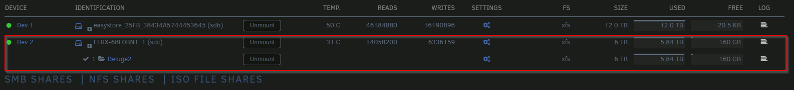

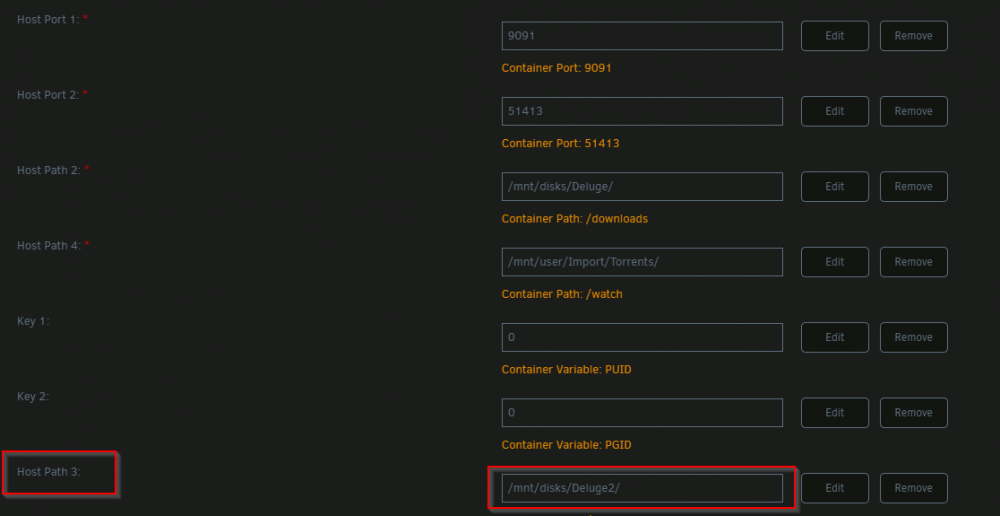

Hello! As of the last few versions, Transmission thinks it is out of space to download, when in fact it is not. This is the error when trying to download a 13GB file:
To explain where downloads 2 is:
521306812_2021-06-1917_09_42-REPOSITORY_Mainand6morepages-Personal-MicrosoftEdge.thumb.png.8a3d890742c0f6e4128de5524e586570.png
The same folder mapped on Windows 10:
Any idea what might be causing this?
Thanks,
~K
Thanks,
~K

Please disregard, it appears the issue is with unassigned devices.

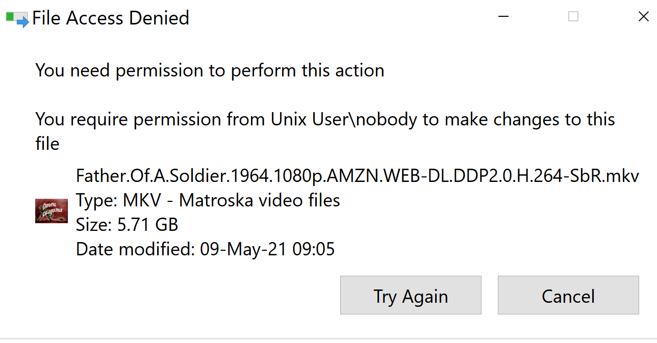

Hello,
I access Unraid via network mappings on Windows and every time something is downloaded by Transmission I need to use Winscp in order to move the files around, otherwise I have no access rights on the files. This does not happen with other dockers such as Sabnzbd for exemple. What did I mess with Transmission's settings?
Look in its appdata and see what settings.json has for umask
It says 2
What's next?

On 9/4/2021 at 4:29 AM, xtrips said:
It says 2
What's next?
Don't know, that works for me.
Is it a public share?
