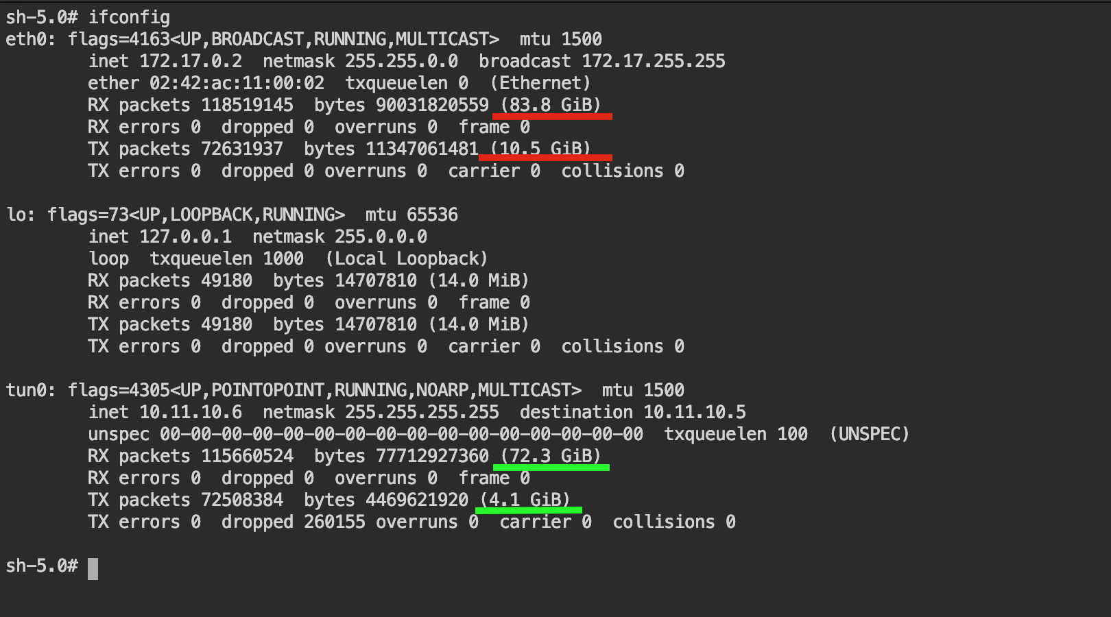

18 hours ago, l3gion said:
Hi everyone,
Maybe a stupid question, but can someone explain me why the eth0 and tun0 values diverge? Should't they kind be the same, since tun0 goes through eth0?
See attached image. This was from the binhex-delugevpn console.
Thanks.

1 hour ago, l3gion said:
Any idea anyone? @binhex maybe?
Thanks.
completely normal:-
tun0 = vpn traffic only
eth0 = vpn traffic (tunnel runs over eth0) AND all local traffic (web interface, api calls from sonarr etc).

Thanks for getting back to me. I imagined it could be all the local traffic on deluge. Now I'm just surprised at the amount of data transfered locally from the web interface, sonarr, radarr and jackett. 10gb download and 6gb upload over a couple of days 😅

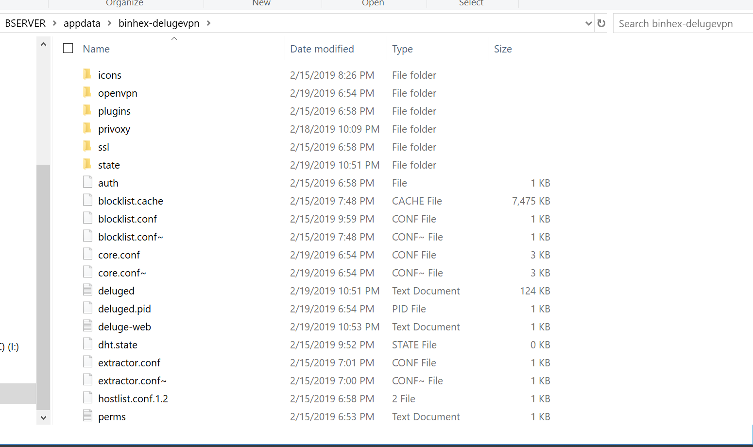

Here's my core.cong and a screenshot of my delugevpn folder (directory and duplicate files normal?).

yep so this is your issue, in the file core.conf line 59 to 62 you have somehow got the incoming port set to the same port number as the web interface, as in port 8112, so when deluge-ui tries to start it starts the web ui on port 8112 (separate process to deluge), then deluged reads the core.conf and attempts to set the incoming port to 8112, which it cant cos its already in use by the web interface and then blows up.
here is the misconfigured section:-
  "listen_ports": [
    8112,
    8112
so the fix is stop the container, and set it to the following, do NOT use windows notepad, use notepad++ or atom:-
  "listen_ports": [
    1234,
    1234
save the file and then start the container.
  "listen_ports": [
    8112,
    8112
  "listen_ports": [
    1234,
    1234
That did it. Thanks!
