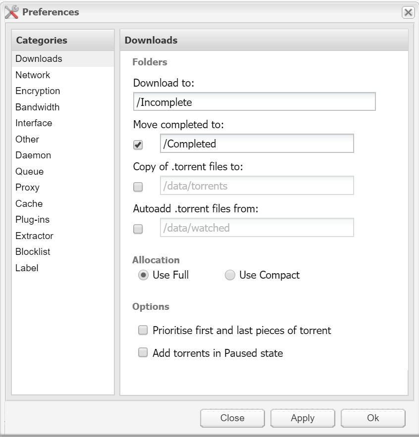

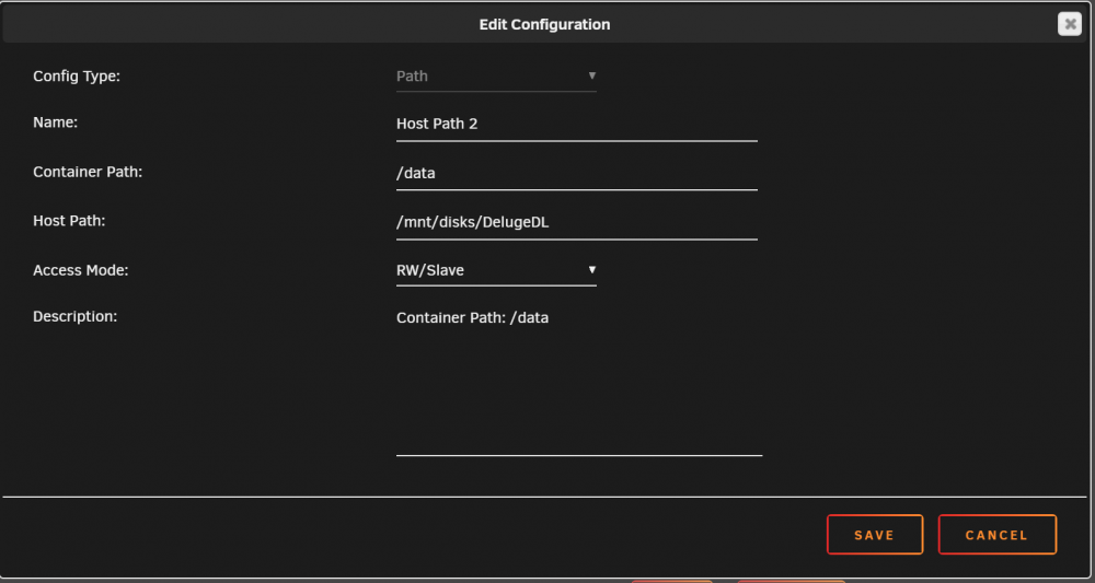

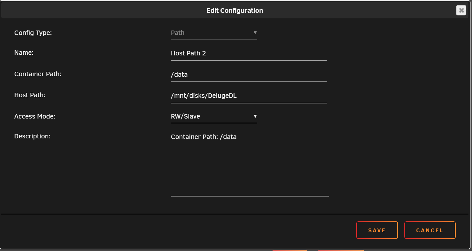

I just migrated my DelugeVPN folder from cache to an Unassigned Device. I got the existing files to seed, but I can't download to the new UD drive (I get an Error with 0 data downloading). Here's my volume mapping and preferences - something I'm missing?
@BBLV neither /incomplete or /Completed exist as volume mappings inside the container, change those to be /data/Incomplete and /data/Completed and you will be set.
Glad it was something so simple. Every time I hit a snag I learn something new!

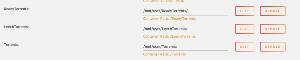

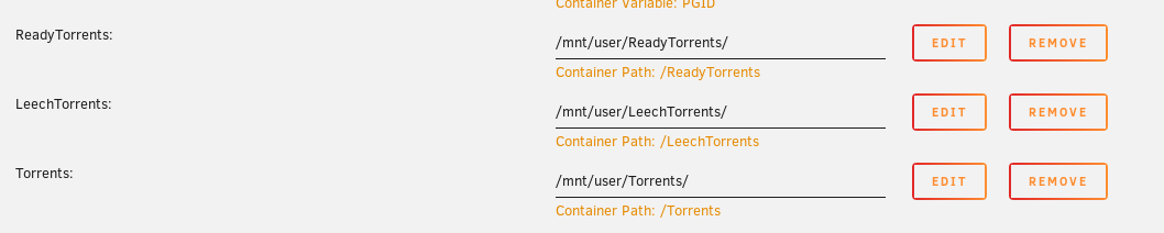

If you add new volume mappings to the docker container for /Completed and /Incomplete, then you can point them, individually, to anywhere accessible from your server, giving you total flexibility.
My volume mappings:
1242075142_Screenshotfrom2019-03-2108-59-38.thumb.png.95cdc66a3f481003dbf53005a195bccc.png
'LeechTorrents' are those currently downloading.  On completion, deluge automatically moves them to 'Torrents'. I then do some manual processing to extract the files I need after which I manually move the torrents to 'ReadyTorrents' from within deluge.
Edit: Disregard - spelling issue in my volume mapping! I need a coffee LOL
