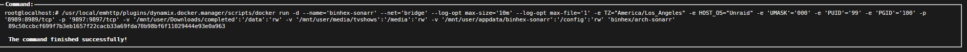

12 hours ago, WhatPlantsCrave said:
Just a quick bump to see if there is any help for my issues at the top of this page -- hope that's OK.   If bumps are not allowed I sincerely apologize.
Post your docker run commands for sonarr, radarr, nzbget and your torrent client.
Hey -- think I pulled the correct info -- let me know if I am looking in the right spot.  As a note I completely disabled torrents through Sonarr and Radarr in my attempt to fix this.
Sonarr:
Radarr (which seems to be running smooth after full reinstall):
NZBGet
Edit as a note:  I have been getting this notification in Radarr after the reinstall though, so maybe it is an issue with NZBGet instead?  It is still certainly sending the report to the download Queue which is interesting.
Edit 2:  I should add that Sonarr seems to still be sending requests to NZBGet just fine and is actually keeping up to date on all of my shows, even through last night.  Appears to only struggle accessing and moving them once complete.  I just pushed a few downloads through Radarr and I am curious to see if it moves them properly.
Edit 3: Unfortunately still running into issues with the cache drive filling up -- luckily I caught it just now before it hit 100% and started to spam the log and crash the system.  Seems Radarr and Sonarr both aren't moving the downloads off the cache once finished.
Aaaannnddd Edit 4:  I may have solved my cache drive issue after doing some further digging around and upping my min. cache space.  Seems to be helping with that issue at the very least.  If I can't figure out a fix for Sonarr I may do clean install similar to Radarr.
Edited by WhatPlantsCrave

14 minutes ago, trurl said:
Did you read the link?
Shore did -- but I guess I am not seeing in my own settings where there is an inconsistency in where it is directing the downloads to live.  I went ahead and added a new "Downloads Path" to each NZBGet, Sonarr, and Radarr anyways -- using /downloads as the container path and mnt/user/Downloads/ as the host path
You had one path set to /mnt/user/Downloads/ and one set to /mnt/user/Downloads/completed/.
All the paths need to be an exact match as described in the link that @trurl posted.
That was an (apparently a pointless) effort to dive deeper into the folder sub-system thinking that was the issue at first.  Radarr was not setup that way and was still throwing the error.  I removed /completed/ from Sonarr as well and it still throws that error.
I'll go through and re-adjust everything once more and run some tests.  Will keep you updated.
Edit: Sorry everyone for my idiocy -- we seem to be up and running now.  I appreciate each of you that took the time to help me work through this.
Then lets start it over again.  Post your new docker run commands from Sonarr and NZBget, along with the actual error reported by Sonarr.
Hey Squid -- you will see in my edit above I was able to get it all sorted.  I think I just had a bit of a brain lapse.  Thank you again to everyone who was able to help.

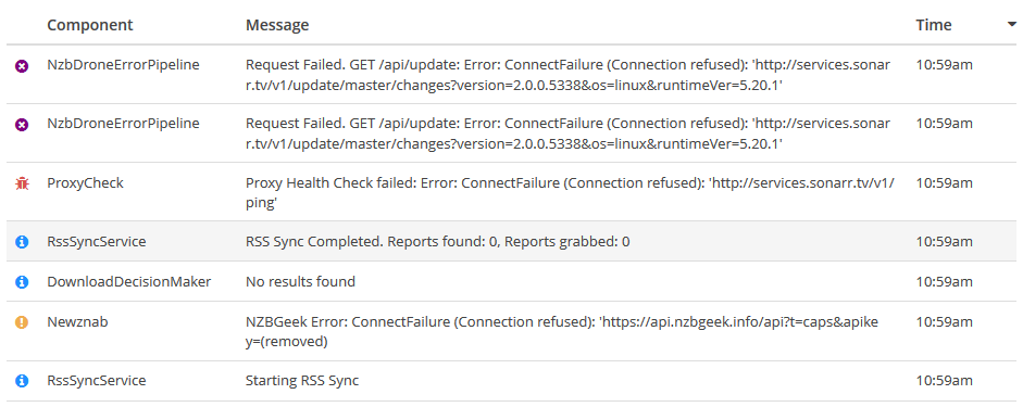

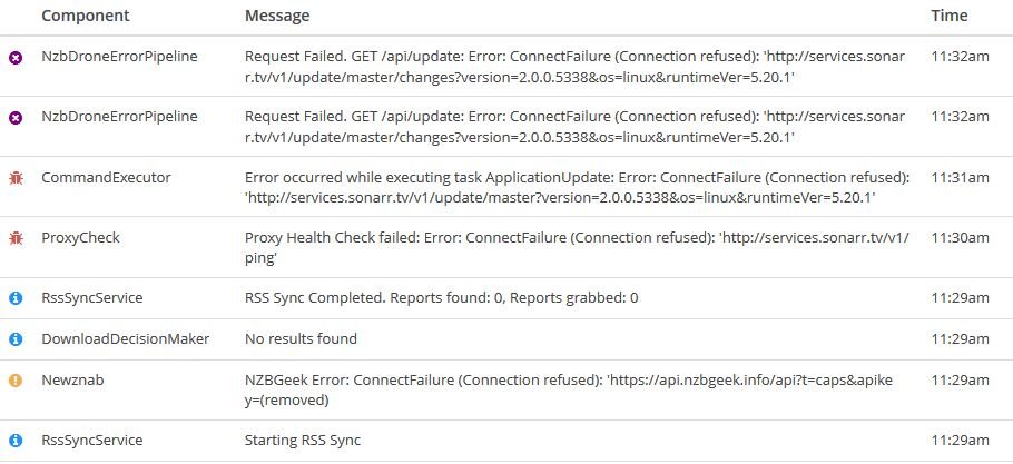

Everything worked properly until some time shortly after deploying pihole.  I'm now getting an error - but only from sonarr about connectivity:
System.Net.WebException: Error: ConnectFailure (Connection refused): 'http://services.sonarr.tv/v1/update/master/changes?version=2.0.0.5338&os=linux&runtimeVer=5.20.1' ---> System.Net.WebException: Error: ConnectFailure (Connection refused) ---> System.Net.Sockets.SocketException: Connection refused at System.Net.Sockets.SocketAsyncResult.CheckIfThrowDelayedException () [0x0003b] in /build/mono/src/mono/mcs/class/System/System.Net.Sockets/SocketAsyncResult.cs:134 at System.Net.Sockets.Socket.EndConnect (System.IAsyncResult asyncResult) [0x0002c] in /build/mono/src/mono/mcs/class/System/System.Net.Sockets/Socket.cs:1150 at System.Net.Sockets.SocketTaskExtensions+<>c.<ConnectAsync>b__2_1 (System.IAsyncResult asyncResult) [0x00000] in /build/mono/src/mono/mcs/class/System/System.Net.Sockets/SocketTaskExtensions.cs:35 at System.Threading.Tasks.TaskFactory`1[TResult].FromAsyncCoreLogic (System.IAsyncResult iar, System.Func`2[T,TResult] endFunction, System.Action`1[T] endAction, System.Threading.Tasks.Task`1[TResult] promise, System.Boolean requiresSynchronization) [0x00019] in /build/mono/src/mono/external/corert/src/System.Private.CoreLib/src/System/Threading/Tasks/FutureFactory.cs:538 --- End of stack trace from previous location where exception was thrown ---
Screenshot of most recent System/Status/Logs tab:
I suspect that something network-related is misconfigured either in sonarr, or pi-hole, but I'm not sure what that could be.
Steps I've taken so far:
  • Remove pihole as my DNS server on my router (Unifi USG). No change.
  • Restart sonarr.  No change.
  • Remove sonarr and re-install.  No change.
Pihole seems to be working properly, as do sabnzbdvpn, radarr and plex, and all other devices on my lan.
Any suggestions on troubleshooting would be really appreciated.

I'm guessing you have already done it, but have you restarted Unraid? I'm sorry for the "have you tried turning it off and on again", but you would be surprised at how many times people forget this simple task.
While you have a lot of dockers from Binhex here, it seems like a system error, you could try a simple ping from the terminal to see if the system is able to resolve a destination.
ping www.bluesnews.com -c 2
I would of guessed it is something like a cached DNS issue, hence the reboot suggestion, but unless it has been added by Lime Technology, I do not think Arch uses a cache. However it has been many years since I used any distro in a great depth.

Problem resolved.  I had not restarted Unraid, but we had a thunderstorm last night, and the power went out.  I don't have my server on a UPS yet, so it power cycled.
The root cause was a misconfiguration in the proxy port for Sonarr.  I had it set for 8181 instead of 8118.  Comparing the configuration data between Sonarr and Radarr helped me find it.
I think there was an issue with pihole initially, and restarting Unraid would have resolved the issue, but because I removed/reinstalled/reconfigured Sonarr - and didn't have the proxy port set correctly, restarting Unraid didn't resolve the issue.
I'm good to go now - all dockers are working properly.

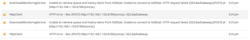

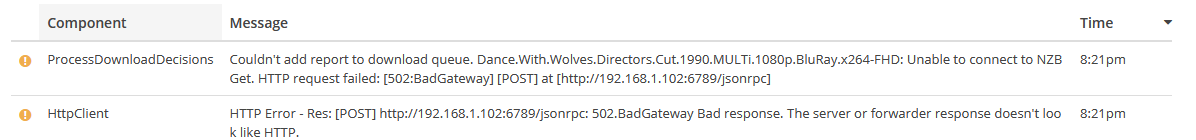

Trying here since I haven't seen any movement in the Radarr thread.
Hey Again,
I always seem to be bumping into some error or another and can't quite get to 100%.
Lately I have been gettting this error in both Radarr and Sonarr.  When I "Test" NZBGet it says its working fine, and both Radarr and Sonarr are sending NZBs to NZBGet, but apparently having trouble seeing the queue and history.
Radarr:
Sonarr:
Any help would be greatly appreciated.  If logs are helpful I can drop the rest in.

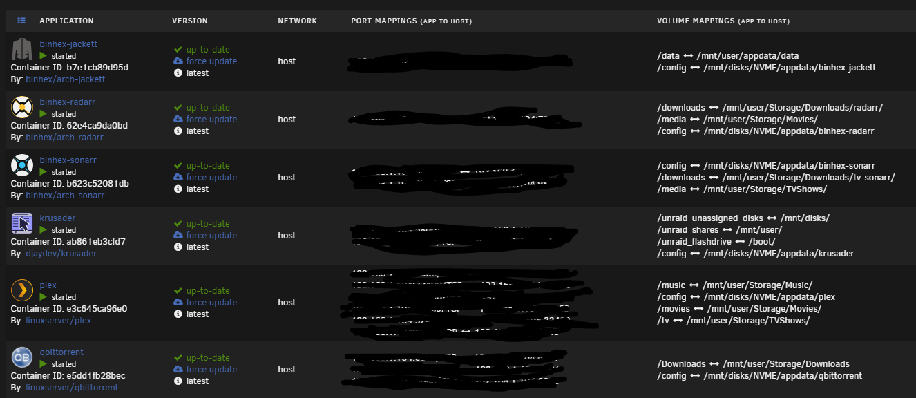

I am new to Unraid and Dockers in general and recently setup a new server and moved all of my storage over. I currently have the following configuration/setup.
Dell R720XD
2xE5-2670v2 CPU
128GB RAM
H310 IT Mode
4x8TB WD White Labels (3 + 1 Parity)
2 x 256GB Intel SSD (Cache)
1 x 800GB Intel NVME PCI SSD (VMs & Dockers)
My media all exists on /mnt/user/Storage    my cache is on /mnt/cache    and my NVME is on /mnt/disks/NVME   - this all seems to be working well.
I have installed the Plex, Sonarr, Radarr, Jacket, and QBitTorrent containers and have each of them up and functional. My issue appears to be the container paths and permissions to get them all talking to one another correctly. Below is a screenshot of my container paths. I want all of my Downloads to go to /mnt/user/Storage/Downloads and then to sub folders of radarr and tv-sonarr respectively. I would then like those two apps to pick them up, rename them, and move them to /mnt/user/Storage/Movies and /mnt/user/Storage/TV Shows respectively and then trigger an email through my Exchange server and update Plex.
In QBT should I have the downloads going to just /downloads   or do I need to specify /mnt/user/Storage/Downloads? No matter which I set it to neither Sonarr or Radarr can access or find the file(s) upon completion with the message    "Import failed, path does not exist or is not accessible by Sonarr"
I just switched over from Hyper-V where I had everything pretty much running under Windows/Ubuntu VM's and everything was working well there.
Any help would be appreciated thanks!
