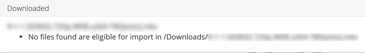

1 hour ago, CJston15 said:
In QBT should I have the downloads going to just /downloads   or do I need to specify /mnt/user/Storage/Downloads? No matter which I set it to neither Sonarr or Radarr can access or find the file(s) upon completion with the message    "Import failed, path does not exist or is not accessible by Sonarr"
Containers don't know anything about the Host paths, they just know about the container paths. Sonarr has a /downloads path mapped to /mnt/user/Storage/Downloads/tv-sonarr. It doesn't have access to the folder above that, /mnt/user/Storage/Downloads, because it isn't mapped. The application sees /downloads as a root level folder with nothing above it. Similarly for your Radarr mapping.
See this post in the Docker FAQ:
https://forums.unraid.net/topic/57181-real-docker-faq/page/2/#comment-566086
Might be instructive to browse the other posts in the Docker FAQ.

I resolved my issue. I was over-complicating the container and host paths. I just mirrored the mappings for all 3 applications and simply used /data/ to map to /mnt/user/Storage/     and then each application had the necessary access to the sub folders within that.

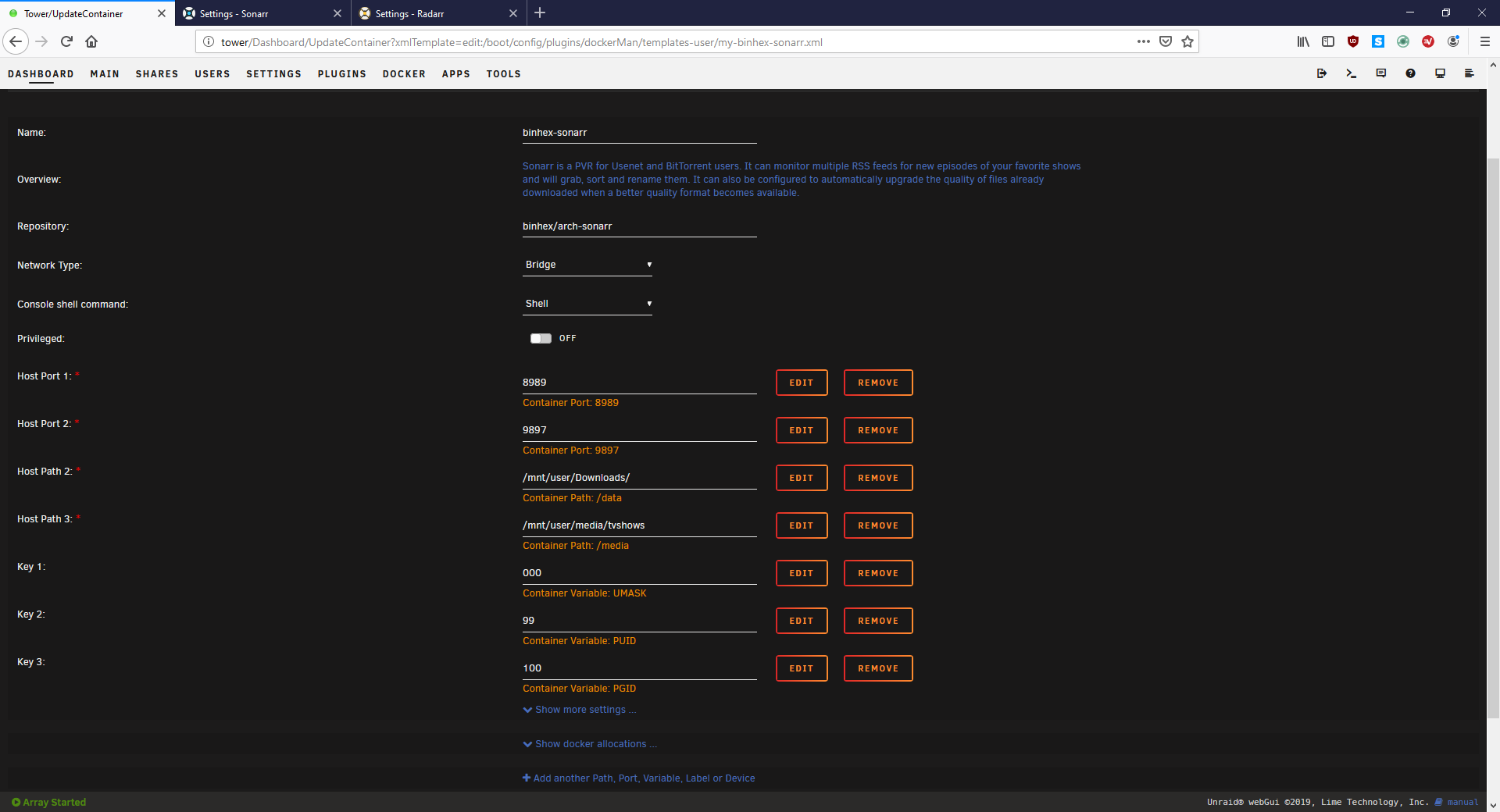

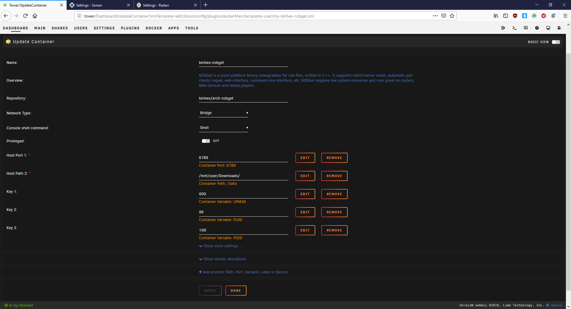

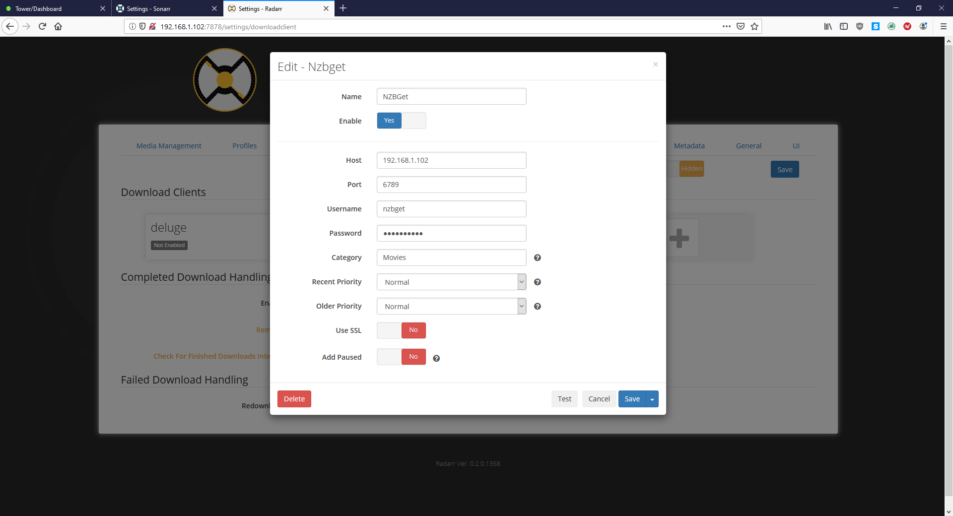

On 9/5/2019 at 2:28 AM, WhatPlantsCrave said:
Trying here since I haven't seen any movement in the Radarr thread.
Hey Again,
I always seem to be bumping into some error or another and can't quite get to 100%.
Lately I have been gettting this error in both Radarr and Sonarr.  When I "Test" NZBGet it says its working fine, and both Radarr and Sonarr are sending NZBs to NZBGet, but apparently having trouble seeing the queue and history.
Radarr:
Sonarr:
Any help would be greatly appreciated.  If logs are helpful I can drop the rest in.

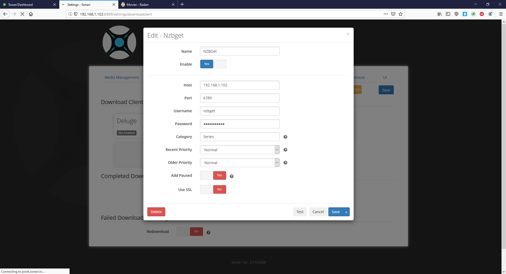

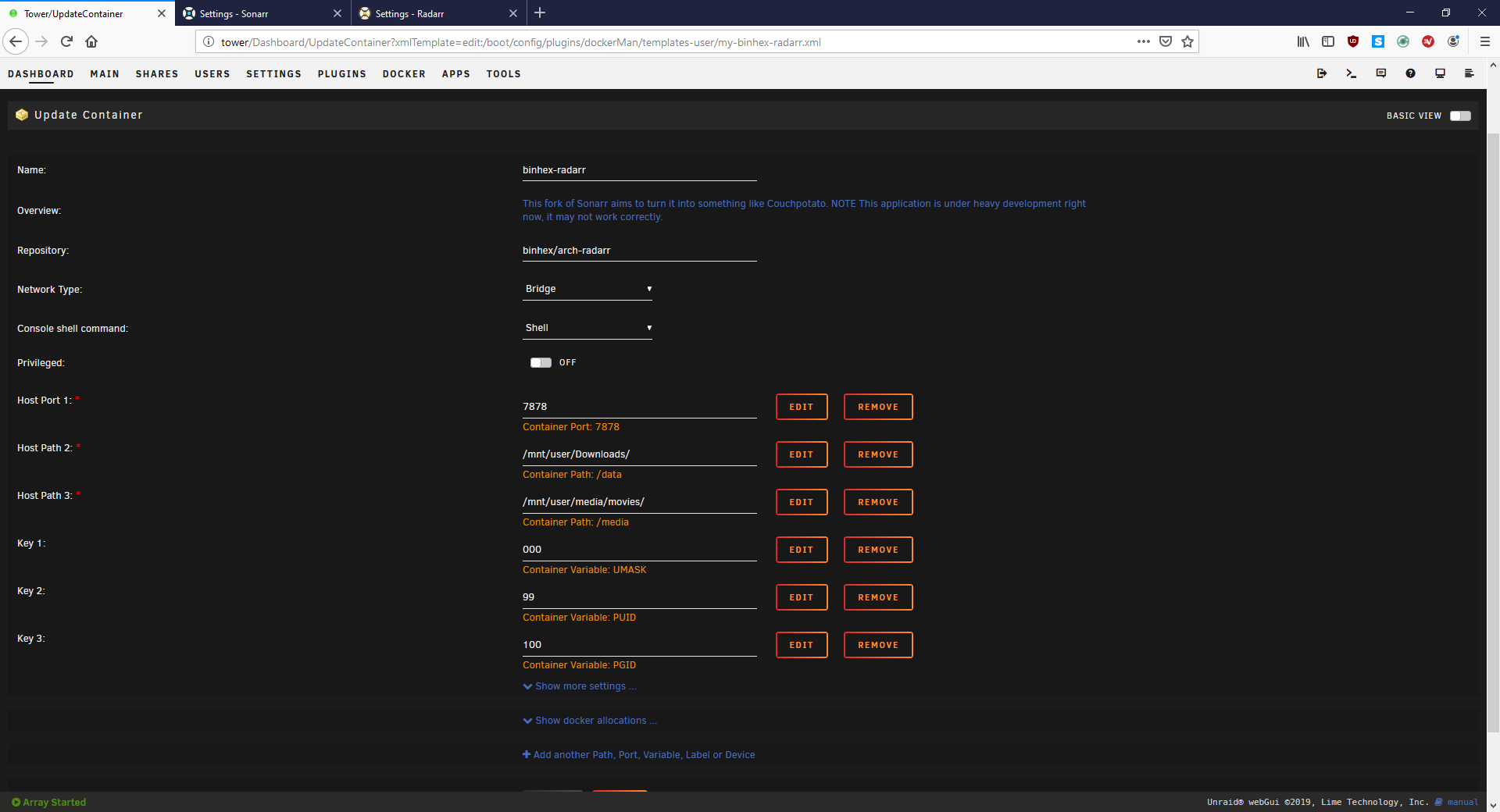

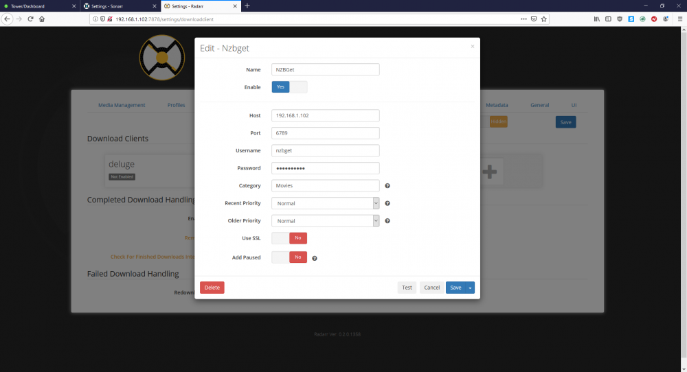

ok lets start with some screenshots of radarr and sonarr web ui config screens for nzbget, also can you post screenshots of the 'edit' screen for nzbget, sonarr and radarr, i want to see network config for all of them.
No problem, appreciate the support.  Let me know if there is anything further I can provide once you have reviewed these.
sorry for the delay on this, ive been ill recently so bit behind on support. so onto this, your screenshots look fine to me, nothing obvious, so i would suspect some sort of networking issue, are you using a custom bridge of any kind for any of the containers?, or a macvlan, or have any vlan's setup?. other things to think about is do you use a proxy of any kind?, could it be the proxy is down causing the 502?

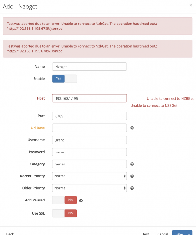

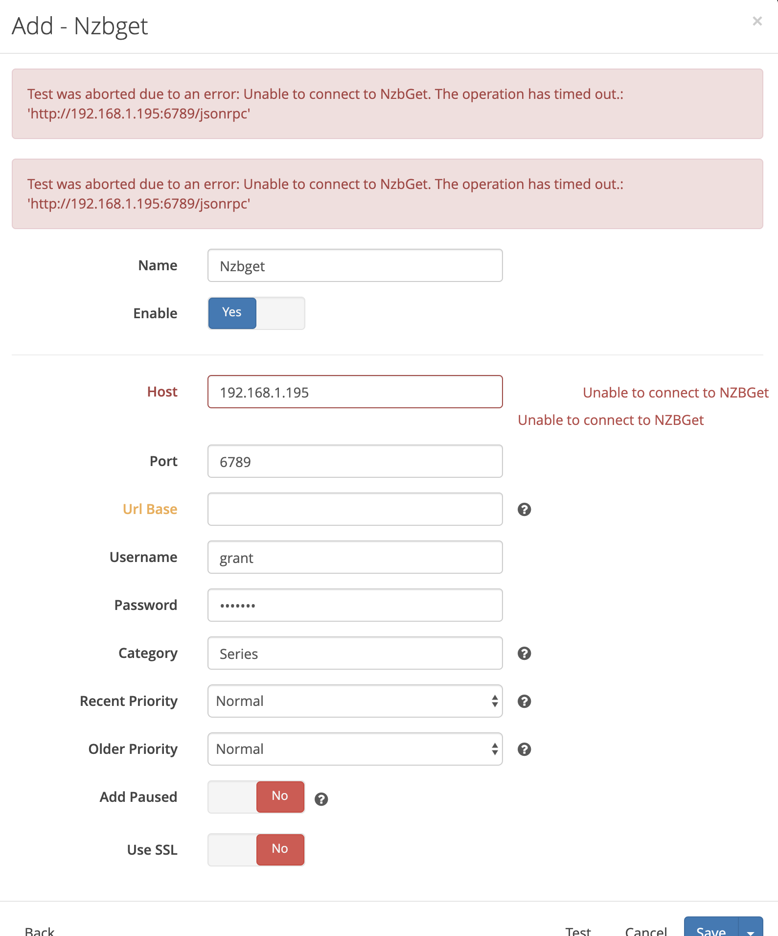

Im trying to switch from Sab (which is consuming a lot of CPU resources) to NZBget.  I can not get sonarr to test the connection successfully.  It takes a very long time and then I get the error Test was aborted due to an error: Unable to connect to NzbGet. The operation has timed out.: 'http://192.168.1.195:6789/jsonrpc'.  It seems to be it is tying to connect to the correct location and port, but it is adding /jsonrpc for no reason.  This shows in the hint on the url base line.  I do not understand what this line is for, and feel it should be left blank in my case.  Any help resolving this would be greatly appreciated.

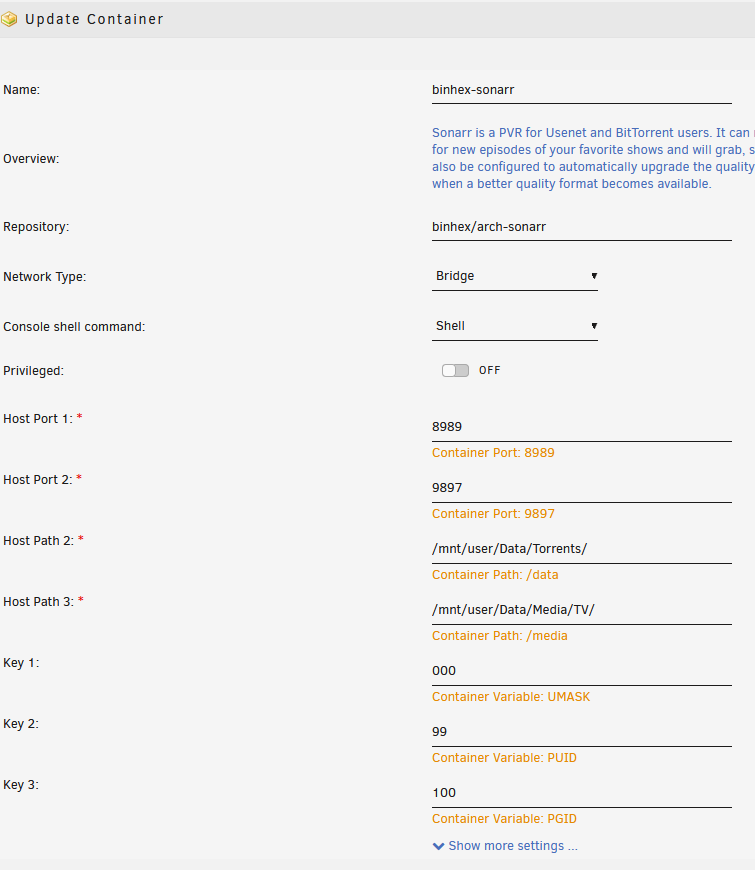

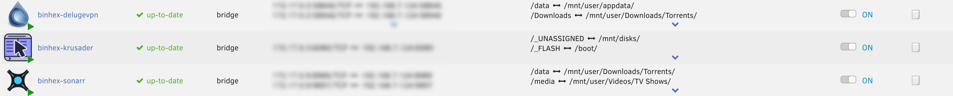

Trying to setup Sonarr tonight and ran into this issue with the first show I downloaded. Don't I have the paths setup right? Is there something else I'm obviously missing that's not moving it over?
1754496056_ScreenShot2019-09-30at22_00_09PM.thumb.png.e96cc5ceb1f71c0a30ced77b13a69f48.png
1346788802_ScreenShot2019-09-30at22_07_36PM.thumb.png.12efcb856b449b07f83a09b6d0e9e875.png
You have /data set wrong in DelugeVPN. Set it to exactly match Sonarr. /config is your appdata path.
Thanks! That was definitely it. Once set right it worked. When it's moved, can I set Sonarr to delete the file from my torrent direcotry and the torrent in Deluge? I've tried looking around but didn't find anything. It looked like it was still there when I went and looked later after it was moved.
