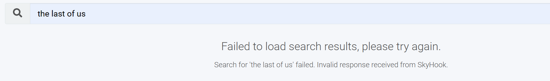

Okay. Simply going to "Series", "Add New".  Type Black Sails (or anything, actually) in the search box and the error pops up immediately. It's even been failing on the first letter "B".
Failed to load search results, please try again.
Search for 'B' failed. Invalid response received from SkyHook.

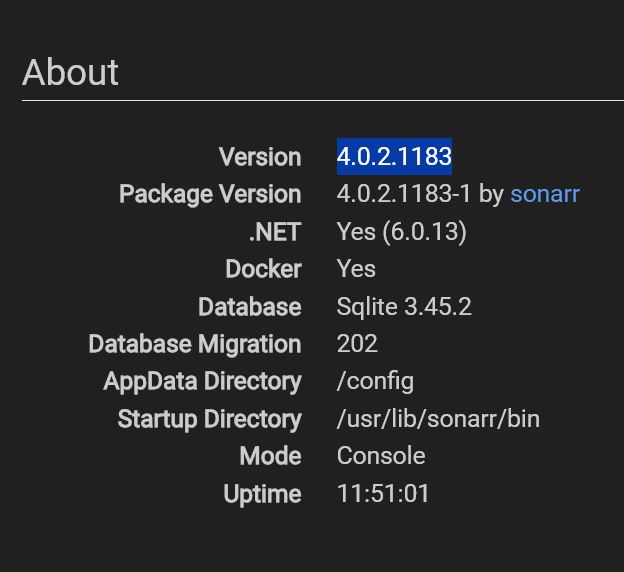

The information I posted was directly from the System Tab in Sonarr
7 minutes ago, Moose_Flunky said:
Version
3.0.4.1126
that is a very odd version! same as the other guy, i have never produced that version, or at least i have no image tagged with that version, the current latest version is Sonarr 4.0.2.1183:-
