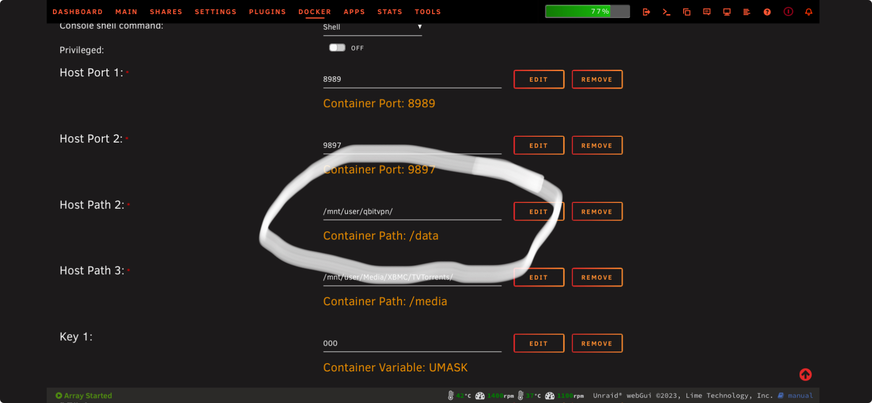

Where do I change the paths in the new Sonar? I keep getting an error: [Error] DownloadedEpisodesImportService: Import failed, path does not exist or is not accessible by Sonarr: /data/Complete/
I have gone through every screen but I can't find where I can change the path. I tried editing the container but I can't find a path to data.
Thanks

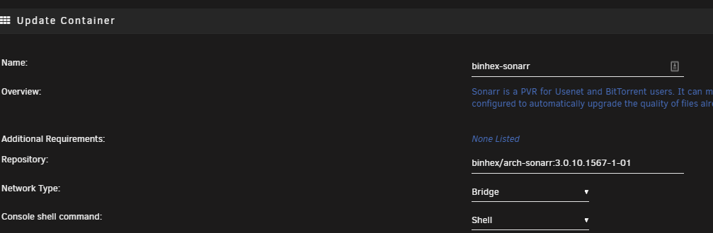

  • So, Sonarr v3 is FINALLY here, its out of beta and is now the latest release, if you want to switch from Sonarr v2 to v3 then simply pull down the 'latest' tagged image.   However, if you wa
  • @SavagelyCalm I have the same problem.   Edit your Docker repository link to this "binhex/arch-sonarr:v3" and it'll re-download a working version.  Worked for me.
  • Yep, it was a dodgy sqlite version in the end that caused the issue, all fixed, please revert back to latest.
Thanks
It’s going to be /data in the container path and the host path will be something like /mnt/user/path/to/downloads.

On 1/5/2024 at 11:40 PM, NeoJoris said:
I have the same error as @boianski
I tried the sollution by @bobobeastie but not succesfull.
Also tried to delete the database, and try to recover it from a backup but also not succesfull.
Also tried another docker but also not succesfull..
I really dont want to set-up a fresh docker, all the settings are also in this database and not in the config.xml...
Does anyone know how to install a earlier version of this docker so i can use the built-in restore to backup my settings?
Ive done a rollback to repository binhex/arch-sonarr:3.0.10.1567-1-01 Managed to restore my settings and database, via the build-in restore function and a scheduled backup file
Have the same issue.
Cleared the log and sonarr dbs (clearing the sonarr db allowed sonnar to start without issue). Tried to restore from a backup and the issue reappeared.
Also has to revert to version 3.0.10.1567-1-01 to fix.
Hello. I'm having the same issue as others on here. Getting the EPIC FAIL issue with a corrupted database. My brother helped me build this server over 6 years ago and while I can do generic troubleshooting I don't know how to do certain things. Can someone provide me a step by step they did to get this resolved? I removed the docker and I checked to also remove image. Do I have to delete the app data folder as well before reinstalling? How do I rollback if I need to?
I attached logs if needed.
sonarr.txt
@xhonestly Sorry for the late reply.
Only try this if you have a backup of your old databasefile (via manual backups or appdata backup plugin)
Steps:
  1. remove docker image
  2. remove (specific) appdata folder
  3. install older version of this docker (see attached image)
  4. after stopping the newly made container (I had an backup of the database file) move the old database file into the new folder
  5. (only necessary if backup has been stored elsewhere) run DockerSafeNewPerms via tools tab
  6. (re)start the container
Good luck!
