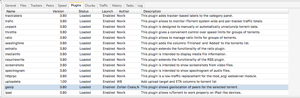

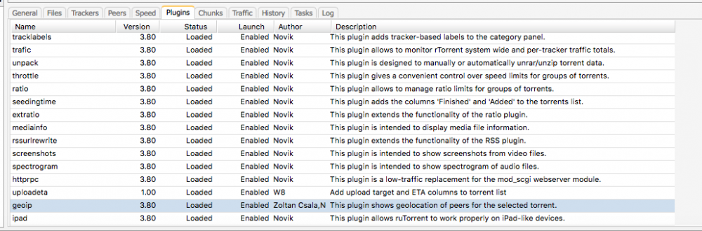

Thanks.  There is an rutorrent folder in appdata and I believe that the plugins go in /rutorrent/plugins or more fully: /var/www/rutorrent/plugins
The plugin that I specifically want to see installed is geoip which shows the country name and flag as in the image below.  I don't know that there is even any config to do for this plugin.
(edit - To be honest, I am not sure anyone would NOT want this plugin.  Maybe we can have it made part of the core rutorrent docker?)
Edited by wayner

14 minutes ago, wayner said:
Thanks sparklyballs.  Following on a bit from my discussion a few weeks ago - is it possible to get the geoip plugin for rutorrent added to the docker image?  It seems to be in the main github repo for rutorrent located here:  https://github.com/Novik/ruTorrent/tree/master/plugins
me and the rest of the linuxserver team have clubbed together for an appointment with an optician for you lol

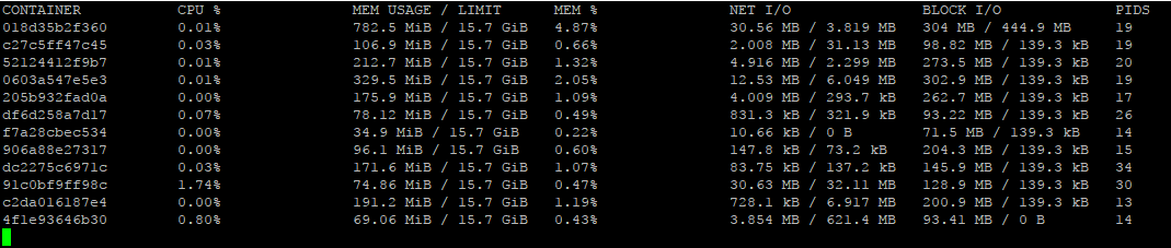

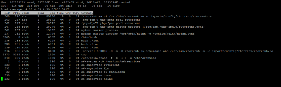

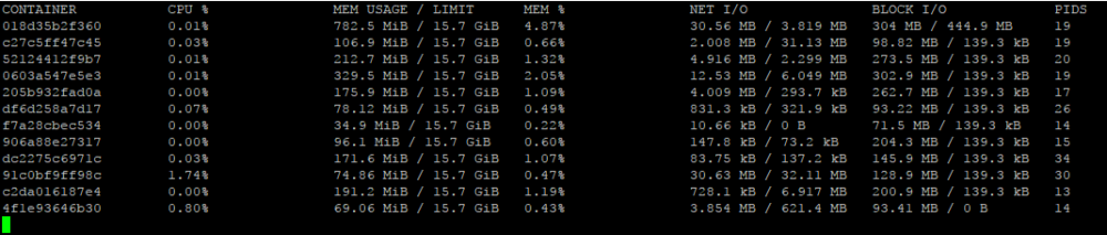

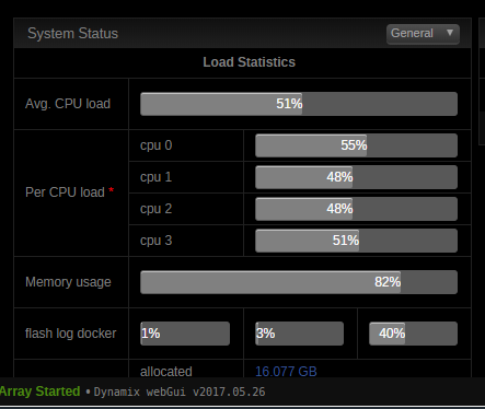

New question.
The CPU indicator is showing 100% usage, but my processor is running at ~50%. I docker exec'd into the container and it doesn't seem to be showing high usage either.
Is this indicator not accurate or is there some underlying problem that needs to be addressed.
Docker stats doesn't show too much either
Any help is greatly appreciated
