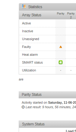

Installed over the top of 6.1, everything seems to work fine.  But my Dockers say they all need updating so I'll do that over time.  Also found this little random "are" in the dashboard page.  See attached
... Also found this little random "are" in the dashboard page.  See attached
fixed in next release. thx
