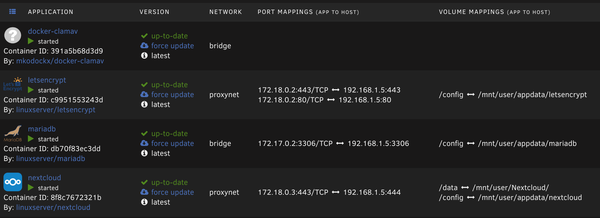

@Niklas Could you offer any help on setting up that Clam AV docker? When I install it here is what I end up with:
1194254299_ScreenShot2019-10-30at5_08_34PM.thumb.png.3e8f75a399701051f07ba10bf4b300b2.png

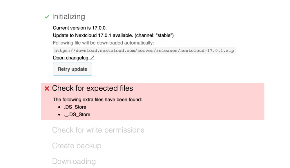

4 hours ago, Smooth Beaver said:
I received a notification that 17.0.1 is available. Are we supposed to wait for a docker container update or can we use the built in Updater?
When I tried to use the updater I get this error:
253334466_ScreenShot2019-11-08at10_54_08PM.thumb.png.e1b09b4dc33dabd20699960679e8a108.png
Where exactly is it looking for to find those files so I can remove them..
Update the container first if it's not up to date, then update through the webui. If that fails, go to the first post and go to the link for updating using command line.

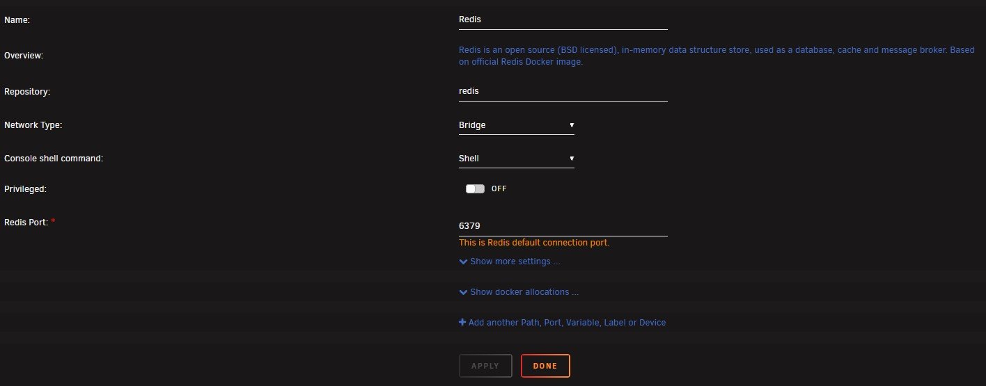

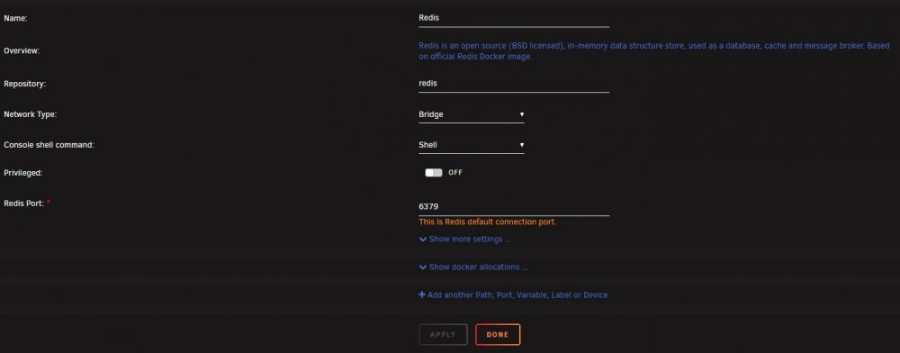

On 11/4/2019 at 11:11 AM, Ustrombase said:
Does anyone have redis installed?
I do, and only have the connection port set in dockerMAN. These are the settings I added to the Nextcloud config.php:
  'filelocking.enabled' => 'true',
  'memcache.locking' => '\\OC\\Memcache\\Redis',
  'redis' =>
  array (
    'host' => '10.66.0.10',
    'port' => 6379,
    'timeout' => 0.0,
Link to post

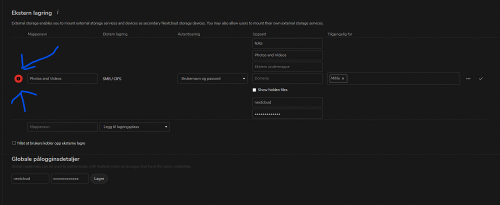

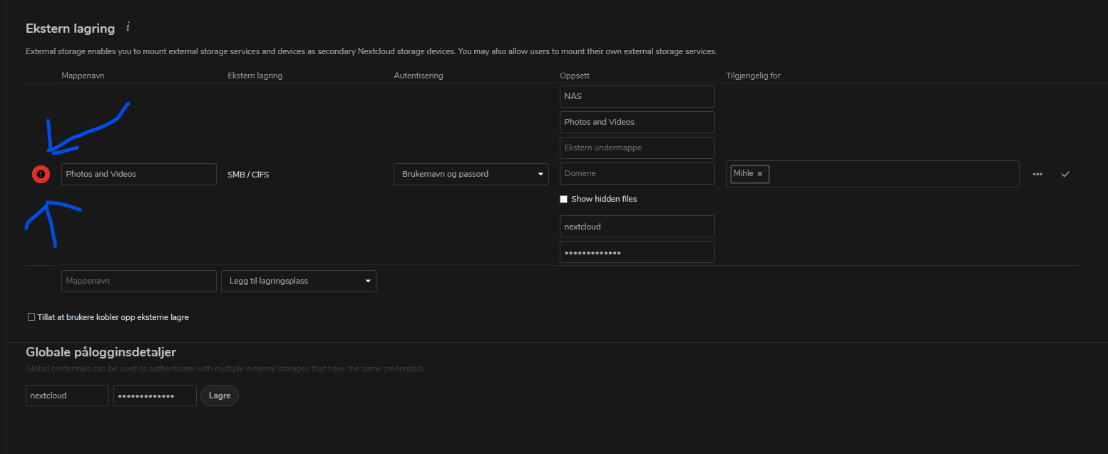

So I updated from 16.04 to 16.06 and got an issue.
Everything seemed like normal except I could not share with link from stuff that is external storage.
Found out the allow share setting was turned off after the update, so I tried to activate it again.
But no, error symbol but it does not tell me what the error is!
Then I tried to remove it to then add it again, but I cant add it again because the same thing happens! It just shows an red ! but doesnt say why! its exactly how it was when it worked before the update....
holding over the ! doesnt showing it, clicking on it doesnt show anything! Anyone know why?
In worst case, can I revert back to 16.04?
Link to post
  'redis' =>
  array (
    'port' => 6379,
    'timeout' => 0.0,
What do you mean port set to dockerMan? Secondly, how do you know if there is improvement by using redis? What would be noticeable?
