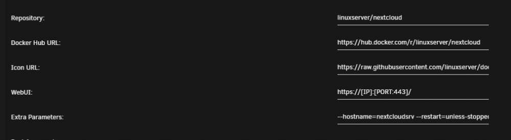

Hi, can we rename the machine in nextcloud?
Under Settings>Administration>System, could we change the machine name? (the d2dd33036abf?)
Add "--hostname=xxxxxx" in "Extra Parameters" for the container ("ADVANCED VIEW" on)
Edited by Niklas
9 minutes ago, Niklas said:
imageproxy.php?img=&key=e5eec7c5c933ca16
Thank you, got it working.
