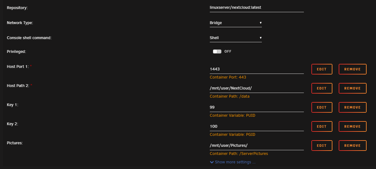

9 minutes ago, Niklas said:
imageproxy.php?img=&key=e5eec7c5c933ca16
Add "--hostname=xxxxxx" in "Extra Parameters" for the container ("ADVANCED VIEW" on)
Thank you, got it working.
Any clue about the cpu part? is it listing by thread?
Share this post
Link to post
No clue. Mine looks like this:
Edited by Niklas
Share this post
Link to post

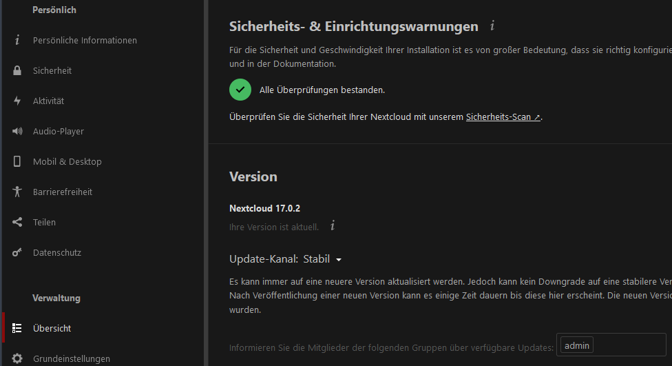

2 hours ago, patm95 said:
How do you upgrade to 17?  I have updated my docker and it is still on v16.
Updating the docker is not updating nextcloud itself. Login with an admin account and go to the settings >>> overview ("Übersicht" in my case on the left side) and you should see your current version and a hint if a newer version is available. From there you can start the update/upgrade process
Share this post
Link to post
I had always thought we were supposed to update an application outside of the docker. Thank you!
