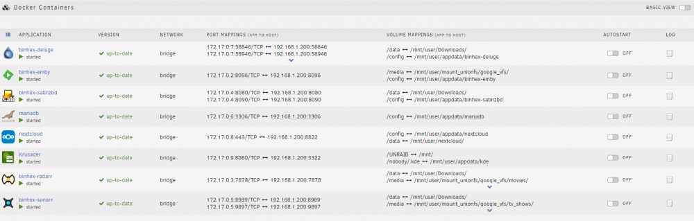

I was able to generate correct SSL certificate. For some reason I had to reset my port forwarding on the FIOS gateway. Strange that I had to do that as it was working before with no issues.  Letsencrypt is all good, with no more errors reporting a valid new certificate. However, the websites still display  Not secure  with  Certificate error.  How can I correct that?
And, the only way I can get into the nextcloud is by modifying the following line in the config.php to include the port:
  'overwritehost' => 'domain1.duckdns.org:444',

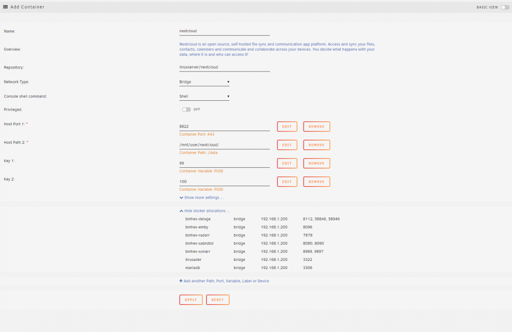

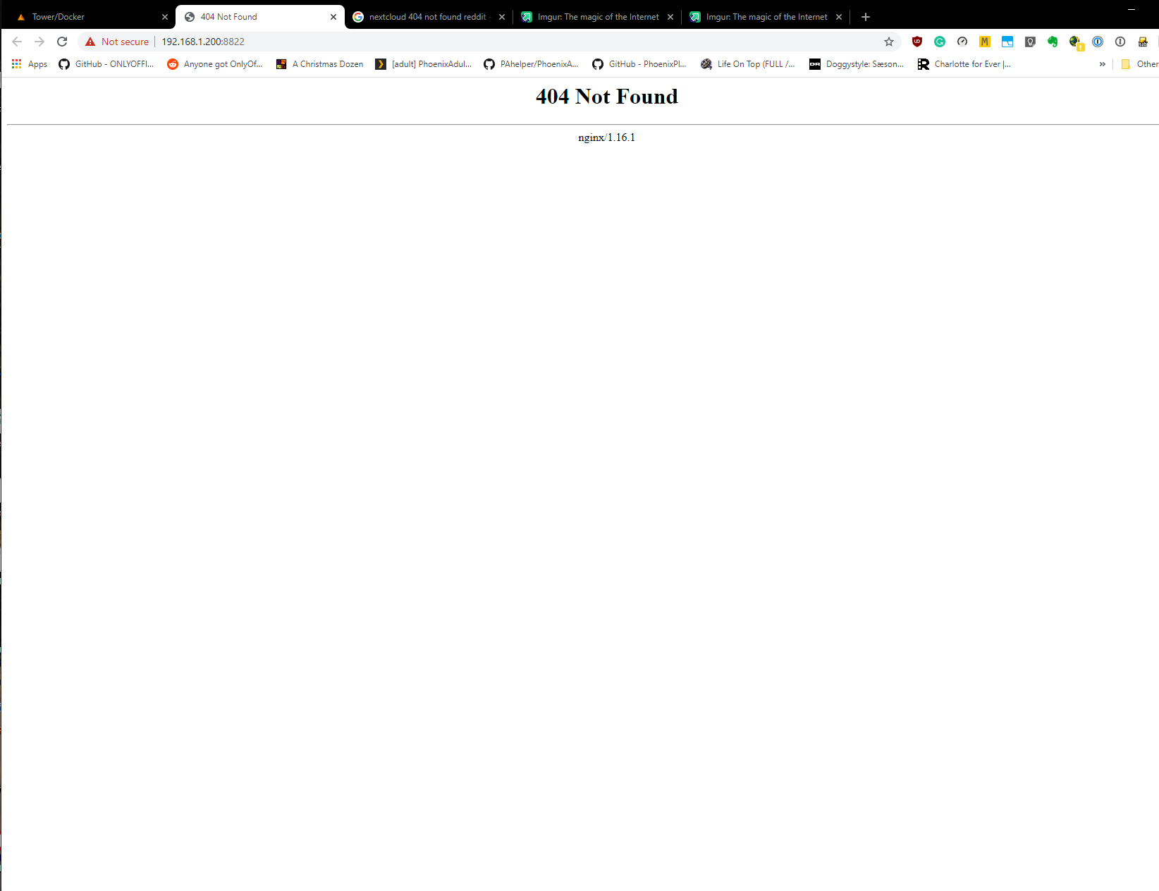

Hello guys,
I installed Nexcloud from the community apps and in the docker template I changed the port from 443 to 8822
Now when I click on open WebUI a white page comes up that says "404 Not Found" and right below that error code "nginx/1.16.1"
I am just trying to use next cloud without lets encrypt or anything like that... I just want to open the nextcloud page to set it up but I cannot get to that page
My unraid server is updated to latest version and every docker is working great except for this one.
I also tried changing the port to 444 which every video i watched had that...still same 404 error message !!
any ideas?
Edited by livingonline8

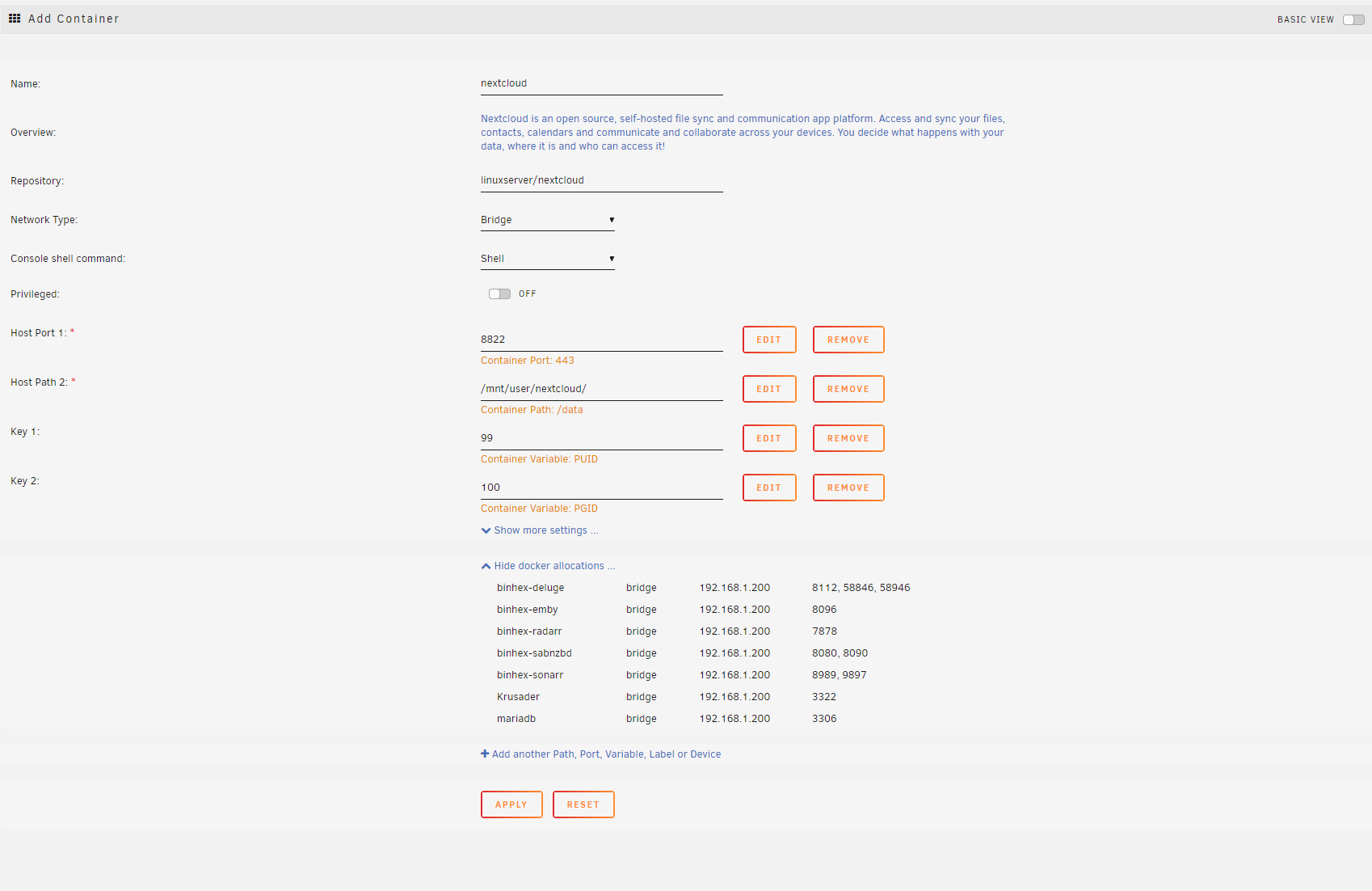

Here is a picture of the setup... I simply followed spaceinvader video but I keep getting the white 404 error page !!
I am sorry but I dont exactly know what do you mean host port and container port so I attached those images for you to see
nc2.thumb.PNG.9a568e7457c20dafb1f521aacd322b6e.PNGnc3.thumb.PNG.f80b0bd5f19f83b8e6afc0acfe126cf4.PNGncissue.thumb.PNG.73fb92a6bc94bf8ceabfd6bed305cc35.PNG
Any ideas please?

3 minutes ago, alturismo said:
does /mnt/user/nexcloud/ exist ?
if so, may start from scratch by uninstall docker, wipe /mnt/user/appdata/nextcloud ... your port settings from start (changing inside too) may screwed something, just change the host port like described ...
and to get better help from the pro´s here, docker run command (when u install the docker or change some value)
logs from nextcloud docker may also be helpful ...
First, Thanks a lot for your reply... I am really lost here and I dont know whats wrong !!
Here are the answers to your question:
1- Yes, /mnt/user/nexcloud/ does exists, I created it before I install the docker !
2- I tried uninstalling the docker many times, and before installing it again I delete the nextcloud folder in the appdata by using MC in terminal.
3- I changed the port as described above
nothing worked !!
Can you tell me how can I get the nextcloud logs so I can attach them here?

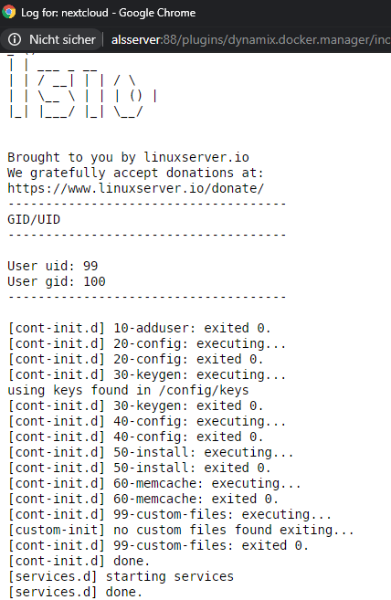

22 minutes ago, livingonline8 said:
Any ideas please?

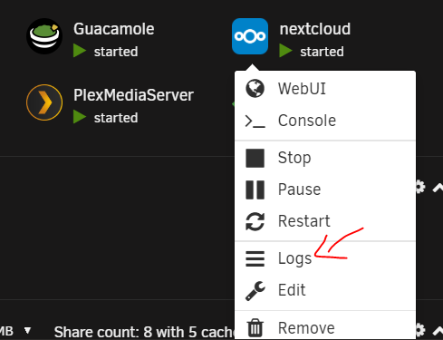

Had excactly the same Problem before 10 Minutes. It seems like a Problem in the latest release. If u install via Community Plugin then change the Repository to : "linuxserver/nextcloud:17.0.2-ls58" :)
click the nextcloud icon
then something like this should appear ...
Oh ok,
here is what I got when I clicked on logs for nextcloud
Brought to you by linuxserver.io
We gratefully accept donations at:
https://www.linuxserver.io/donate/
GID/UID
User uid: 99
User gid: 100
[cont-init.d] 10-adduser: exited 0.
[cont-init.d] 20-config: executing...
[cont-init.d] 20-config: exited 0.
[cont-init.d] 30-keygen: executing...
using keys found in /config/keys
[cont-init.d] 30-keygen: exited 0.
[cont-init.d] 40-config: executing...
[cont-init.d] 40-config: exited 0.
[cont-init.d] 50-install: executing...
tar: This does not look like a tar archive
bzip2: invalid magic
tar: Child returned status 1
tar: Error is not recoverable: exiting now
chmod: cannot access '/config/www/nextcloud/occ': No such file or directory
[cont-init.d] 50-install: exited 0.
[cont-init.d] 60-memcache: executing...
cp: cannot create regular file '/config/www/nextcloud/config/config.php': No such file or directory
chown: cannot access '/config/www/nextcloud/config/config.php': No such file or directory
[cont-init.d] 60-memcache: exited 1.
[cont-init.d] 99-custom-files: executing...
[custom-init] no custom files found exiting...
[cont-init.d] 99-custom-files: exited 0.
[cont-init.d] done.
[services.d] done.
That actually fixed the problem!! :)
Thank you, Also Thank to everyone was trying to help
