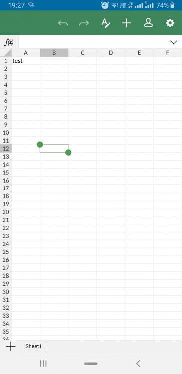

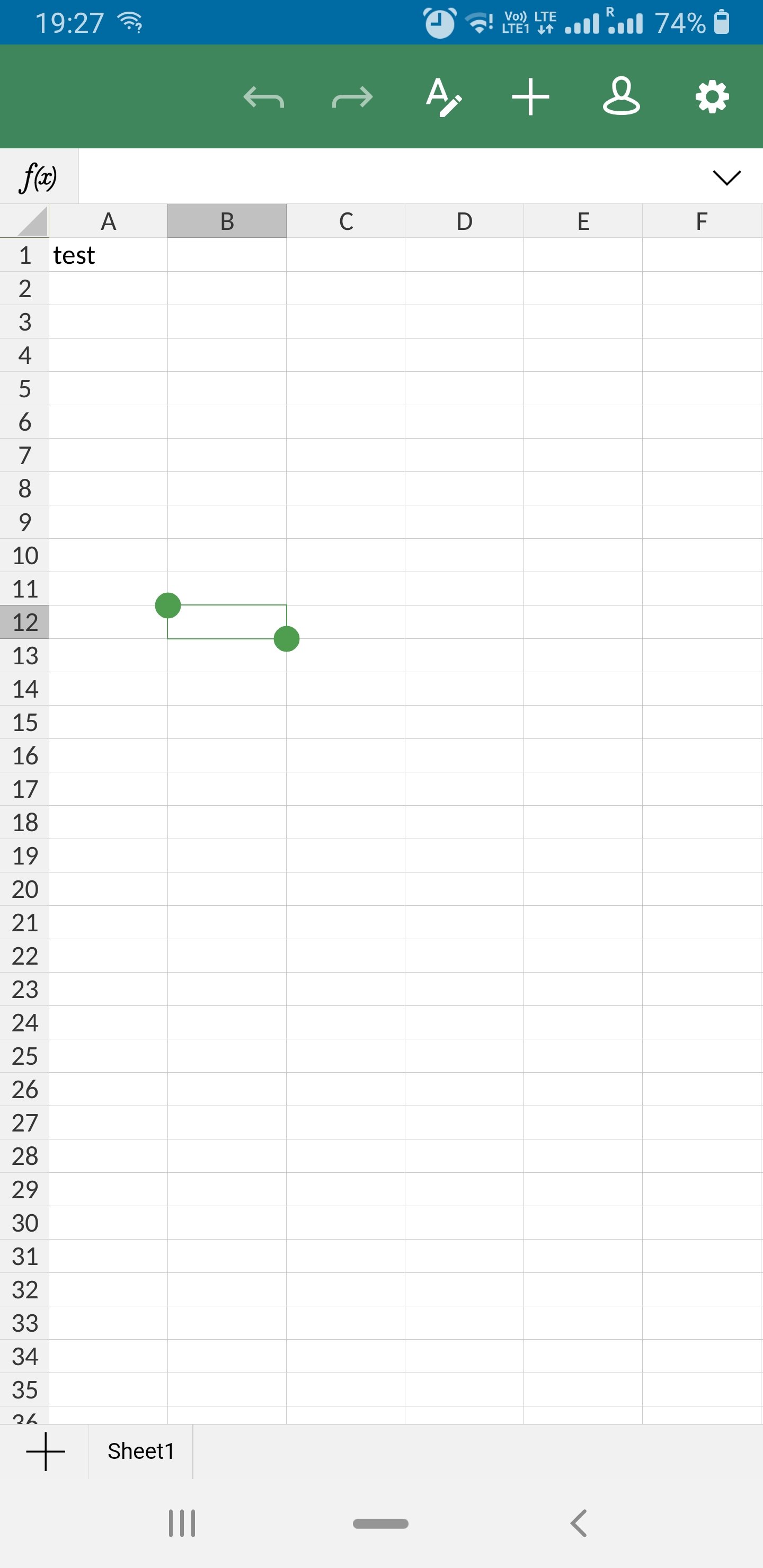

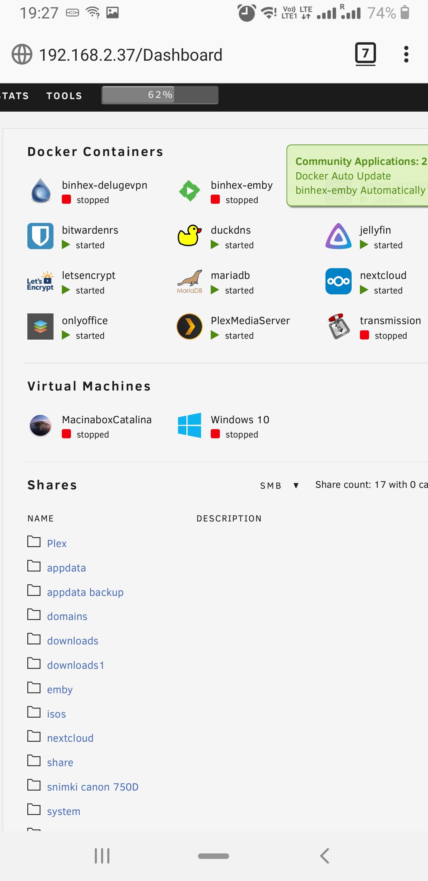

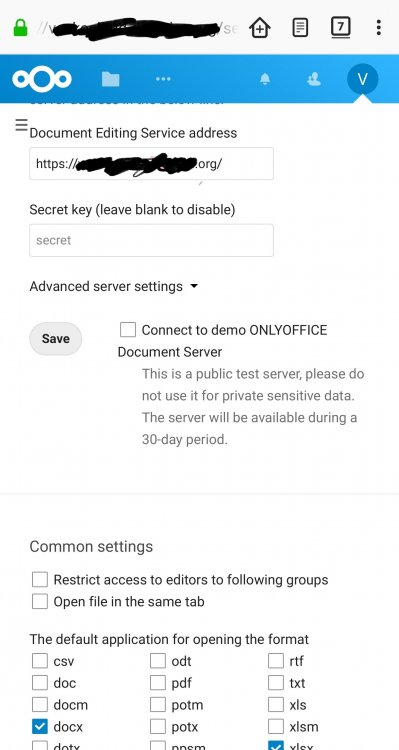

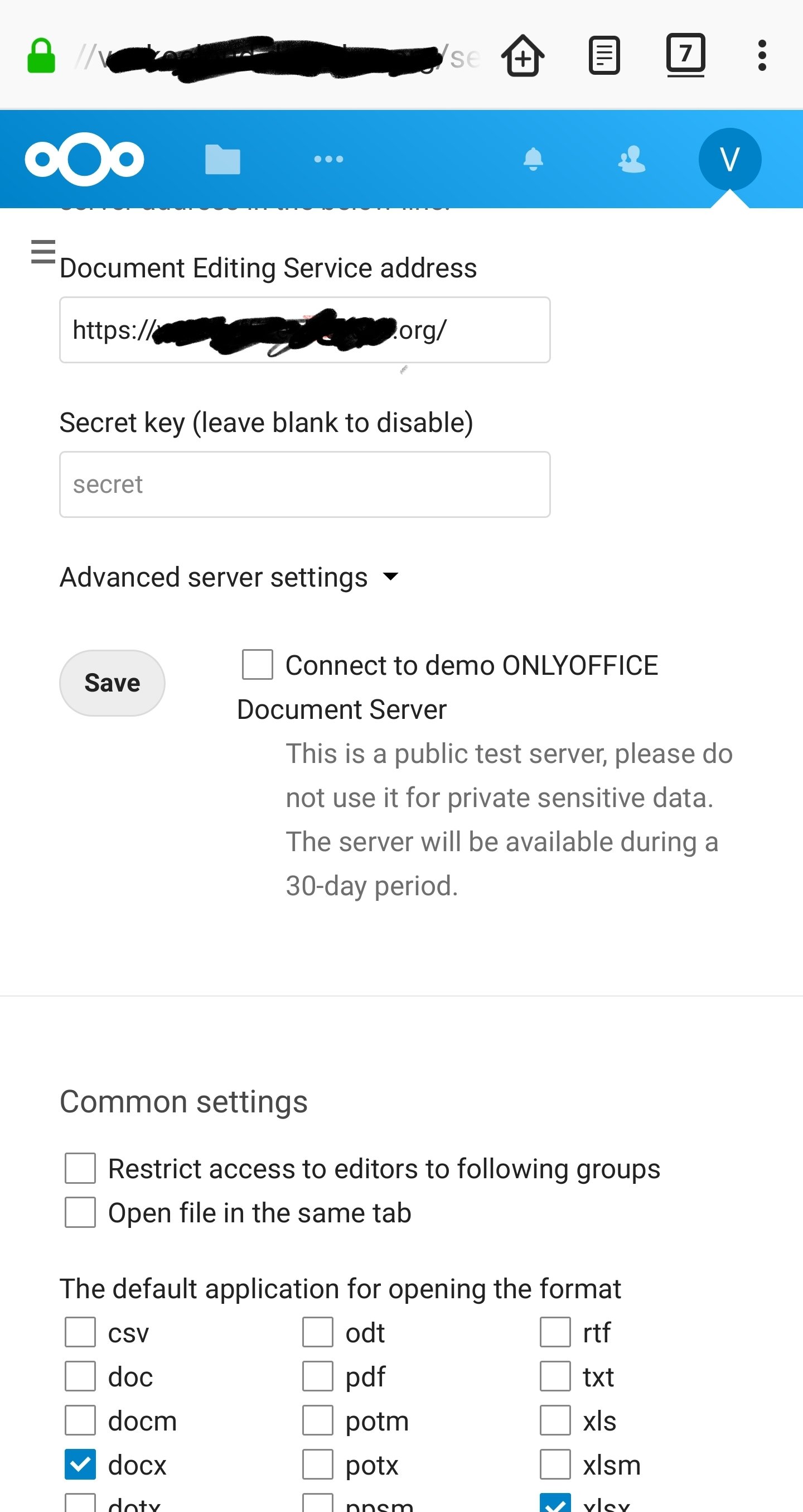

I install yesterday Onlyoffice docker and connect to Nextcloud 18 thru Let'sencrypt reverse proxy.Everything works ok even the Onlyoffice open in the Android Nextcloud app.
Android app Onlyoffice works also.
