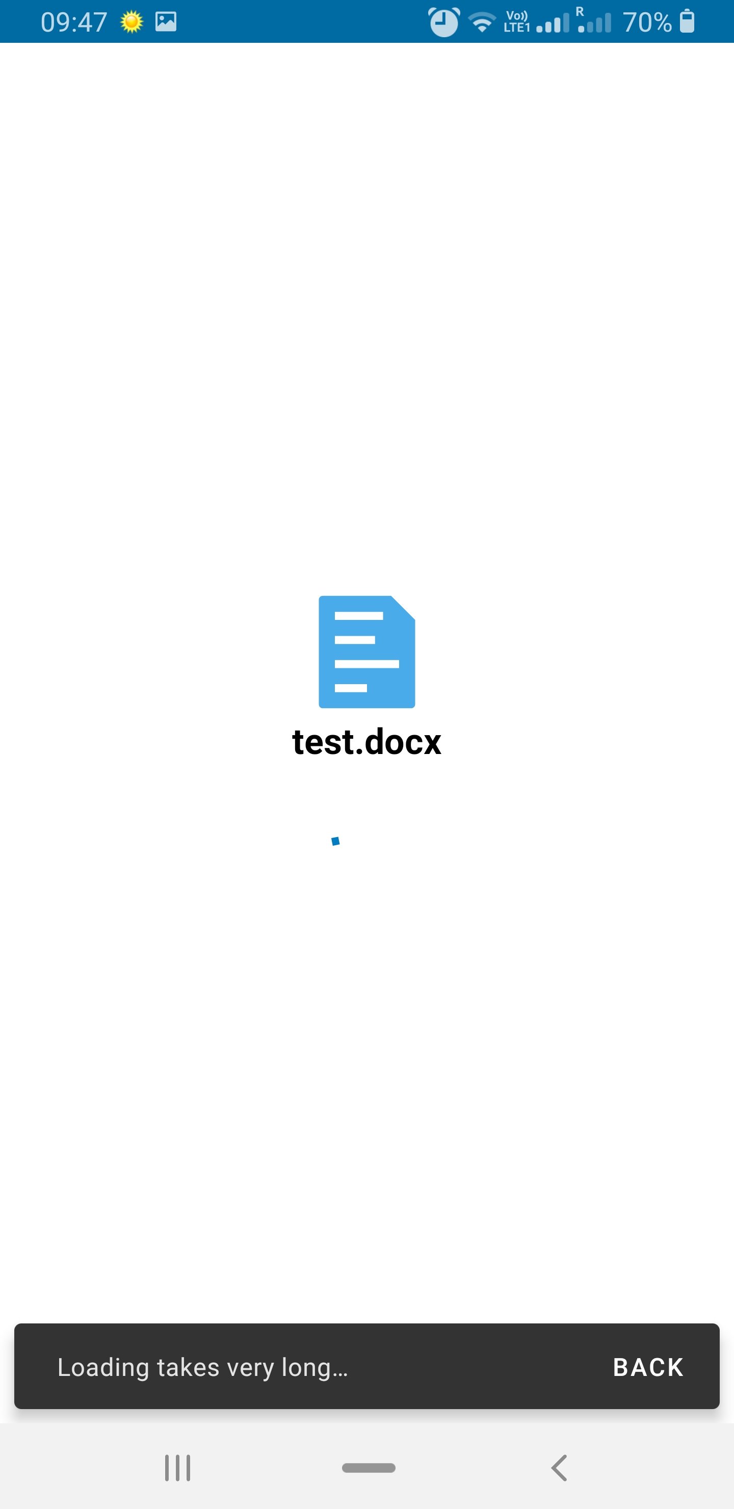

when using nextcloud webui everything works exactly as it should. onlyoffice opens files as normal. Its only an issue with the android app. Regardless of network i get the same issue when trying to edit a file. it will open the onlyoffice connector and then sit on the loading screen and never actually loads.
I get now the same problem just loading and can't open.Before was ok .Maybe some update of onlyoffice docker broke this.
The app and community server app within nextcloud did get an update very recently. this is exactly the issue im having. i tried getting the community server app within nextcloud to work when it was updated but still no joy on that.
EDIT-
Found this on github
https://github.com/ONLYOFFICE/onlyoffice-nextcloud/issues/228
Yes I was sure was after the update broke something , maybe next update will fix.
Now is fixed just update Nextcloud Onlyoffice and will work.
seen this cheers. all sorted

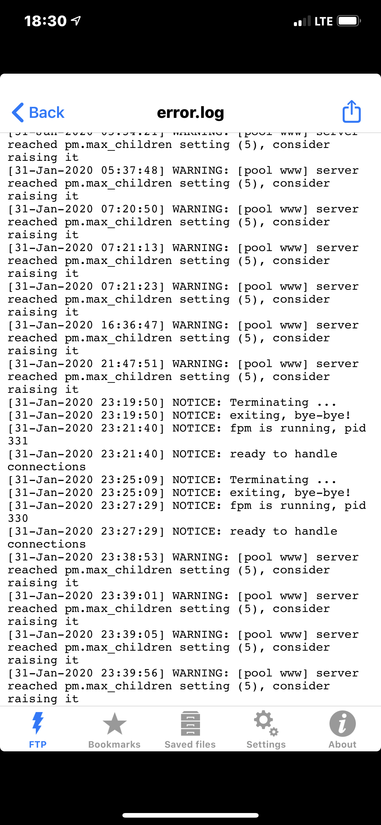

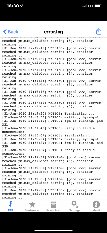

On 10/14/2019 at 11:23 PM, Ustrombase said:
I am getting this error when I try moving "a lot" of pictures (50) into a folder using the webUI
[15-Oct-2019 04:10:14] WARNING: [pool www] server reached pm.max_children setting (5), consider raising it
research has led me to edit /config/php/www2.conf inside my config directory of nextcloud docker.
https://github.com/linuxserver/docker-nextcloud/issues/30
However, I can't find anywhere what each of these settings are suppose to be. I would like to know what each number means. Also don't know why this happens specifically when I am moving files into another folder.
pm = dynamic
pm.max_children = 40
pm.start_servers = 15
pm.min_spare_servers = 15
pm.max_spare_servers = 25
Does anyone know?

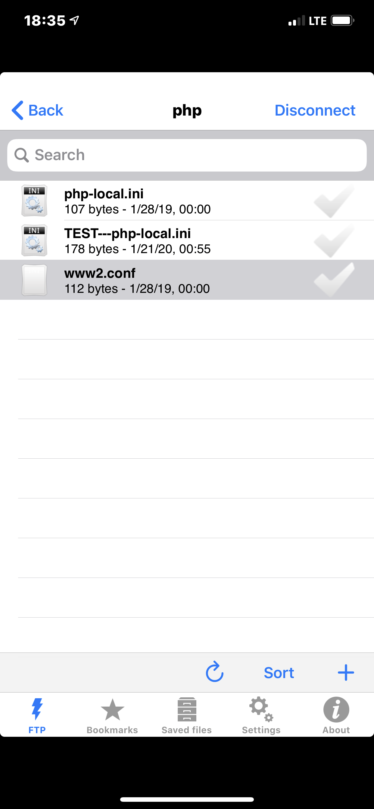

Sorry to bring up a post from the dead but seeing this error in my PHP logs quite often.
Does anyone have the details on assigning more children? What file? How does one determine how much to raise it by?
Any help would be greatly appreciated:-)
Edit: error below. Also is this correct www2.conf file to edit?(appdata>Nextcloud>PHP????)

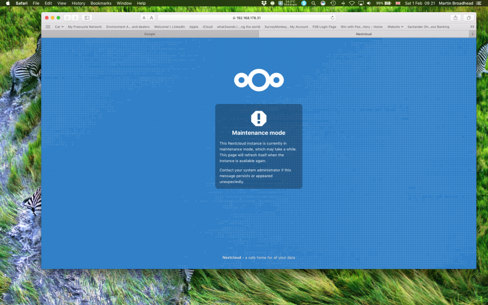

Hi Guys
   hopefully somebody can help i am running on the latest version of Unraid 6.8.2 and have a Nextcloud docker running. Had a message saying a that a new update was ready so I did what i normally open up Nextcloud web page clicked on the updater to update to Nextcloud 17.0.3 and as normal let it run however now it appears to be stuck in Maintenance mode see attached. has anybody got any ideas.
I have looked on the Nextcloud forums and all it say is use
sudo -u www php occ maintenance:mode --off.
Not being that used to command line code i will need a bit of hand holding.
I did originally put this I general support by mistake and was advised to place it here by a moderator (oops) hopefully someone can help me

1 hour ago, Martintheshred said:
Hi Guys
Open a console (in docker) and execute this command : sudo -u abc php7 /config/www/nextcloud/occ maintenance:mode --off
Hi Thank you for your help the update has worked.
