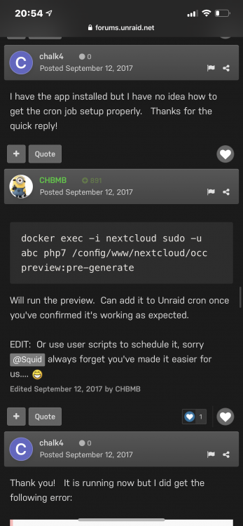

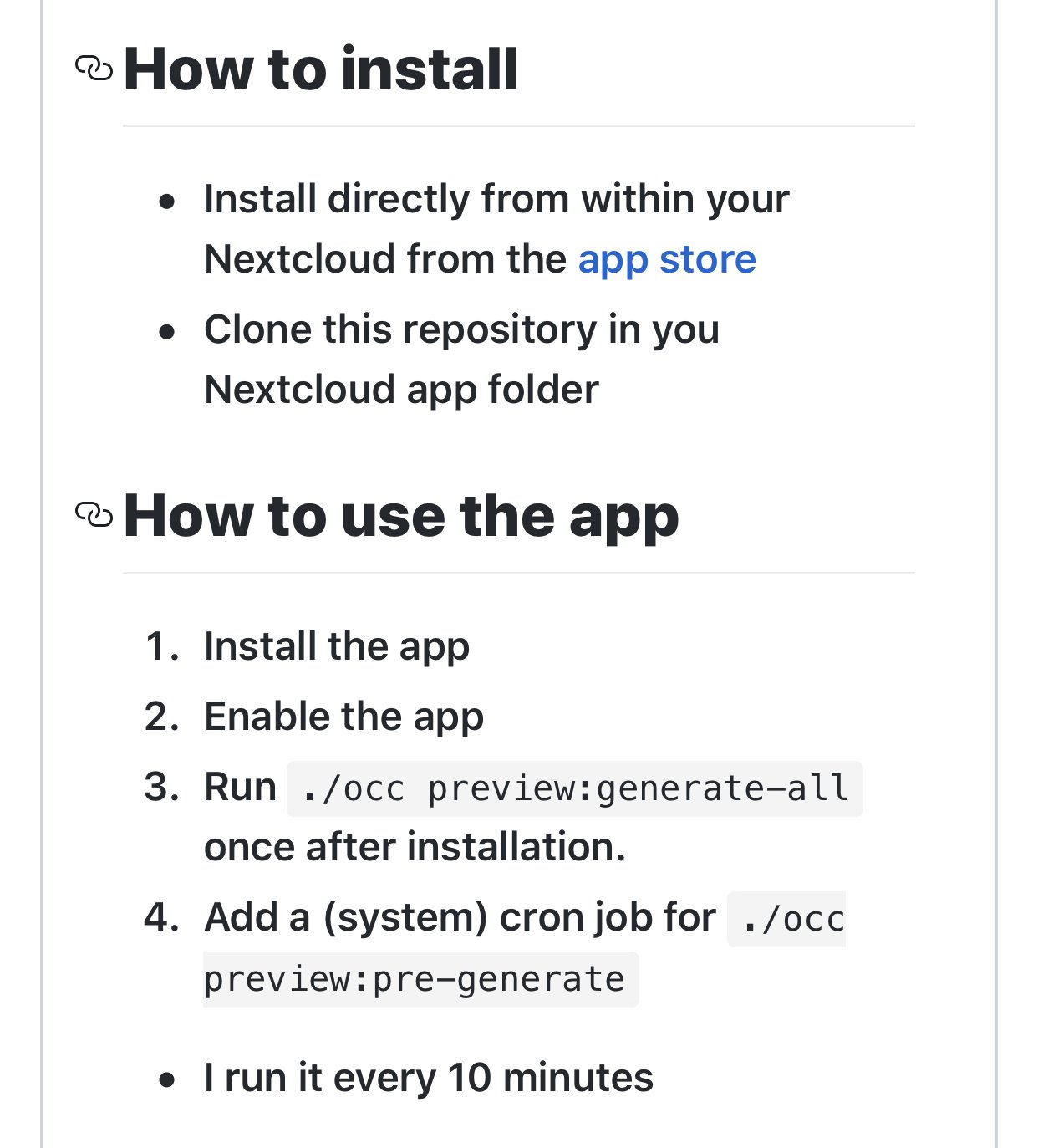

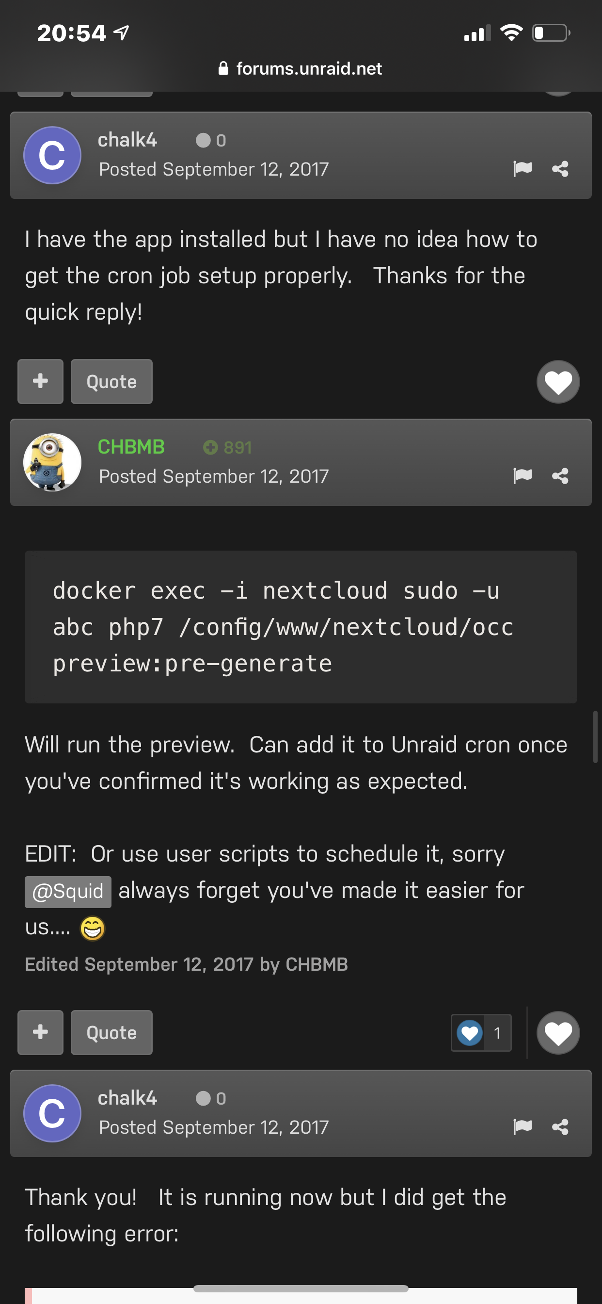

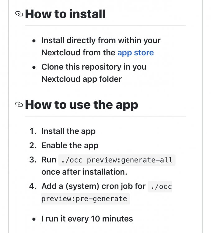

I’m wanting to setup Preview Generator. I see that previously there were problems with amount of memory in PHP. In Nextcloud’s current state what would correct way to check and or change memory for the PHP.ini in my attached image be?
Preview Generator
I'm interested in setting this up, but I'm curious what the RAM requirements would be for a single user implementation (with possible growth to 5 or so users if I bring my family onboard). That would be the RAM for both the nextcloud docker as well as the required MariaDB instance. Right now, my unraid server only has 8GB total, averaging about 3GB free/cached.
