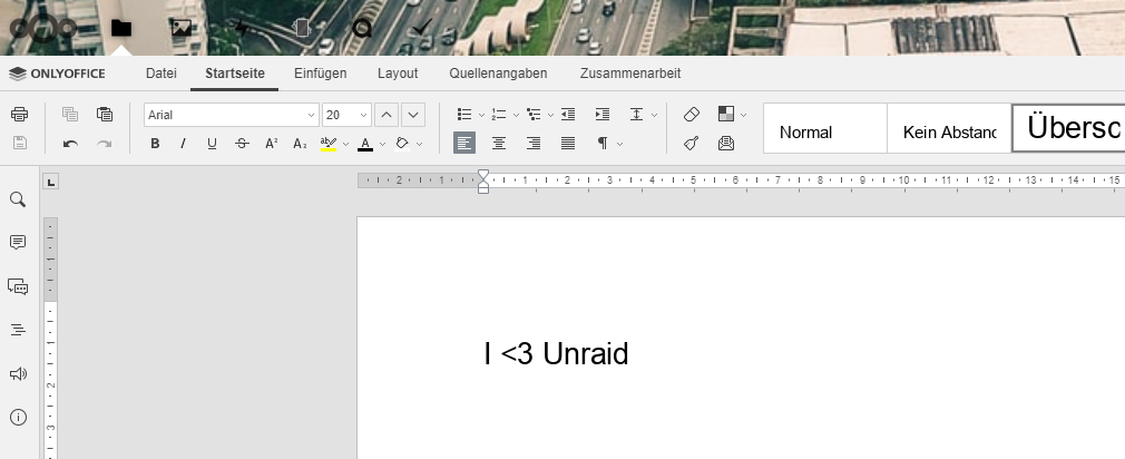

Guys, I just uploaded my template to the community apps with the official nextcloud 18.0.1RC2 where I was able to very easily get ONLYOFFICE running. If you are ready for a fresh installation or just like to try it out, it will be there soon. It is working. But not with the LSIO image build.
Edited by knex666

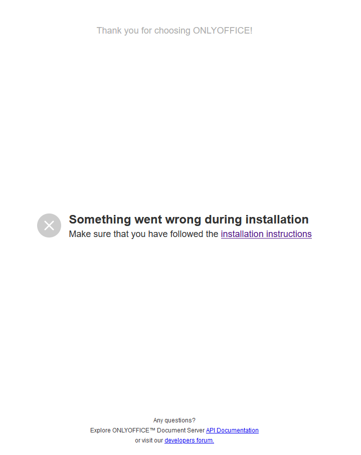

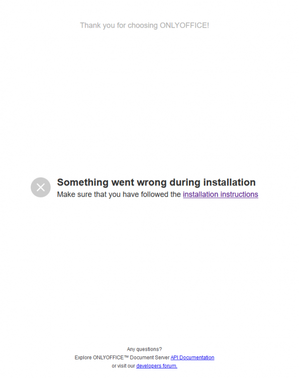

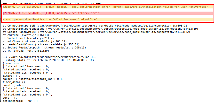

Have followed Spaceinvader's guide here to setup OnlyOfficeDocumentServer but the container seem to malfunction, when I https to it via my web browser I'm greeted with this:
And the logs:
Any ideas?
Yes in that one.
Will have to try and report back.
And the logs:
Any ideas?
So far as I remember onlyoffice is a 'dumb' connection - no passwords or anything.  It basically just points at the web server file system.  So assuming you're using the onlyoffice container, I'd just wipe it out and reinstall as a first step (onlyoffice, not nextcloud).  Then check the onlyoffice connector and try again.
