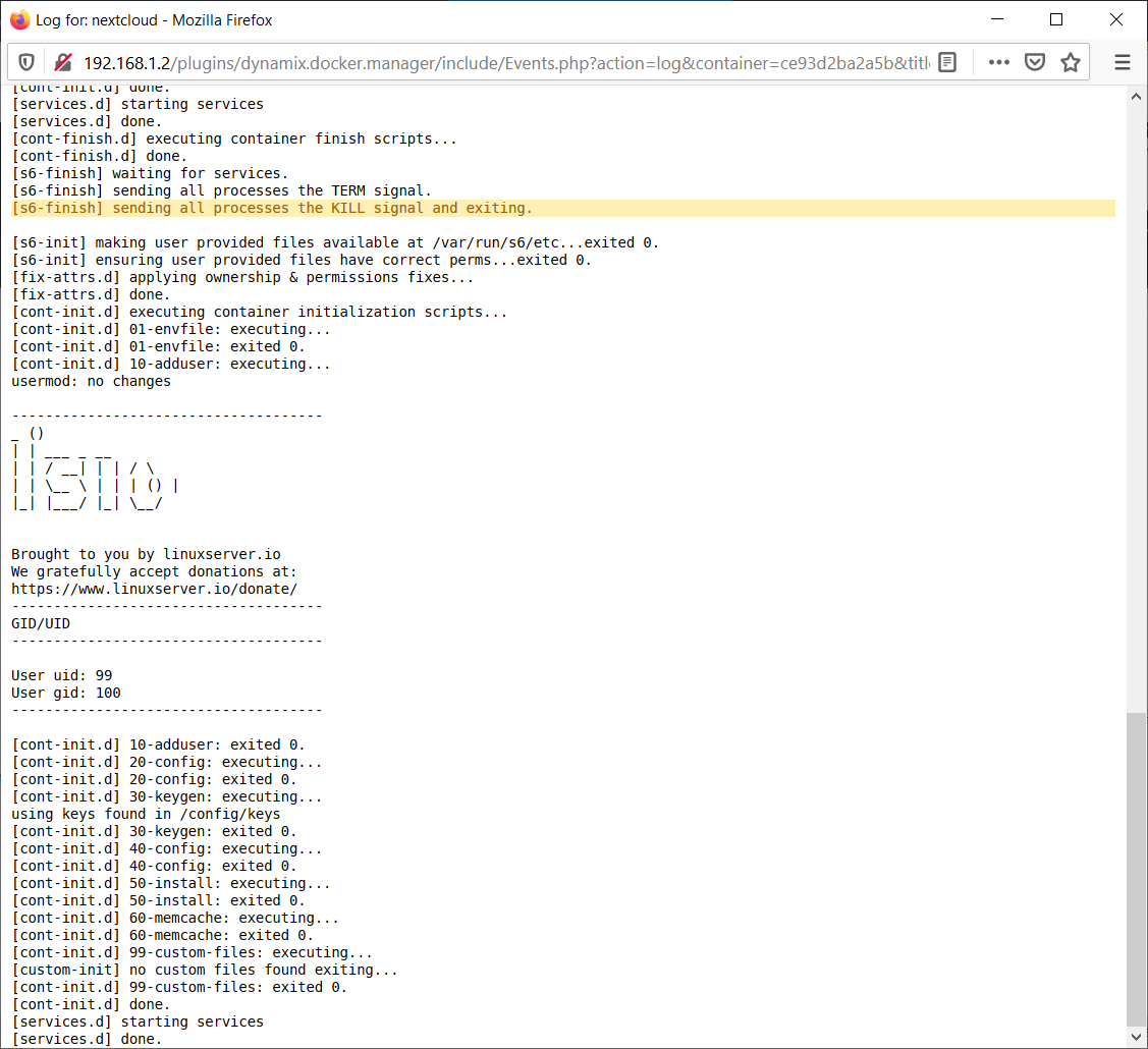

Can someone tell me where the Nextcloud error logs are located? This latest version reports that the "Community Document Server" and "Talk" fail to install when the docker image is installed. However after login I see both listed under Apps but when I click on "Remove" Nextcloud reports "an error occured".
Can't diagnose when the error message is "It's broken". :D
Link to comment
