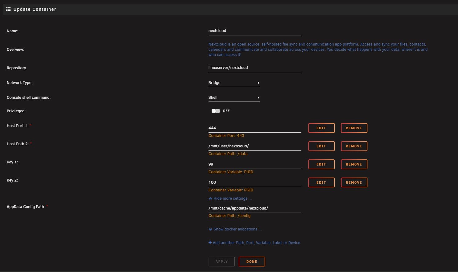

I have solved my issue. Turns out that in the unRAID community store there are two nextcloud docker templates. One is from linuxserver guys and the other is from nextcloud. The previous admin of my unRAID server has installed the nextcloud docker using the template from nextcloud and then deleted it. The docker disappeared from the docker list but the config files in /mnt/user/appdata/nextcloud remained.
So the solution was to delete all the nextcloud dockers xd, all the config files from /mnt/user/appdata/nextcloud and then to install the nextcloud docker using the linuxserver template. Worked as a charm :D

Are you issuing those commands on the Unraid terminal command line or the Nextcloud container command line?  Should be in the Nextcloud container.
Oh my, I feel silly, I can't believe that was the fix, thank you so much.

Next Problem:
I can not edit the container via the unraid GUI, i can not open the container over clicking on the name and if i confirm an update:
