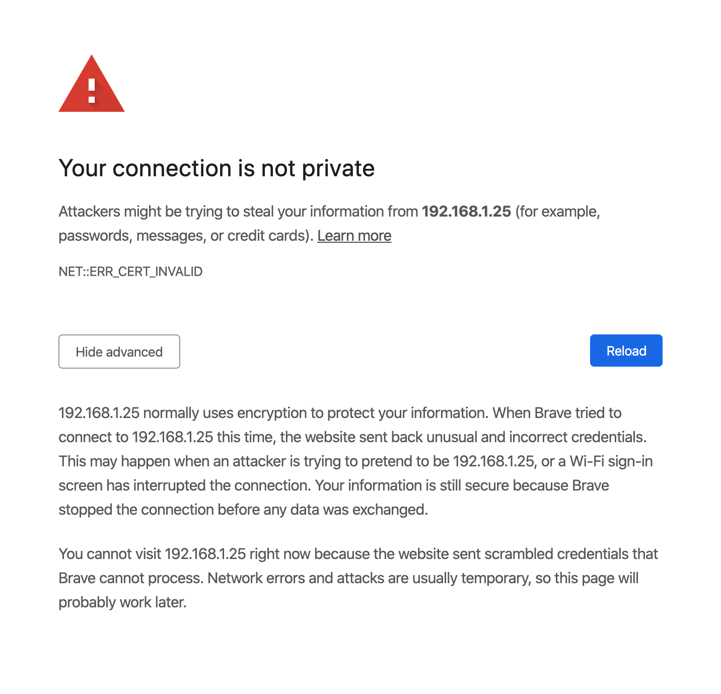

4 hours ago, damnshaneisthatu said:
Attempting to finalize my installation of Nextcloud, but can't proceed through the WebUI. Any ideas here? Thank you in advance.
Use a browser that lets you go to the location. Firefox should let you as far as I know. It has to do with self signed certificates.
Thank you, @saarg. Firefox did indeed allow me to proceed to location. Unfortunately, it timed out. "504 Gateway Time-out // nginx/1.16.1".
Then you are configured something wrong somewhere. If you have followed a guide, go over it and check that you have done everything.

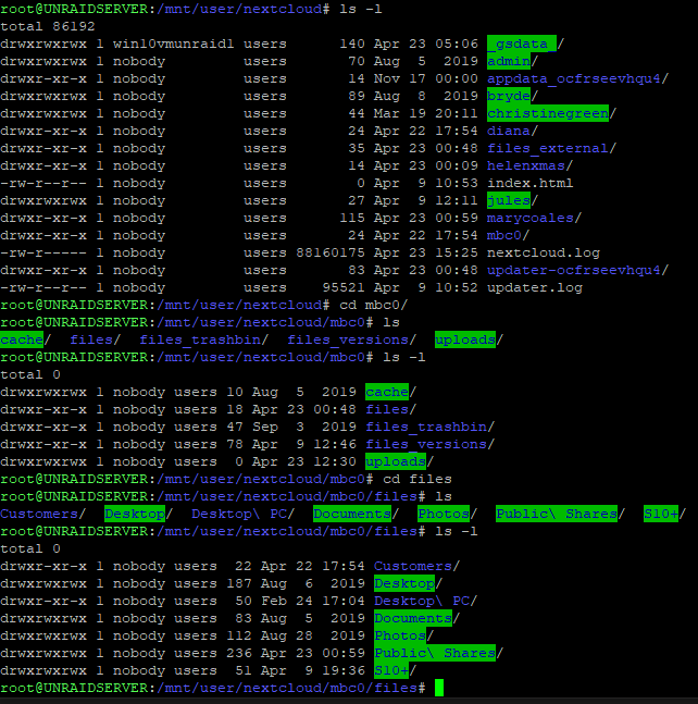

I have been able to modify/create files in my nextcloud container ever since installation 6 months+ ago but as of this week I no longer can?
Some of the permissions seemed to have changed for some users? (mine is mbc0)
I mistakingly posted in the wrong thread (knex666 Nextcloud 18) and he said to enter these parameters/arguments to resolve the issue.
extra params
--user 99:100 --sysctl net.ipv4.ip_unprivileged_port_start=0
post args
&&  docker exec -u 0 nextcloud /bin/sh -c 'echo "umask 000" >> /etc/apache2/envvars
This causes an error (s6-mkdir: warning: unable to mkdir /var/run/s6: Permission denied) I presume because it is the wrong docker?  Is there something similar I can use for this docker to give me back the permissions needed to use SMB again please?
Thank you
Share this post
Link to post
extra params
post args
Thank you
Permissions looks correct from what you have posted. Only the top one _gsdata is wrong.
Don't run commands from another container as that is a sure way to make problems. Remove those from your template.
We chmod the /data mount to the correct user and group on start, so restart the container and permissions should be correct. You might have done something to the files inside the container also, so do a force update on the container to set it back to normal.
