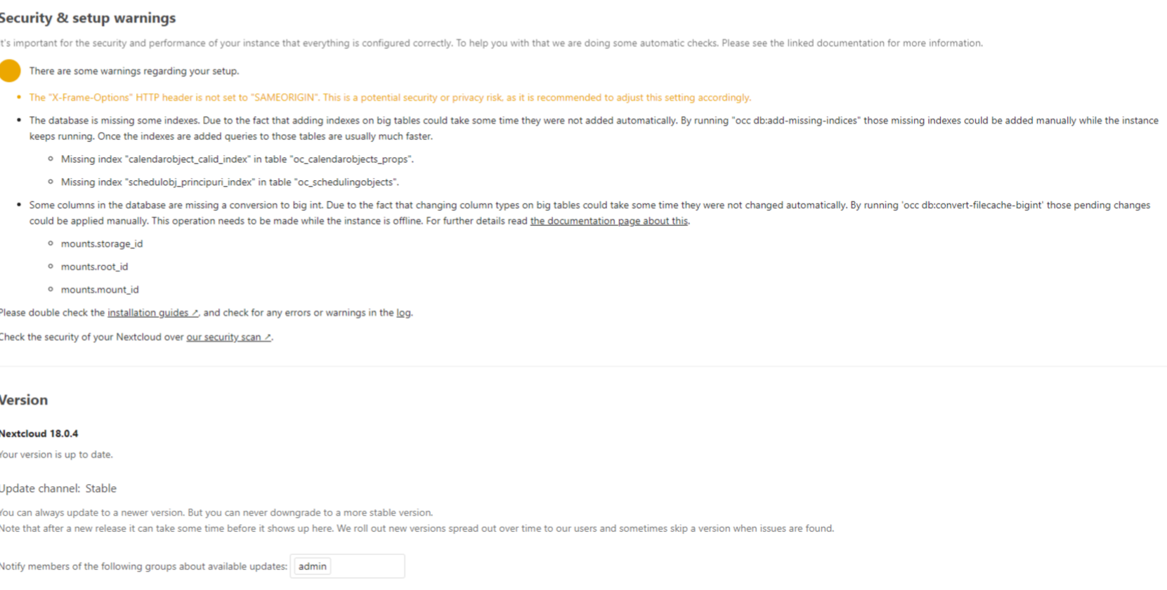

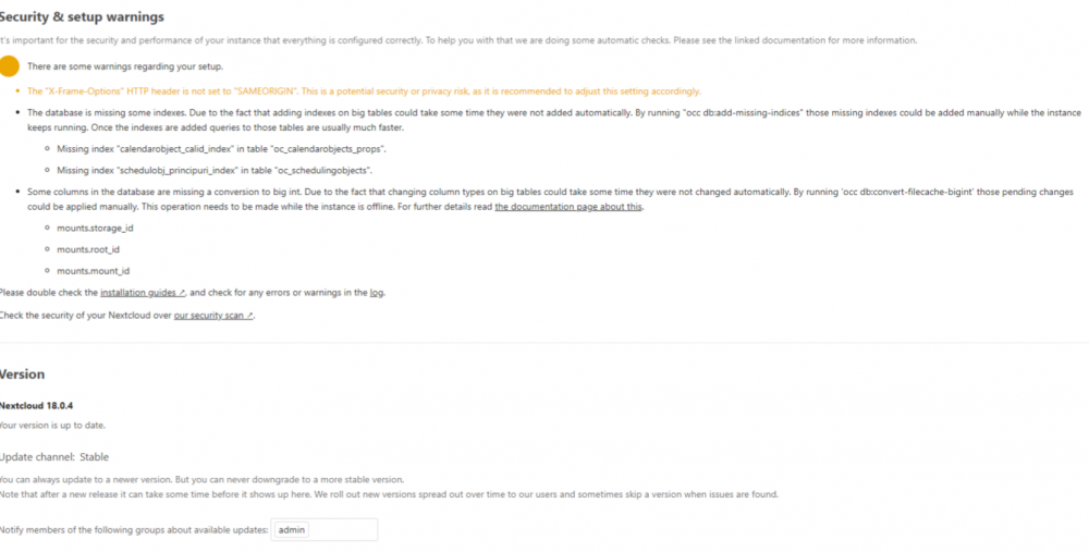

Need some help correcting some errors, fresh install following Space Invader Video.
I followed his instructions able to get every error out except for the first one regarding "SAMEORIGIN".
Fresh install, so the appdata folder was never used before?
If that is the case, then you might need to update your reverse proxy conf. Delete the nextcloud sample and restart letsencrypt. That will restore the newest sample. Then edit the sample as instructed at the top of the file, save it and delete the old proxy conf file. Then remove the sample part from the filename and restart letsencrypt.
Did that and still getting the SAMEORIGINS error.

It might be the ssl.conf or the proxy.conf that needs updating. Check the date at the top with the one on GitHub. If they are different, delete them and restart the container.
I deleted both and the error still appears.
Delete this file appdata/nginx/site-confs/default in nextcloud appdata and restart the nextcloud container.
The solution was found as the first hit on google if you would have googled sameorigin nextcloud linuxserver.
Tried that also and is not working, still this stupid error shows up.
I too googled a bunch of solutions that didn't work also and that's why I'm asking help here.
I just did a new installation of Nextcloud here and do not have that error message.
I can see from the proxy-conf you posted above that you have edited it. Do not do that. Do only what is mentioned in the top of that file.
How does your default file in nextcloud look like?
