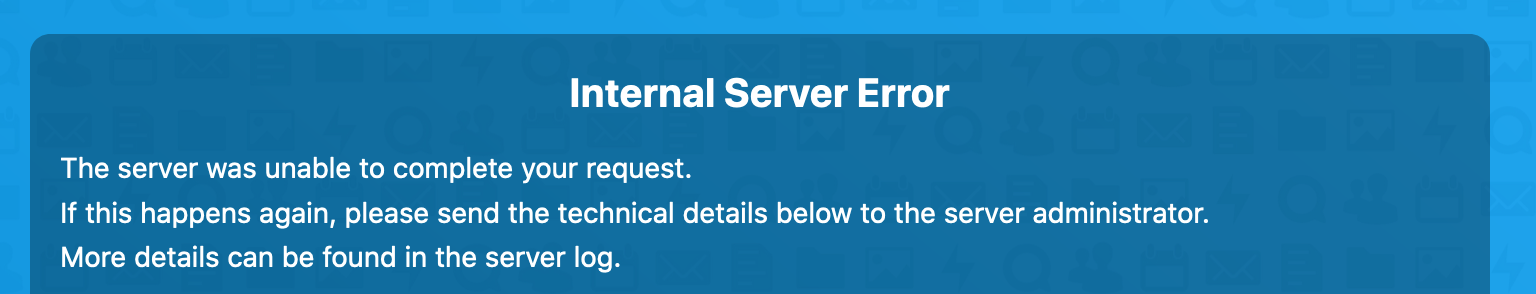

I recently moved to a new house and my server is assigned a new Lan address.  The port forwarding is set correctly but Nextcloud is unresponsive.  When I attempt to access via 192.168.1.*:444 I receive this message.
Internal Server Error The server encountered an internal error and was unable to complete your request. Please contact the server administrator if this error reappears multiple times, please include the technical details below in your report. More details can be found in the server log.
The error log shows
2020/05/15 23:12:12 [error] 350#350: *339 upstream timed out (110: Operation timed out) while reading response header from upstream, client: 172.18.0.3, server: _, request: "GET / HTTP/1.1", upstream: "fastcgi://127.0.0.1:9000", host: "****.duckdns.org:443"
Not sure how to proceed with correcting this issue.

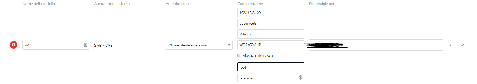

Hi all,
I want to add shares in my nextcloud . I've tried with smb with no success:
Can someone please point me to the right direction?

6 hours ago, Jokerigno said:
Hi all,
Workgroup and -Marco is not needed. And you can't use the root user.

Go to your config.php file and have a look at the ip addresses assigned.  I suspect you will find your old ip range from the previous address. Change to 192.168.1.*:444.  I assume you aren't using letsencrypt.

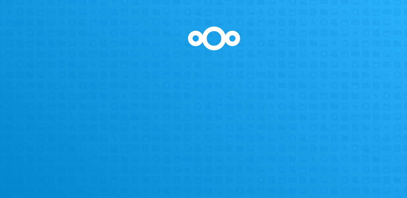

Ok so regarding the slow loading of my login page.
If I try to do it off my network, say my parents or my phone on mobile it loads instantly.  If I use my PC on the same network as my Nextcloud server it never loads properly.
Not a big problem as I can access across my LAN, but not helpful for testing.  Any ideas what I've done?
I just get greeted with this
Edited by daveo132
What happens if you try a different browser?  Firefox then chrome would be my first 2 prefs.  Edge can give iffy results and cant run the password app. IE? no one should be using ie now.
Another maybe is try loading the bruteforce app.  Then go to settings and whitelist your modem. ie if your modem address is 192.168.1.1 then add that to the whitelist.
