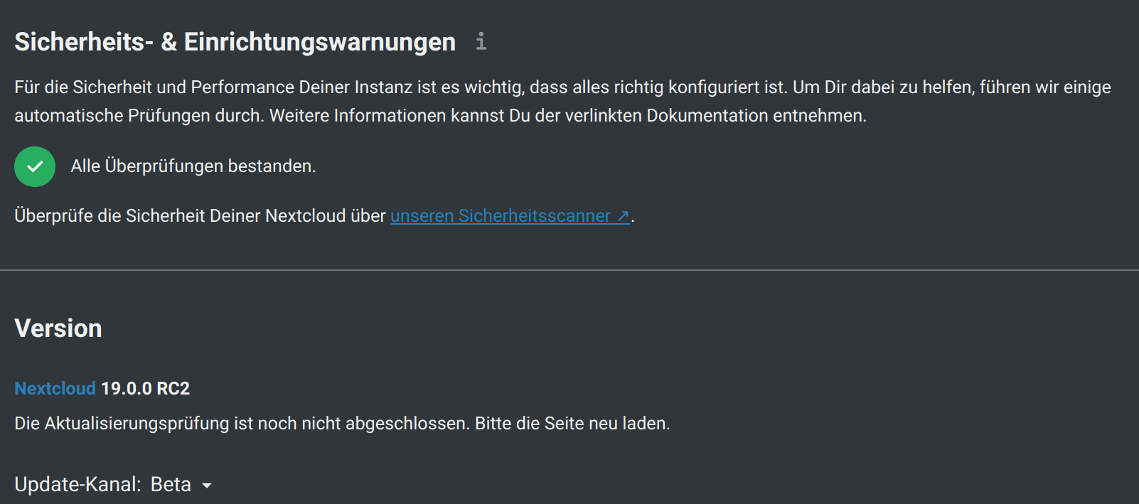

may try this from nextcloud docker shell
root@6d5906fa3630:/# sudo -u abc php /config/www/nextcloud/updater/updater.phar
Nextcloud Updater - version: v16.0.3-3-ga0c2b25 dirty
Current version is 19.0.0 RC1.
Update to Nextcloud 19.0.0 RC2 available. (channel: "beta")
Following file will be downloaded automatically: https://download.nextcloud.com/server/prereleases/nextcloud-19.0.0RC2.zip
pretty straight forward ...
