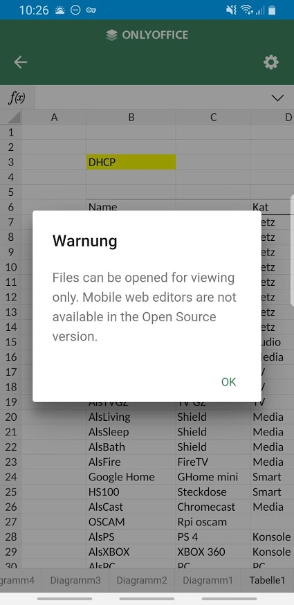

23 hours ago, Jessie said:
Can you edit on the android device? Or read only?
i would say its read only meanwhile ... worked before, but now ...
That's what happened to me. I'm not sure what will happen in the future. I googled and I got the impression that editing will work on the builtin document server.  Will never know until that gets fixed.
OnlyOffice removed Web/mobile editing from version 5.5.0 of Community Document Server. OnlyOffice moved to payment tiers to enable editing on mobile devices. It was mentioned a few pages back in this thread. You can read more on this from Nextcloud forum from here.
Yep.  That'd explain it.  I'm happy with collabora. I think I'll stay there.  Thanks for that info.

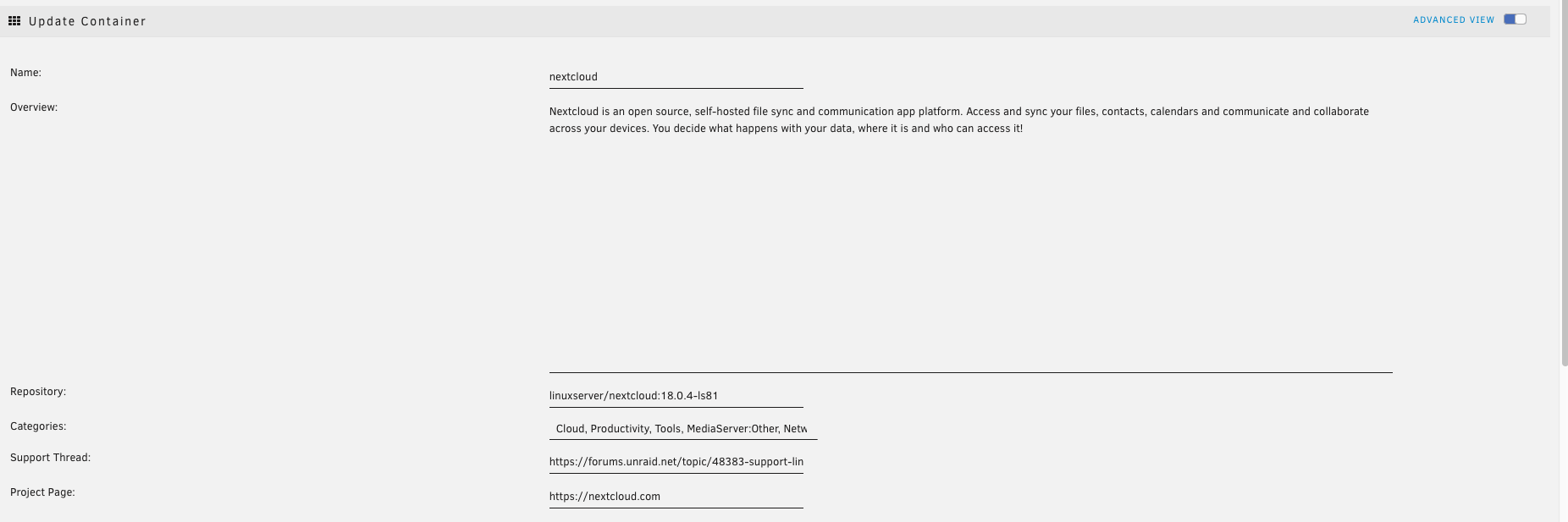

I just updated to the the nextcloud container to latest.
After which i couldnt access nextcloud  and was getting 400 bad request error
So if anyone else has this error you can fix by rolling the container back
To do that change the repository line in the template to
linuxserver/nextcloud:18.0.4-ls81
as below
1358554226_ScreenShot2020-06-04at19_34_19.thumb.png.f8784214317206d9ad069c7f14e73d1a.png
as below
Thank YOU!
