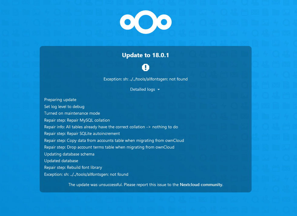

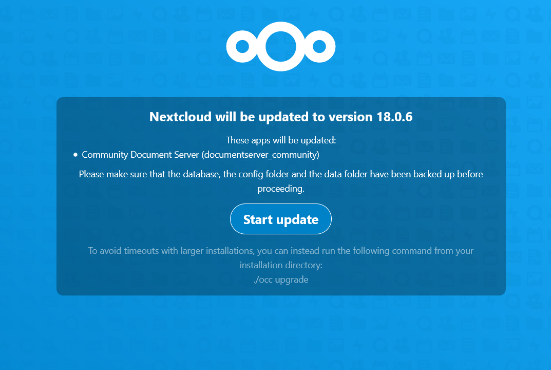

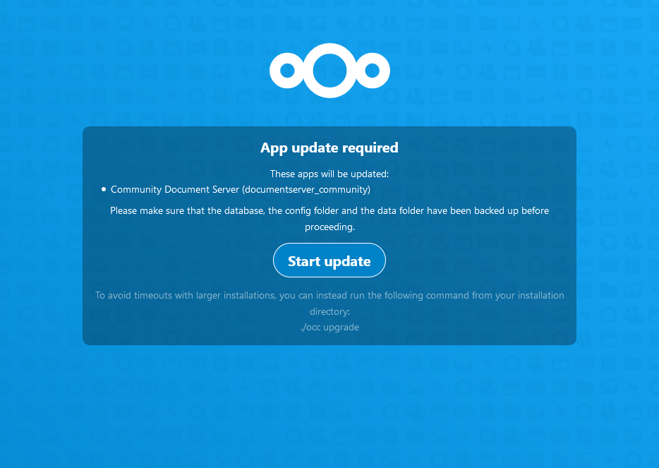

Hello - I've been running this container together with Onlyoffice Document Server and it's been working great. Today I tried to upgrade nextcloud from 18.0.4 to 18.0.6 and I'm getting the error below. Not sure how to proceed from here. My nextcloud instance is now stuck in the upgrade phase. Please advise.
Nextcloud or one of the apps require upgrade - only a limited number of commands are available
You may use your browser or the occ upgrade command to do the upgrade
2020-06-09T13:18:51+00:00 Set log level to debug
2020-06-09T13:18:51+00:00 Turned on maintenance mode
2020-06-09T13:18:51+00:00 Repair step: Repair MySQL collation
2020-06-09T13:18:51+00:00 Repair info: All tables already have the correct collation -> nothing to do
2020-06-09T13:18:51+00:00 Repair step: Repair SQLite autoincrement
2020-06-09T13:18:51+00:00 Repair step: Copy data from accounts table when migrating from ownCloud
2020-06-09T13:18:51+00:00 Repair step: Drop account terms table when migrating from ownCloud
2020-06-09T13:18:51+00:00 Updating database schema
2020-06-09T13:18:51+00:00 Updated database
2020-06-09T13:18:51+00:00 Updating <documentserver_community> ...
2020-06-09T13:18:52+00:00 Repair step: Rebuild font library
2020-06-09T13:18:52+00:00 Exception: sh: ../../tools/allfontsgen: not found
2020-06-09T13:18:52+00:00 Update failed
2020-06-09T13:18:52+00:00 Maintenance mode is kept active
2020-06-09T13:18:52+00:00 Reset log level
Keep maintenance mode active? [y/N] n
Maintenance mode disabled
Share this post
Link to post

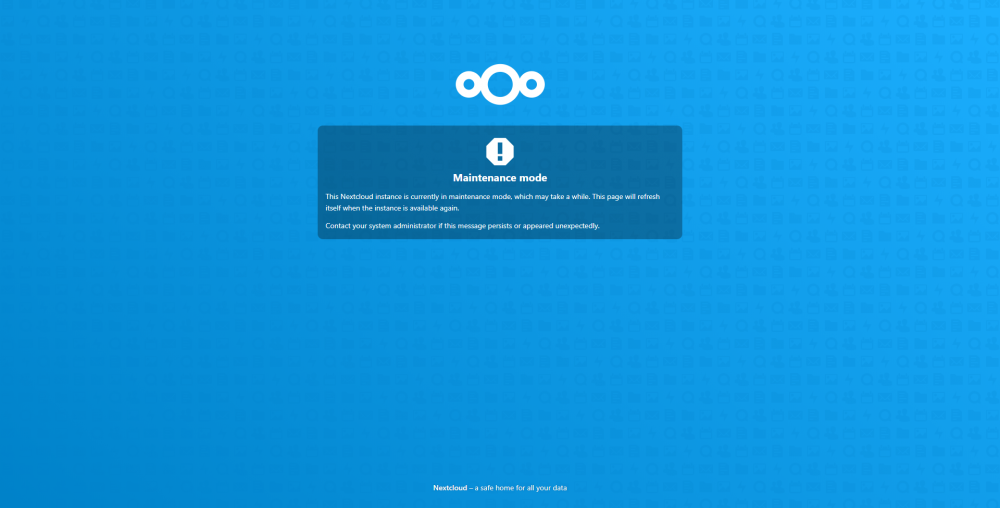

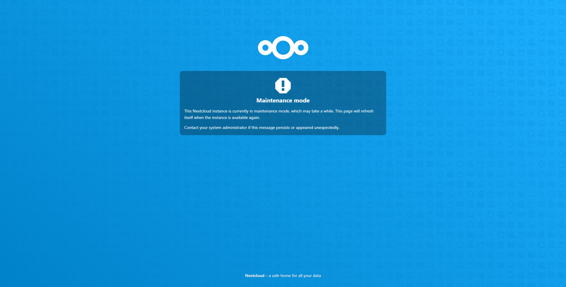

I have a similar problem.  Whilst trying to do the same upgrade I'm now stuck on the Maintenance page and can't access nextcloud:
1436607442_FireShotCapture162-Nextcloud.thumb.png.23a4497674e3e68ff9bd12f629f60344.png
Share this post
Link to post
1 hour ago, DZMM said:
I have a similar problem.  Whilst trying to do the same upgrade I'm now stuck on the Maintenance page and can't access nextcloudimageproxy.php?img=&key=e5eec7c5c933ca16imageproxy.php?img=&key=e5eec7c5c933ca16imageproxy.php?img=&key=e5eec7c5c933ca16:
Spaceinvader has a video about nextcloud explaining how to modify a file to change next to not be in maintenance mode.
All that you need to do is edit a text file and change a line from "true" to flase" but I can't remember where this file is located.
Share this post
Link to post
Go to /mnt/user/appdata/nextcloud/www/nextcloud/config/ open the config.php and at the bottom you will see ‘maintance’ => true change it to false.
Share this post

Maintenance is set to 'false' on my config.php, yet I'm getting the screen below. Not sure how to get unstuck from this.
Share this post
Link to post
Go to this folder and edit the config.php file with notepad++ and change the "maintenance" from true to false. restart nextcloud docker
\\SERVER\appdata\nextcloud\www\nextcloud\config\config.php
'maintenance' => false,
Share this post
I have the same Problem with my nextcloud. It looks like the Document Server updated app to not work properly.
I solved this by disabled the "Document Server" with the terminal.
Open the nexcloud terminal window and type this command
Lists all your current isntalled apps
  occ app:list
then I searched for the Document Server and used this command to disable it.
occ app:disable  documentserver_community
Now I can login to nextcloud and see the user interface again.
Edited by tomibi
  • Like 2
  • Thanks 3
Share this post
Link to post
Thank you for your response. Disabling the "documentserver_community" app allowed me to finish the upgrade to 18.0.6.
  occ app:list
I had this problem and this fixed worked for me as well, thank you!

I've been on v16 for some time and finally went through the multiple upgrade process to get to 18. Everything went well but my homepage shows what appears to be a spinning icon (as if it's scanning for something). The icon never goes away. Restarting the container doesn't help. This is on Firefox. Only add-on is UBlock Origin which is disabled for my Nextcloud host.
Any ideas?
Share this post
Link to post
Any ideas?
To answer my own question, it looks like it has something to do with "Use rich workplaces." Disabling this removes the icon.
Share this post
Link to post
I was having the same issues as the other folks. The fixes in the above posts fixed the issues.
In Nextcloud docker cli enter:  occ app:disable documentserver_community
In Unraid cli enter: docker exec -it nextcloud updater.phar
Updating from the Unraid cli seems like the way to go!
Thank you!
