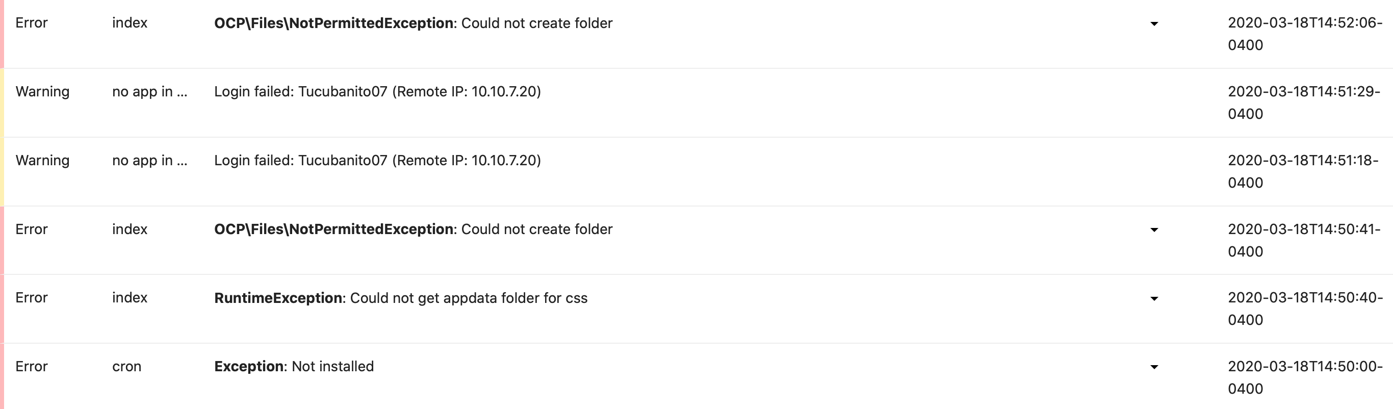

I just did a fresh install and i get this error "OCP\Files\NotPermittedException: Could not create folder". @Kewjoe
Edited by Tucubanito07
This is the other error i am getting as well.
[cron] Error: Exception: Not installed at <<closure>>
0. /config/www/nextcloud/lib/base.php line 651
   OC::checkInstalled()
1. /config/www/nextcloud/lib/base.php line 1089
   OC::init()
2. /config/www/nextcloud/cron.php line 42
   require_once("/config/www/nextcloud/lib/base.php")
at 2020-03-17T22:05:00+00:00
