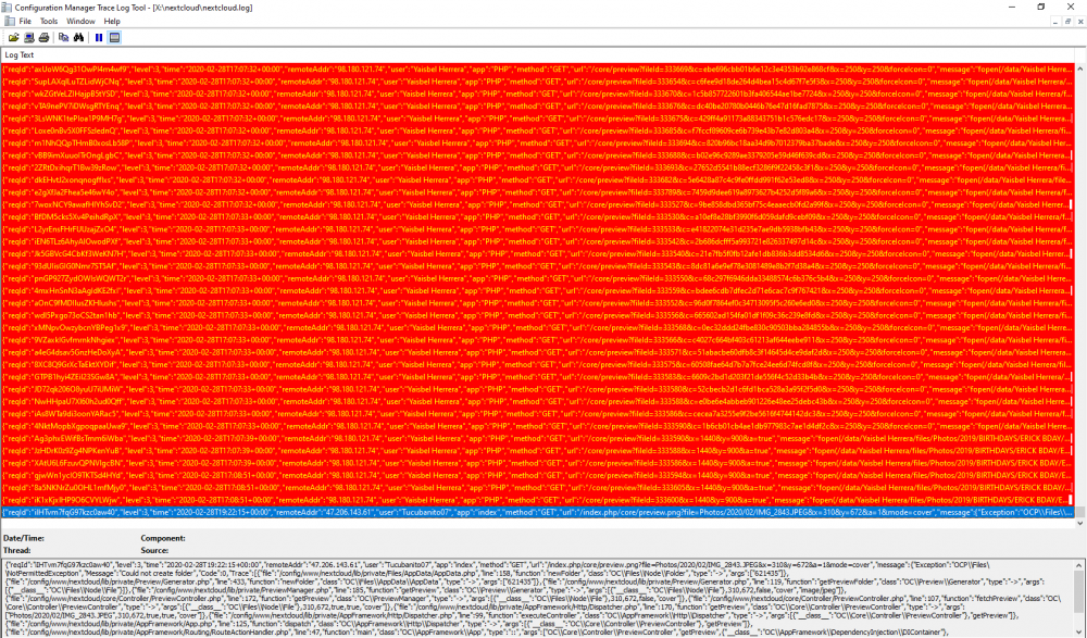

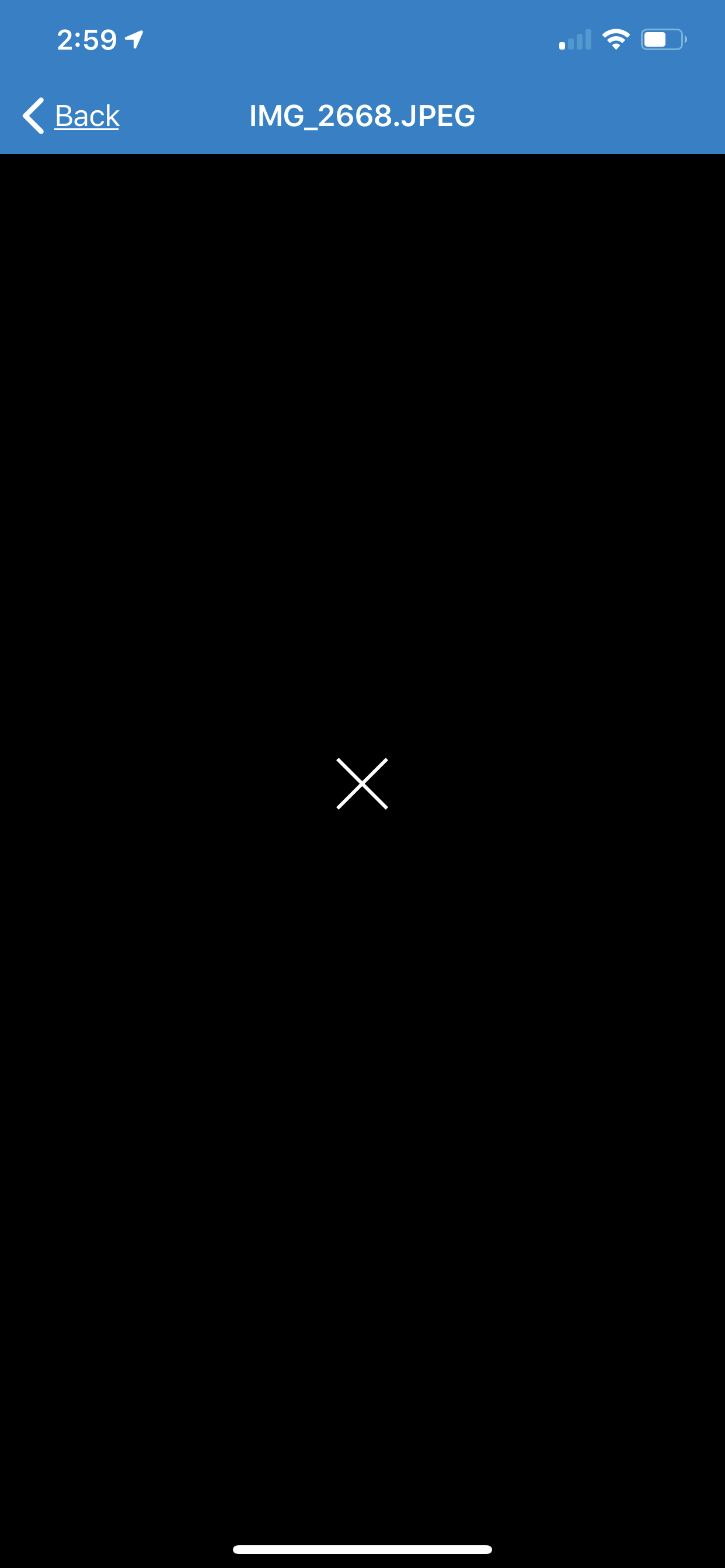

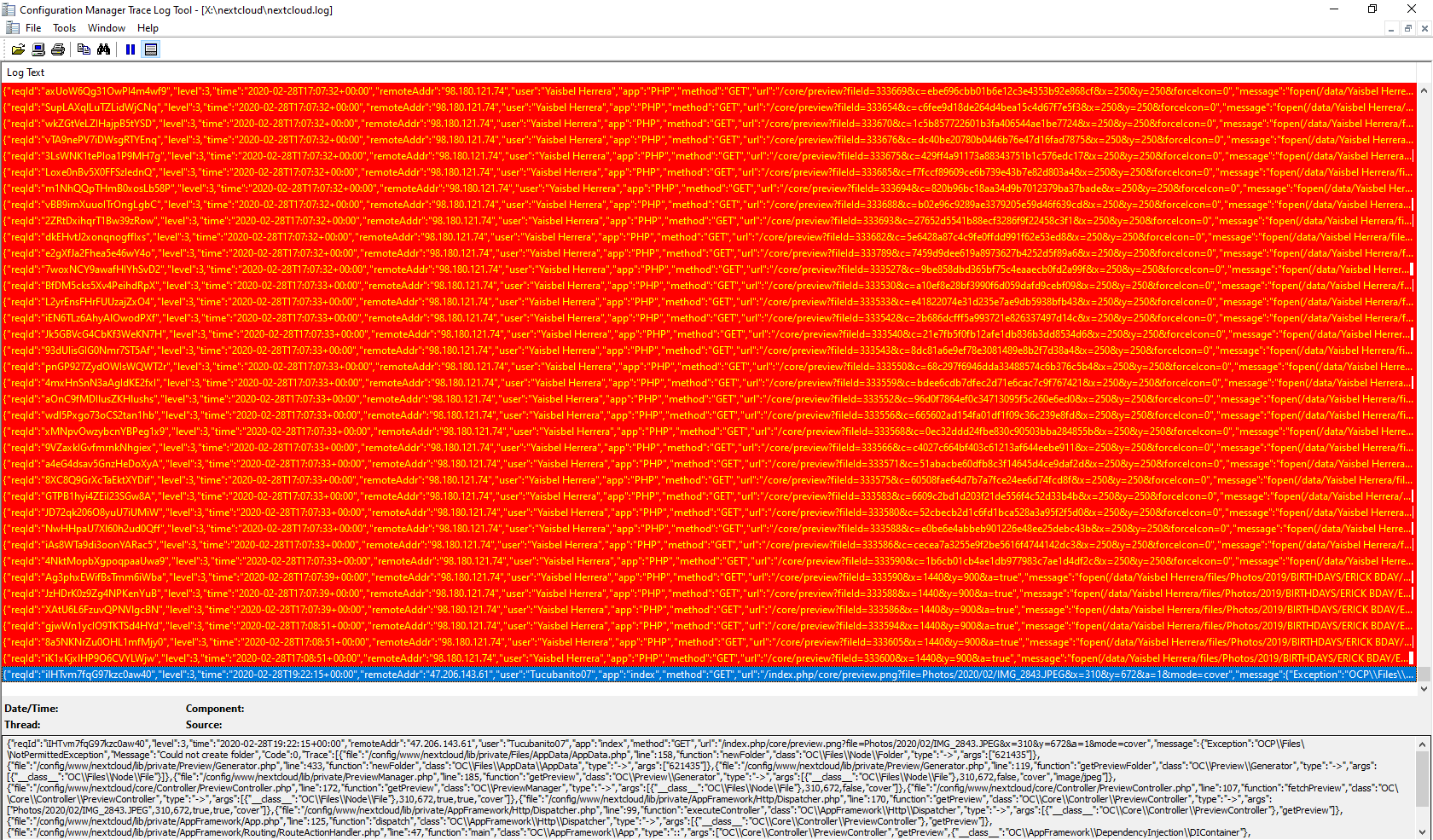

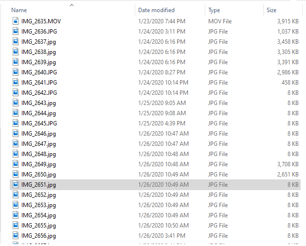

Tucubanito07 Posted February 29, 2020 Share Posted February 29, 2020 Hello guys, I have Nextcloud installed and have an issue " failed to open stream: No such file or directory at /config/www/nextcloud/lib/private/Files/Storage/Local.php#217",“userAgent”:“Mozilla/5.0 (iOS) Nextcloud-iOS/2.25.5”,“version”:“17.0.3.1”} ‘’ Some photos work fine and others just says Error Loading. Furthermore, when i use the IOS app it just has an X and it does not bring up any pictures. If someone could please help me figure out how to make the photos load like normal. Thank you very much. Quote Link to comment
