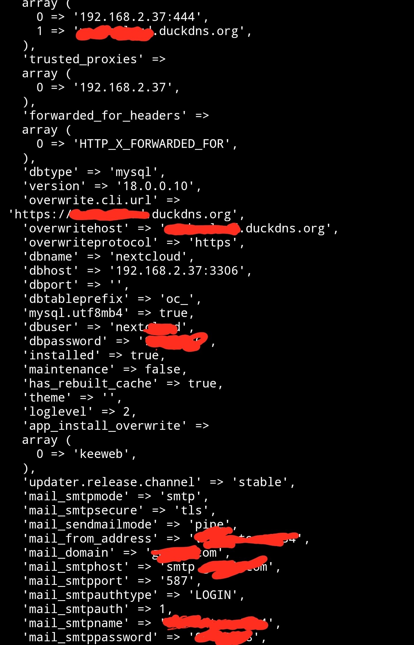

No port for the "unraidIP" part?
What do I exchange for "HTTP_X_FORWARDED_FOR" ?
Thanks
Thanks
I didn't change it and it works for me like it is.
Unraid IP put your Unraid IP.
Edited by Vesko
Sadly it didn't fix it for me. Maybe I made a mistake.
This is what it looks like:

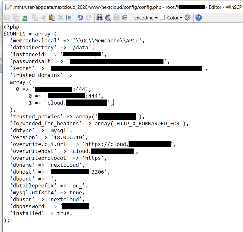

You have two 0 entries in the array.

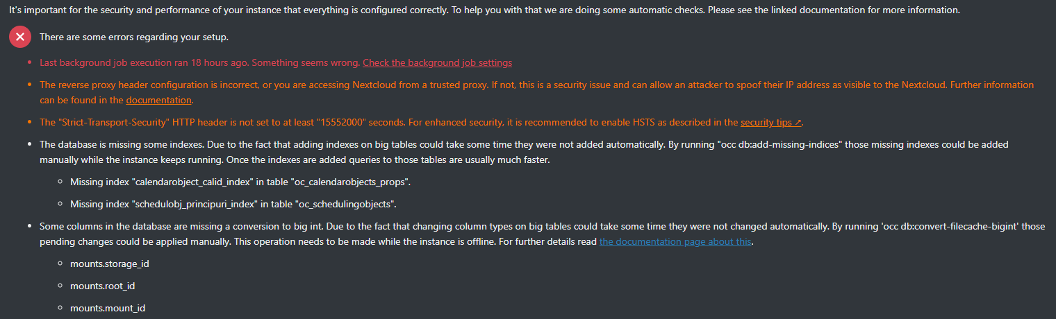

I have my server up and running, but now I am trying to make sure it is running correctly.  Need some detailed help on how to fix some of these and I am just not savy enough to find the answers.  Can someone help?  I am sure it would help someone in the future when they are setting up the server.
UPDATE:  Found the commands to take care of the database errors, but I can not find a fix for the background process's.
Edited by ZosoPage1963
found fix for some of the errors.
