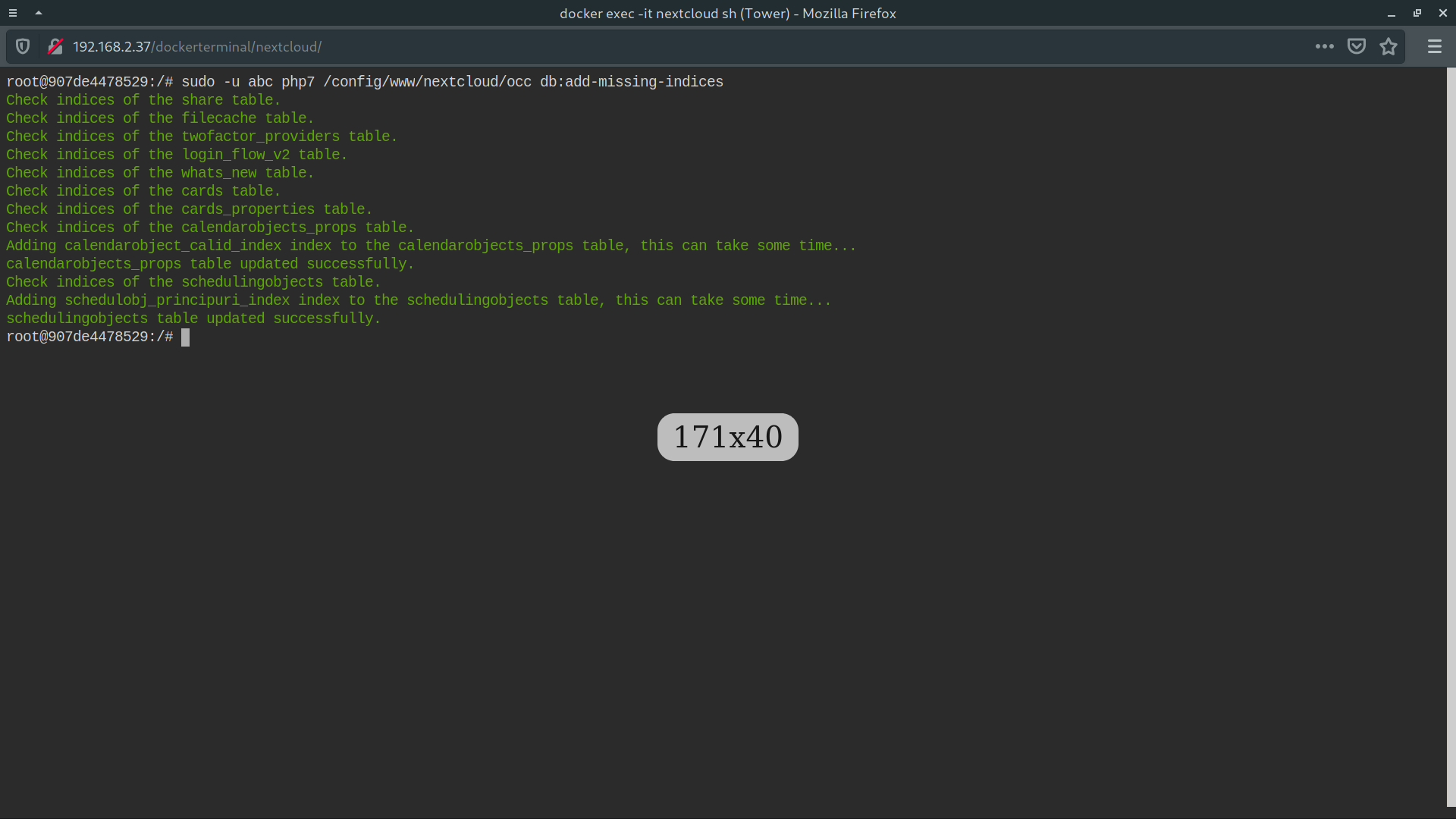

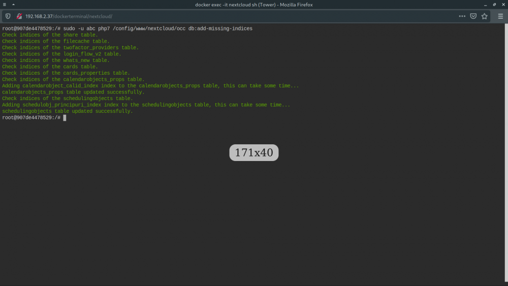

Wondering if someone can help. I just setup a new clean install of MariaDB and NextCloud with LetsEncrypt.
I've got this in the Settings -> Overview tab, I tried to look and ran out of pages to search.
I did manage to find out how to do the BigINT conversion which I did.
There are some warnings regarding your setup.
The reverse proxy header configuration is incorrect, or you are accessing Nextcloud from a trusted proxy. If not, this is a security issue and can allow an attacker to spoof their IP address as visible to the Nextcloud. Further information can be found in the documentation.
The "Strict-Transport-Security" HTTP header is not set to at least "15552000" seconds. For enhanced security, it is recommended to enable HSTS as described in the security tips ↗.
The database is missing some indexes. Due to the fact that adding indexes on big tables could take some time they were not added automatically. By running "occ db:add-missing-indices" those missing indexes could be added manually while the instance keeps running. Once the indexes are added queries to those tables are usually much faster.
Missing index "calendarobject_calid_index" in table "oc_calendarobjects_props".
Missing index "schedulobj_principuri_index" in table "oc_schedulingobjects".
Sorry to be a noob but can someone walk me through how to fix the above?

I had issues with the same was able to eventually figure it out. You need to console into the Nextcloud docker and run the below command, changing the end of it which perhaps you already did to get the BigINT conversion done. So "db:add-missing-indices" after the "occ" instead of what I have here. For the HSTS, add the line "add_header Strict-Transport-Security "max-age=15768000; includeSubDomains; preload;";" in the "default" file in the "\nextcloud\nginx\site-confs" folder. I put it above the line that has "SAMEORIGIN" in it, not all that far from the top of the file.

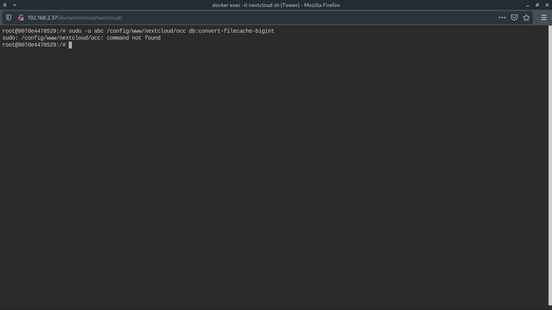

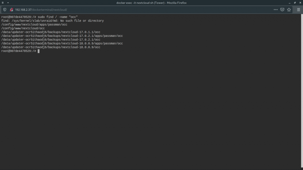

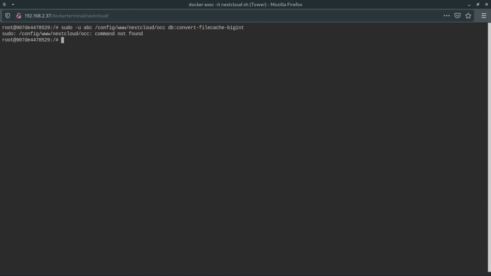

When i try this i get error
sudo: /config/www/nextcloud/occ: command not found
i dont know what is wrong.
Edited by Vesko
How exactly did you type it?

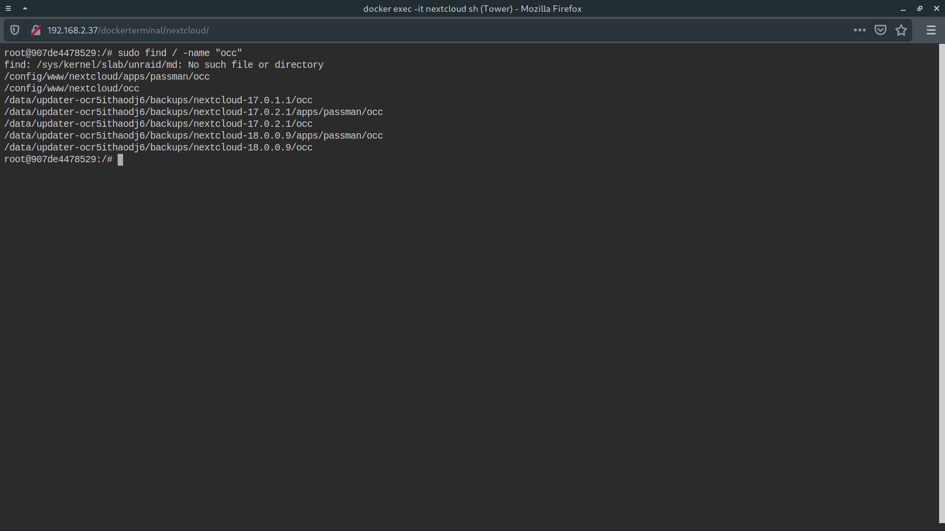

"php7" missing in the command.
sudo -u abc php7 /config/www/nextcloud/occ db:convert-filecache-bigint
Edited by Niklas
sudo -u abc php7 /config/www/nextcloud/occ.......
Great !!!
Thank you now works.
Missing Php7 in the command.

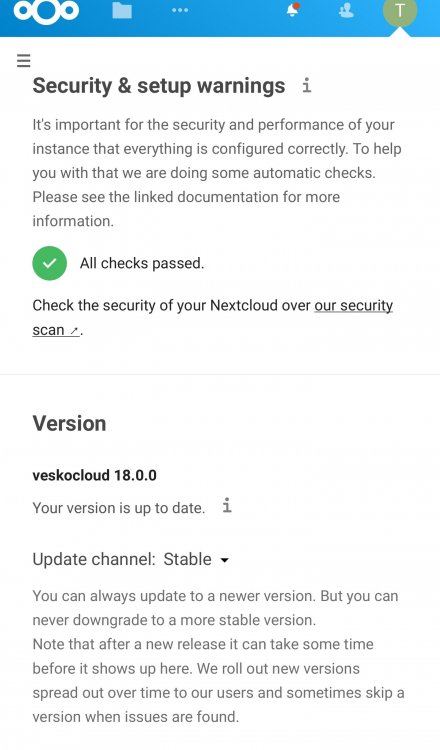

Now i have to fix only this:
Edited by Vesko
Today we learned something new . Thanks to Iceman24.
The "Strict-Transport-Security" HTTP header is not set to at least "15552000" seconds. For enhanced security, it is recommended to enable HSTS as described in the security tips [emoji658]

13 minutes ago, Iceman24 said:
I'm not in a position to do anything other than say check my post about 10 back with how to fix this. Have to add line in "default" to file.
Yes !!!
Fixed .
Thank you very much Iceman24 .
Now only this stays but maybe is normal.
Yes !!!
Fixed .

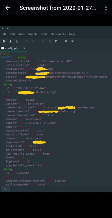

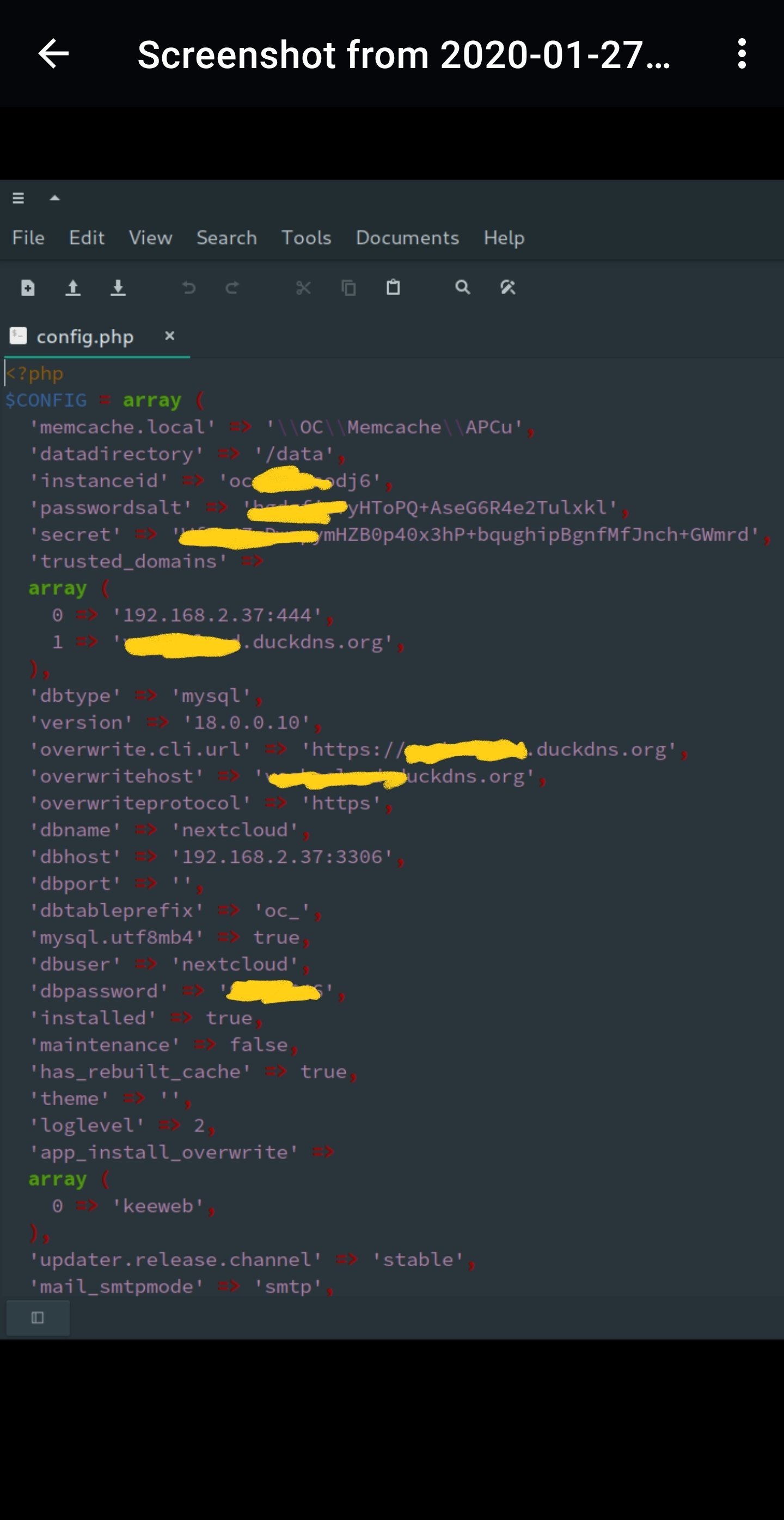

You're welcome. Make sure this area of your config.php looks like this.
'trusted_domains' =>
array (
0 => 'unRAIDIP:NextcloudPort',
1 => 'nextcloud.server.com',
'trusted_proxies' => array('unRAIDIP'),
'forwarded_for_headers' => array('HTTP_X_FORWARDED_FOR'),
'dbtype' => 'mysql',
'version' => '18.0.0.10',
'overwrite.cli.url' => 'https://nextcloud.server.com',
'overwritehost' => 'nextcloud.server.com',
'overwriteprotocol' => 'https',
array (

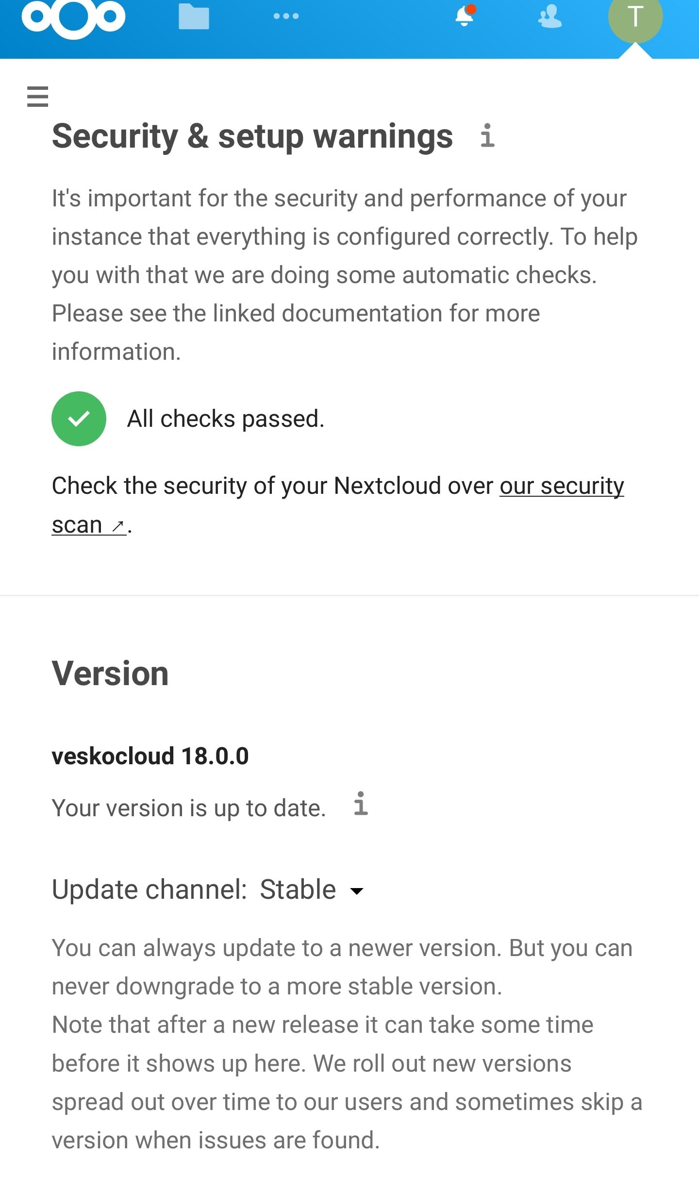

Mine look like this I installed from Spaceinvader
tutorial in YouTube.
Edit:I edit it how you say and now everything is good.
